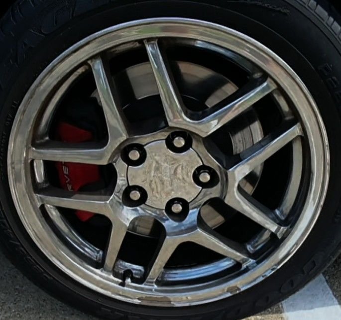

Were all the Z06 chrome wheels dealer add-ons or did some come from the factory? I'm looking at a garage kept C5Z w/30k miles and the chrome wheels are peeling. Also the center caps are plain and do not have the Corvette flags. The owner says it's all original.
i dislike the chrome and am wondering if new OEM Z06 wheels and center caps are still sold? Or is there a paint code that matches the OEM finish?

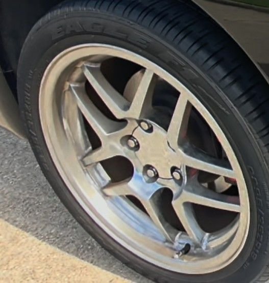

Wheels in question

The top two photos are very reminiscent of my reproduction wheels (long gone). To my knowledge, the only wat to ascertain for certain is to inspect the reverse of the wheel for markings of "GM" and appropriate part numbers. On Speedline wheels (factory polished, and possibly chromed by a dealer) the numbers and markings are on the spokes, near the rim, and could be found with an inspection mirror -- I am not certain of markings on painted wheels.

As mentioned several times above, no C5 Z06 left the factory with chrome wheels. The 04 Commemorative were polished and looked similar to chrome, but center caps had the logo. These appear almost certainly an aftermarket reproduction. Although not impossible to have a set of oe speedline or alcoa's stipped and chromed, the cost would have exceeded that of aftermarket options and I would venture to bet this was only done on a very select number of original rims. I would bet nearly everything I have on these being aftermarket. From what I understand the aftermarket wheels are significantly heavier than the OE Z wheels and often are in the base C5 wheel dimensions. I would kick these wheels to the curb and replace with a set of oe Z wheels in the proper grey if I were you. The grey just fits the "ethos" of the Z06 far better anyway.
I do believe some dealers were swapping aftermarket chrome wheels after delivery back when the cars were new and likely never giving the first buyers the originals. This is not an uncommon practice at dealers still today.

I really hope these are OEMs but you guys are probably right that the dealer swapped them. I hope to inspect it this weekend and will look for the OEM wheel stamps.
