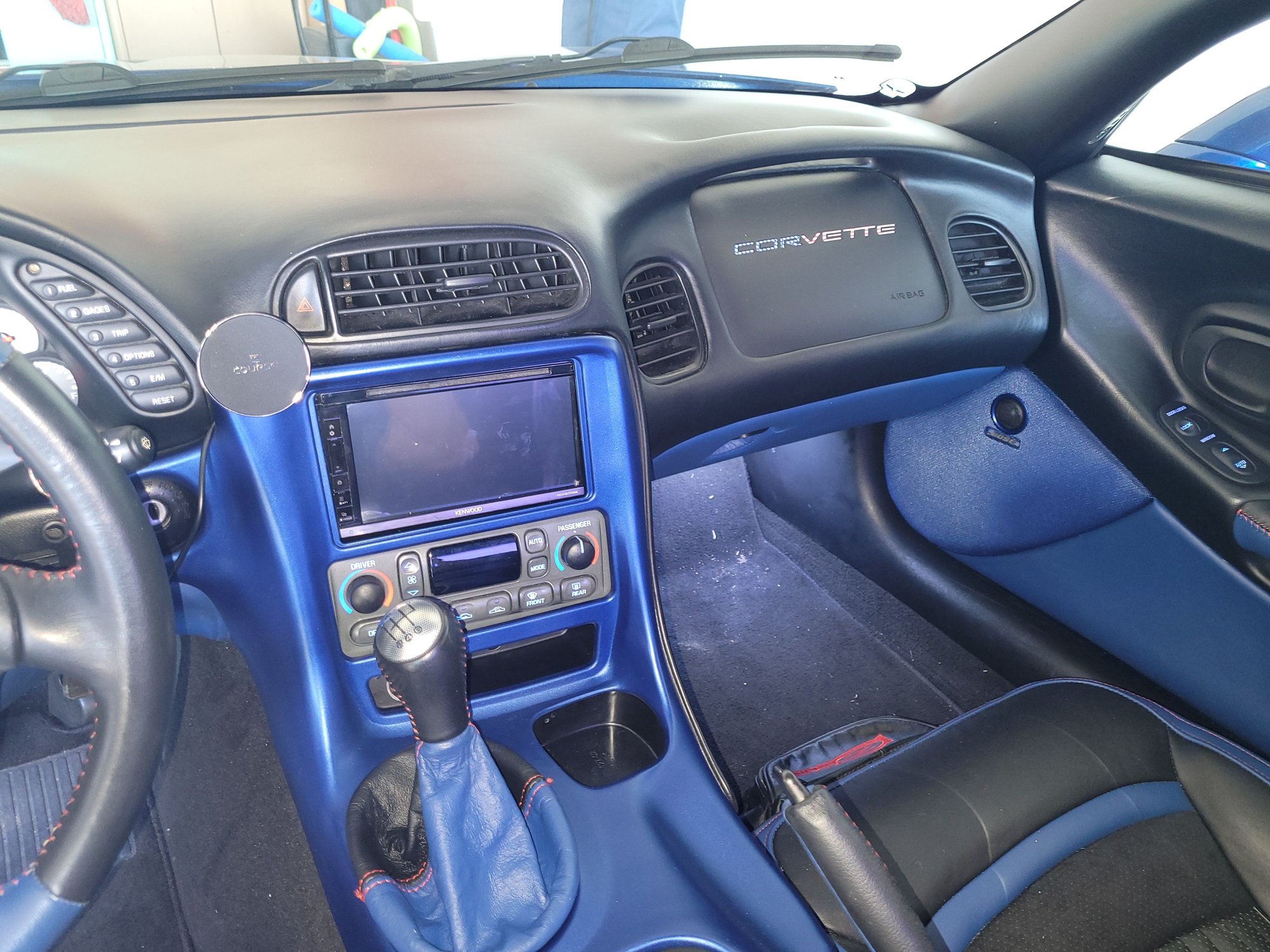

playing around with a spare bezel i had. I have mixed opinions on it, facebook crowd is pretty mixed too. But i think ill leave it for a while and see how it ages. The flash is doing funny things with the colors, but you get the idea.

I like it. Looks like it goes well with your interior. I'm curious what you used for paint and how it was prepped. I've considered doing this in gloss black for my car.

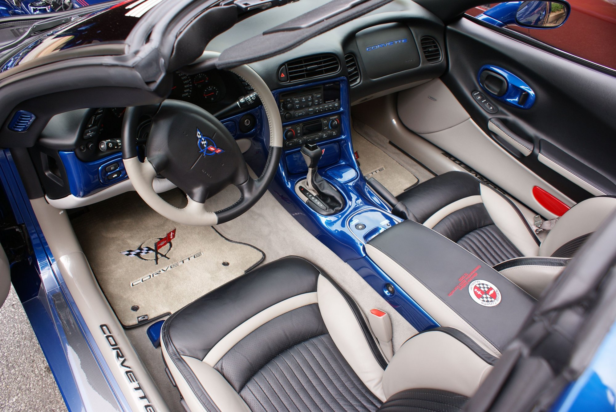

Looks good. I did the same with my 2003 C5 only in a gloss finish.
I used automotivetouchup.com just buy a can in the correct paint code. For prep I just cleaned it good and then used a coat of adhesion promoter followed by a light coat of hammer paint for texture. Let that dry about a week and then applied the color coat.
