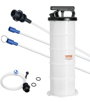

Saw a video on YouTube of someone sucking engine oil out of dipstick tube into oil extractor, then more videos popped up.
Several videos the person will then remove the drain plug to measure how much more oil drains out, one car they got 1/2 cup.
Other cars nothing came out.
Curious if anyone here has ever tried one of these on C5 or any LS style engine?
https://www.amazon.com/VEVOR-Extractor-Changer-Automotive-Dipstick/dp/B0CMTXHRLG/ref=asc_df_B0CMTXHRLG?mcid=8df90398dd6d3916b80f2ac3dfb12fed&hvocijid=9369153284434159036-B0CMTXHRLG-&hvexpln=73&tag=hyprod-20&linkCode=df0&hvadid=721245378154&hvpos=&hvnetw=g&hvrand=9369153284434159036&hvpone=&hvptwo=&hvqmt=&hvdev=m&hvdvcmdl=&hvlocint=&hvlocphy=9030048&hvtargid=pla-2281435179018&psc=1 https://www.amazon.com/VEVOR-Extractor-Changer-Automotive-Dipstick/dp/B0CMTXHRLG/ref=asc_df_B0CMTXHRLG?mcid=8df90398dd6d3916b80f2ac3dfb12fed&hvocijid=9369153284434159036-B0CMTXHRLG-&hvexpln=73&tag=hyprod-20&linkCode=df0&hvadid=721245378154&hvpos=&hvnetw=g&hvrand=9369153284434159036&hvpone=&hvptwo=&hvqmt=&hvdev=m&hvdvcmdl=&hvlocint=&hvlocphy=9030048&hvtargid=pla-2281435179018&psc=1

So I have a similar style for working on VW Group stuff and things with metal plates underneath that suck to remove.
Just for s**ts and giggles I tried it on my C5 and there was still a good bit of oil in the lower pan, I believe due to how the batwing pan is designed makes it A LOT more difficult. I drained my oil from there and got over a cup easily and pulled my lower oil pan off to replace the gasket and install the Improved Racing Baffles.
I wouldn't recomend it on a C5 but on a C6 Wet Sump it could be helpful or a non-Batwing pan.

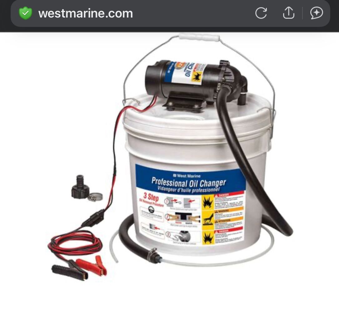

I would not hesitate to use a pump out system, but wouldn’t use that pump. There are marine versions because draining their oil (into the bilge, for example) is not practical, nor fun. This is how it’s done in marine systems almost universally, and on engines costing many times that of an LS.
These pump systems come in all sizes, but for my ski boat (496 ci BBC) I bought one that came as a five gallon plastic bucket with a powerful 12v pump attached to the lid. This pump has jumper style clamps that attach to your battery. It has a long plastic hose that is just small enough to fit down a dipstick tube.
I would warm up the engine first so the oil would flow considerably faster through the tube. It worked great. Then, I would slide a one gallon zip lock baggy over the oil filter and unscrew the filter, catching all the oil in the baggie. Zip it up and no mess.
Now both oil and filter can easily be transported for responsible disposal without the hassle of pouring the used oil back into the quart oil bottles. Then the pump/bucket goes back in the garage attack until next time. No cleanup needed 👍

I was under the impression oil extractors wouldn't work on a C5 due to oil pan baffles.
I borrowed a co-workers Mitivac to adjust the oil level when the dealer overfilled my oil and I couldn't get the tubes down the dipstick hole far enough to get anything out.
I now own the Vevor in the OP which I used to drain remove about a half quart of oil in my STi after it was accidentally overfilled and it worked like a charm. I doubt I'd use it for a full oil extraction, but for level adjustments, it definitely has a useful purpose.
