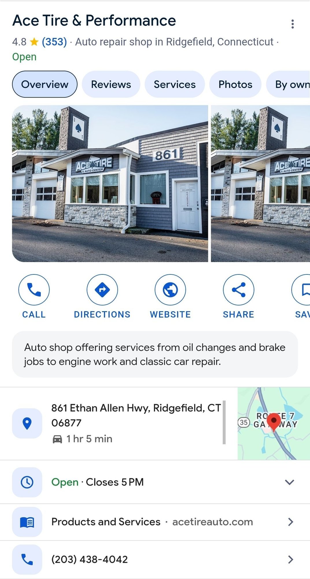

Down that way the absolute best option for experience, rather... Expertise.... as well as GM enthusiasm despite having worked on every exotic known to man from 1920s forward and probably a very good chance at having influence Glickenhaus into using an LT4 with twin turbos in the street production Glickenhaus car..... Is Tom Falconeri of Ace Performance in Ridgefield. I once trusted him and his dad to do valve springs for me when I couldn't. I don't trust people to work on my cars mind you. I had no reservations. Absolutely reach out to Tom. He is knowm equally well for his paint and body work too.

Is that Ace Tire ? I had them align my '62. I'll check them out.

Yup.

I went to Ace Tire/Performance today and set an appointment date. Kind of agreed that would only do the Clutch Master Cylinder. If that doesn't work at least the car is there to do any additional work if needed. I bought it new and only drive it a little over 2k a year and it is all long highway driving so I can't see any excess wear on clutch or TO bearing. I'll post the results when the car is done.
