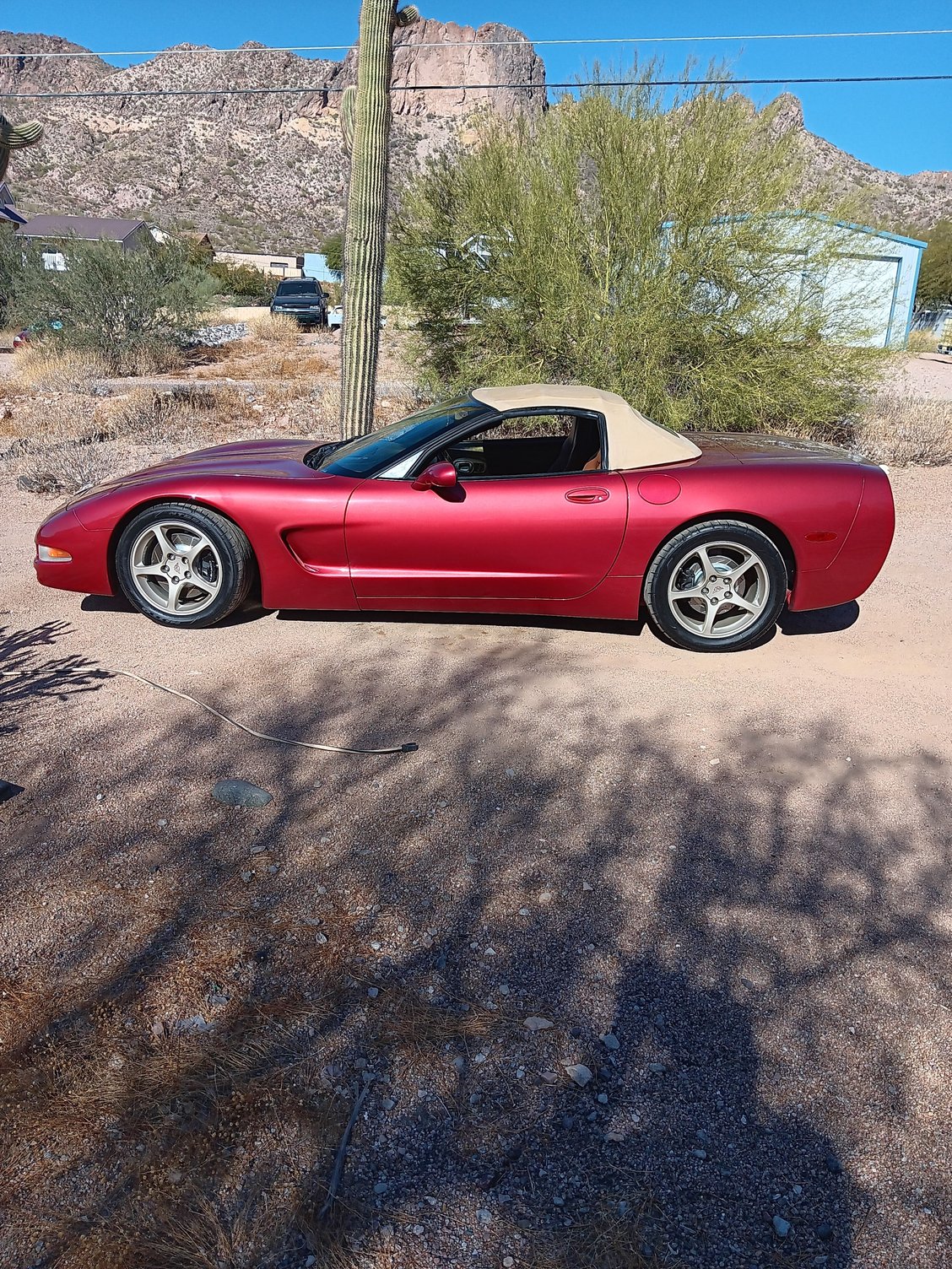

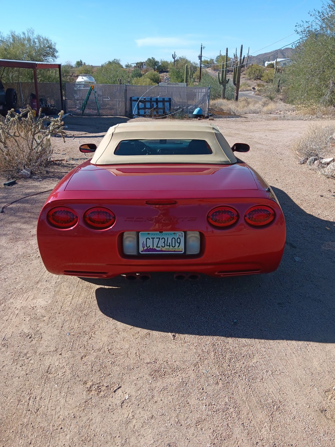

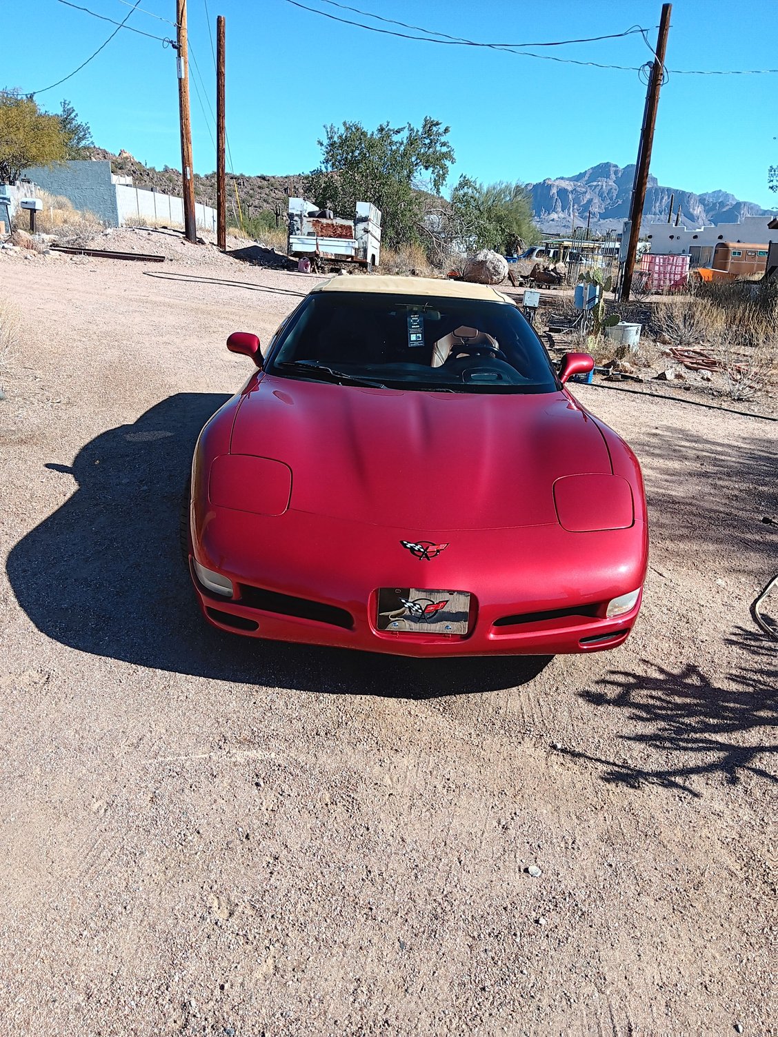

Hi All

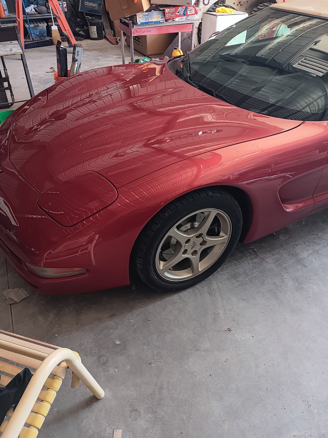

it has been a while since I have posted here. Have been busy working on my 2000. It is not done yet but I think looking good.
I am currently building a LS416 for it.aming for around 500 HP here are some pics of the car.
Thanks for looking.

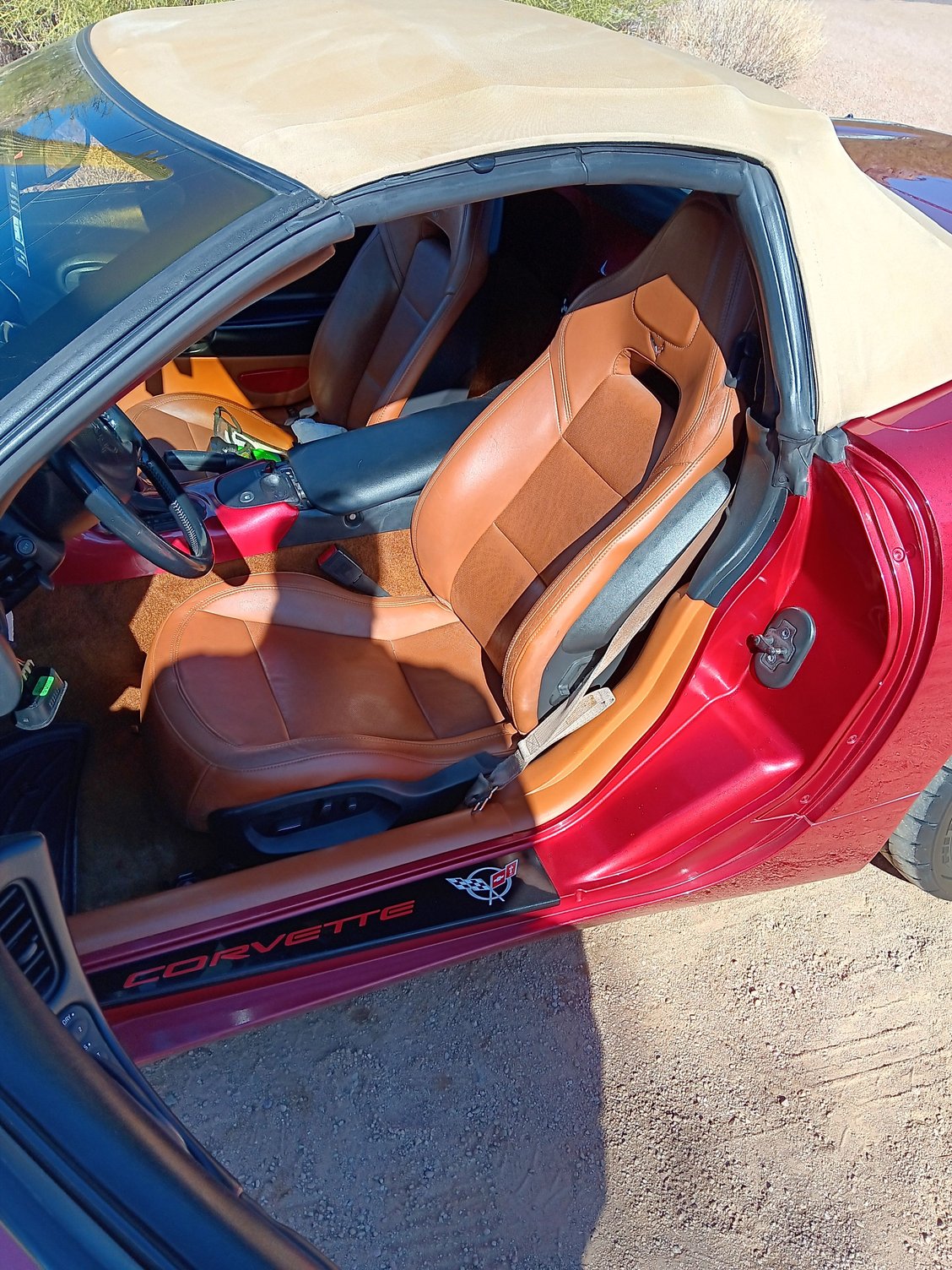

The C7 Kalahari seats look great in there. Did you use dye to change the other interior items to the same color?

thanks for the reply. Yes the interior pieces have been dyed. The seats are C7 and stock color

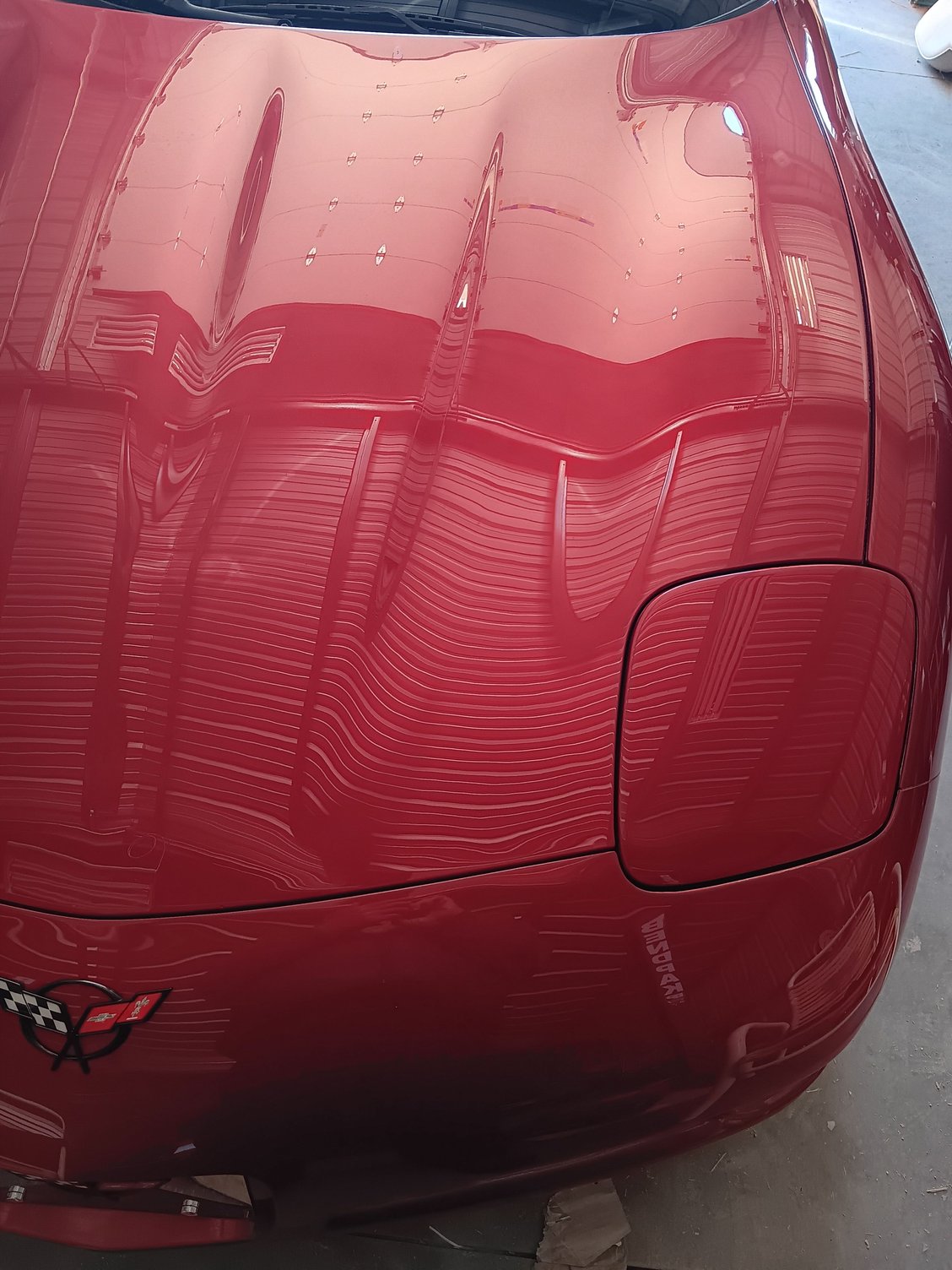

Nice. And the pics sealed a decision for me, I must take the BSM's off my 2000 of the same color. Looks so much better without them.

Yes the interior has been died. Seats are stock color out of a C7

I think so also. Still have a little work left on the innterior. Pics don't show the quality of the paint and the metal flake

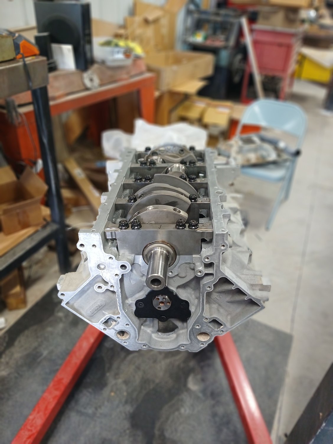

After a long delay the 416 build has started
All parts are moving very well. All clearances are set and checked and rechecked. Next week should see the short block finished.
will keep you posted
Thanks
