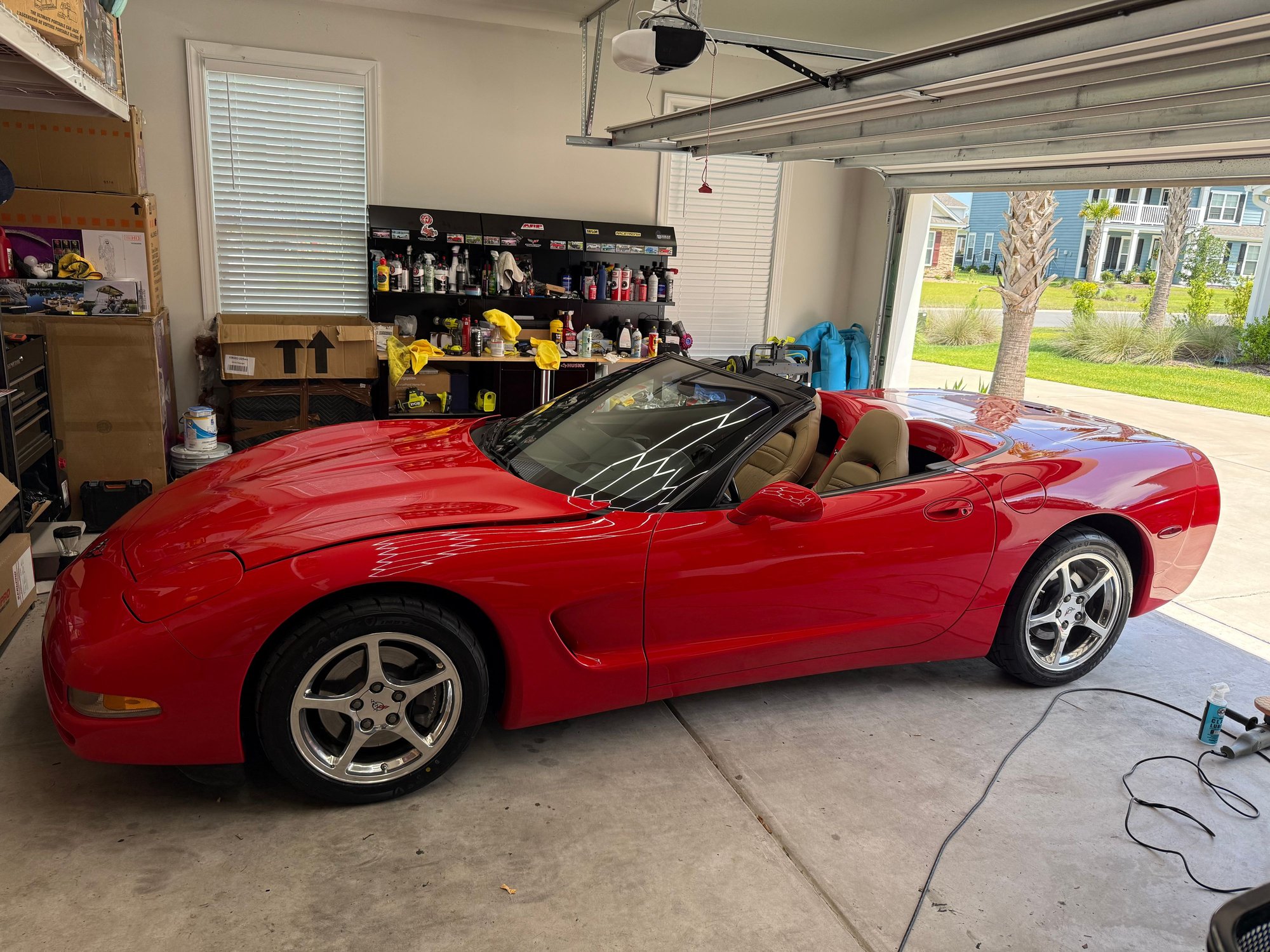

Default Love my y2k

As said above, number one is all fluids. Make sure you are using the correct transmission fluid for a manual, you need non-synthetic for a 2000 or you will ruin the blocker rings and have a huge bill, but the fluid does need to be changed. I bought a 2000 with 40k on in a few months ago and did the water pump, coolant, therm and all belts and tensioners. I would suggest you do the same if you want it to be reliable, mileage at this point doesn't matter as it's 25 years old and its time. I also changed plugs and wires, maybe overkill but again these cars are ready time wise. 100% you need a new fuel filter as well! Most of this is really easy to do if you are handy and have some experience working on cars. Contrary to what others have said you can do this yourself, I think this platform is easy to work on. If you don't have a lift you can use a garage or local mechanic to do the fluids as you will need to lift the car. Buy some throttle body cleaner and spray out the throttle body and mass air cleaner and remove and spray as well. YouTube has tons of how to videos to walk you through all of this maintenance stuff. Don;t get cheap and use acdelco or gm genuine parts, lots of luck with yours! Pic for fun!
