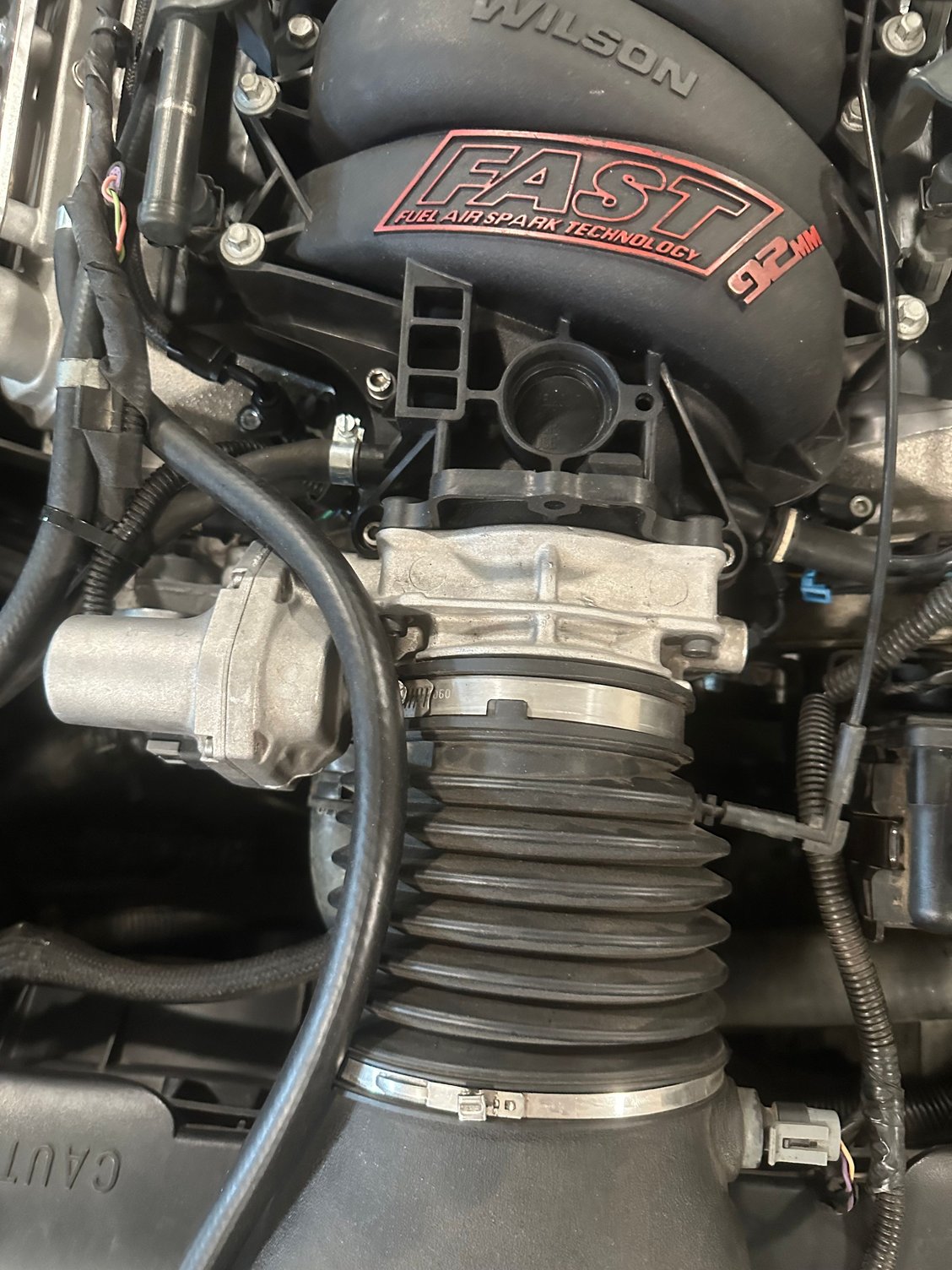

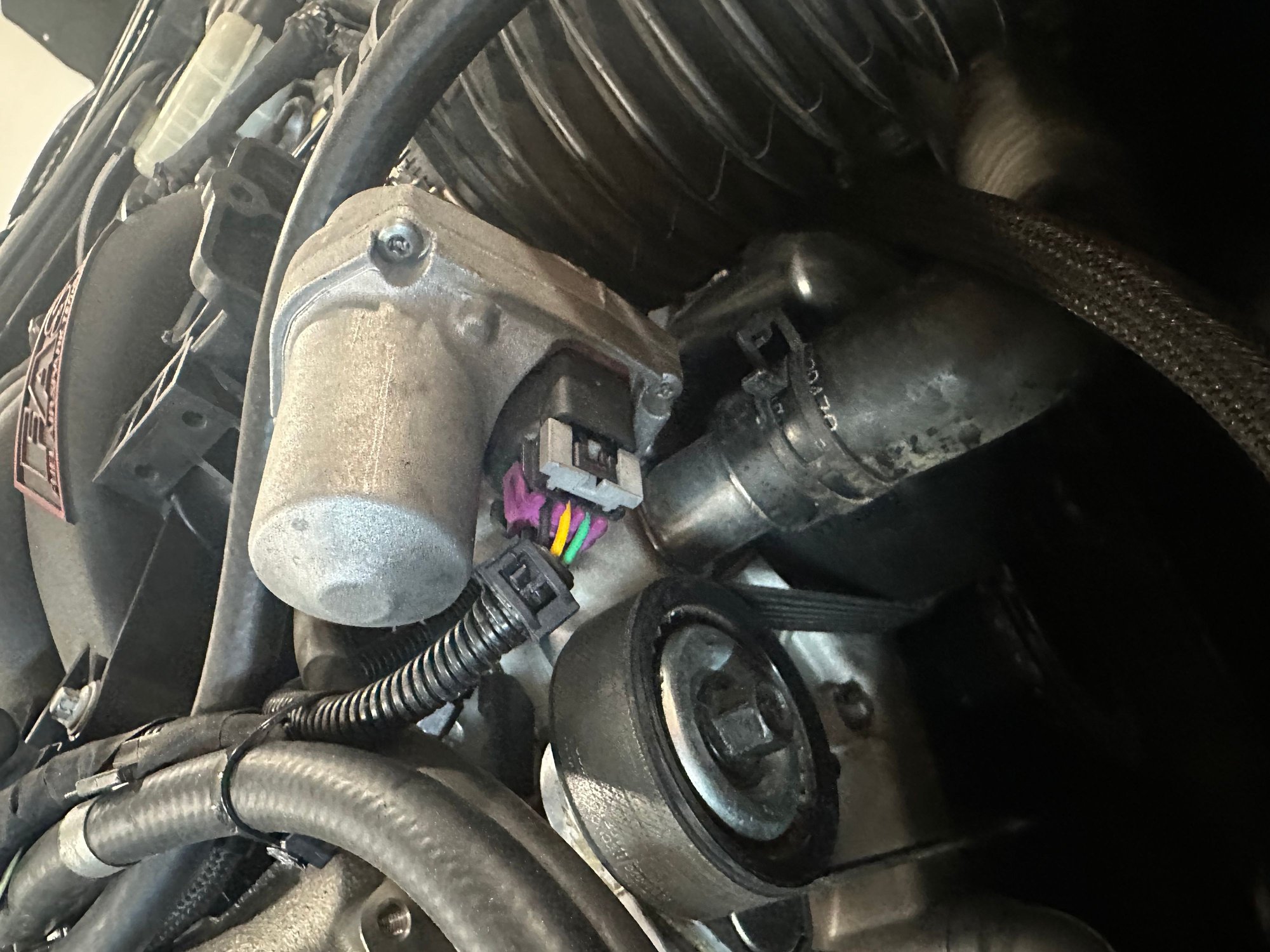

Hey everyone. I recently installed a topend kit, and fast 92 intake along with an ls2 tb with an adapter. Tomorrow is supposed to be dyno tune day but I just had the dreaded p1120 and p1220 codes come up. The adapter and tb are of unknown origins as they came with the slightly used fast intake I bought. Car starts and runs. Any insight on where to start first?

Find a shop that knows how to diagnose TPS sensors…these LS1 to LS2 mods always have issues with these 2 DTC’s.

It's quarter to 4am so forgive me for not looking up the codes. I'm going to just guess that the TB signal voltage is out of range right?
The tuner will adapt for that. I forget the specifics but I think it is along the lines of having to set the LS2 where 100% signal command equals 97% butterfly movement. But that is an ooooooold memory. It's entirely doable.

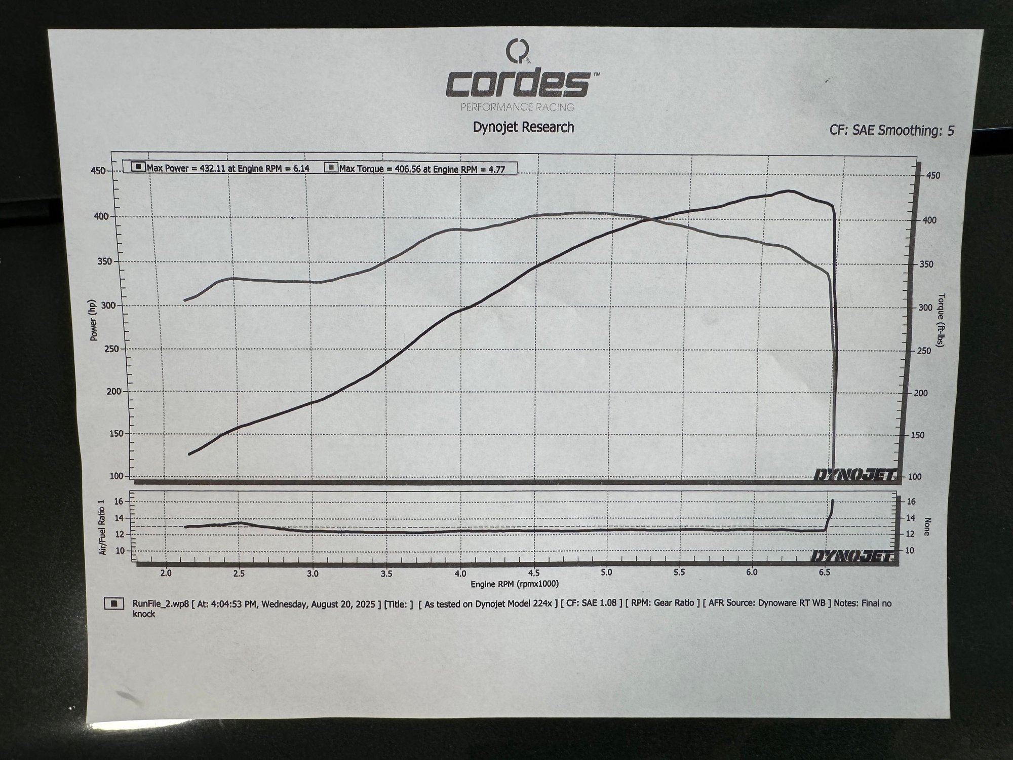

It ended up being a bent prong on the flat connector of the adapter. Tune went well. Runs great.

Glad it was a fairly simple fix. Those are some very nice numbers, what is your list of mods?
Thanks. Should be good for her.
Trick flow 515hp topend kit
Headers with x pipe and cat delete
Fast 92 intake LS2 tb
borla mufflers
slp cold air
3.90 rear gears
