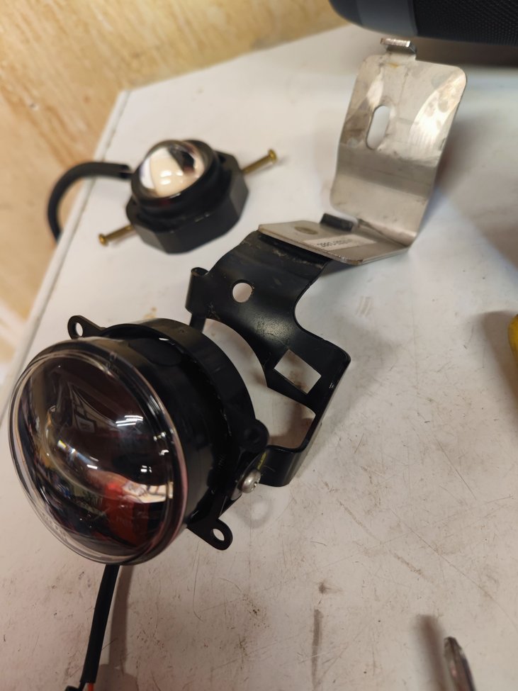

Did you use the Sharp Light Innovations brackets or factory OEM? Also did you modify it to fit with the Tigershark front end?
Old Aug 28, 2025 | 12:57 AM
jdmvette's Avatar
jdmvette
Night Owl for life
Joined: Nov 2003
Posts: 24,725
Likes: 4,564
what you see in the above pic is the black factory bracket bent/modified to fit fog lights to the tigershark front end.
the black OEM bracket is bent and bolted to mount with the silver bracket which is provided by TS. the silver bracket came with my TS front end kit (kit was ordered with fog lights)
i don't know if you can buy the silver brackets from the TS manufacturer seperately.
also, i believe sharplight brackets are the same as OEM C5. you need both black and silver brackets to have fog lights on a TS front end.

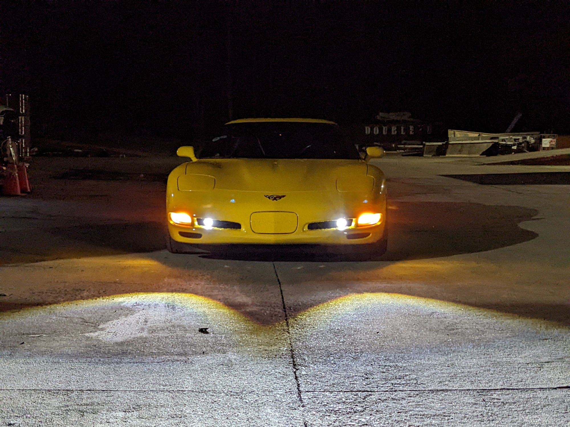

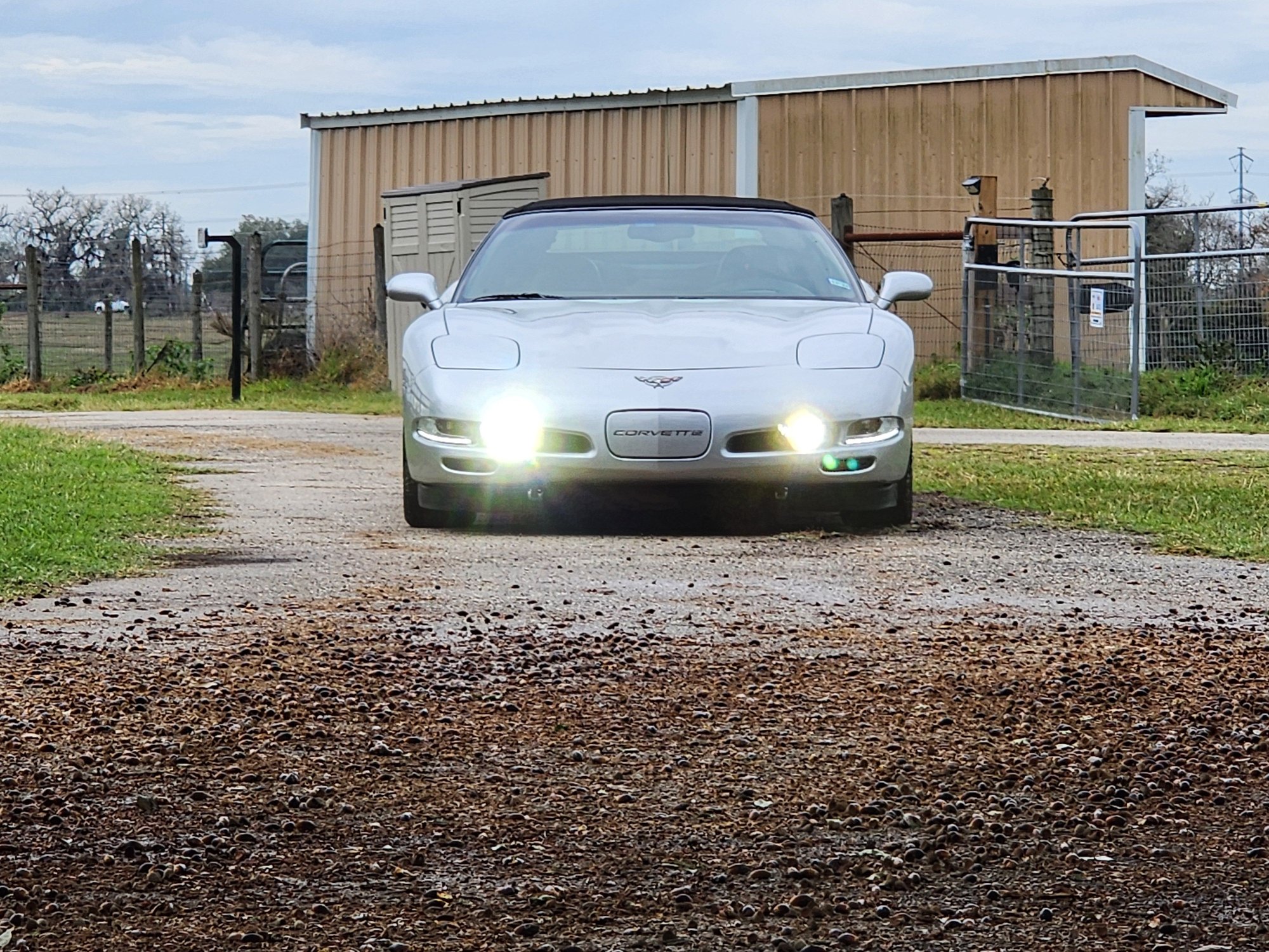

We offer 3 options:
1. Morimoto LED fog lights - LED powered crisp white fog lights that fit the C5 opening. Great pattern and easy to install.
2. Dedicated LED DRL lights - If you really don't NEED fog lights, these are a great option to add visibility to your low-profile car clearly visible during the daytime. Fully automatic and integrates with your turn signals.
3. Dual-Function LED - Cant decide between fog or dedicated DRL? Have both. Yellow fog pattern and white sport DRL pattern
DRL function
DRL function
Fog function
Fog function
Fog output/pattern
Fog output/pattern
