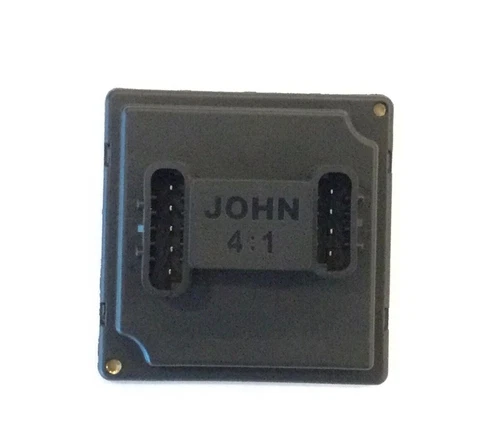

That happened to me a few years ago, I ended up getting a headlight module on Ebay and everything worked fine for the last few years1989 Corvette Headlight Lamp Actuator Control Relay Module  BRAND NEW C4
