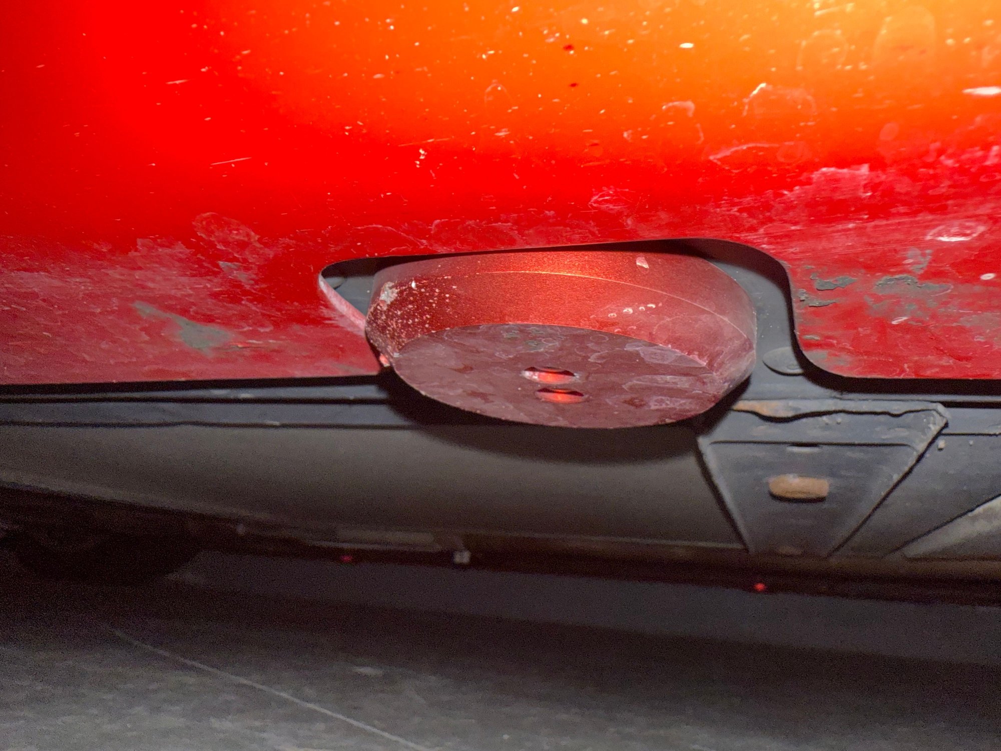

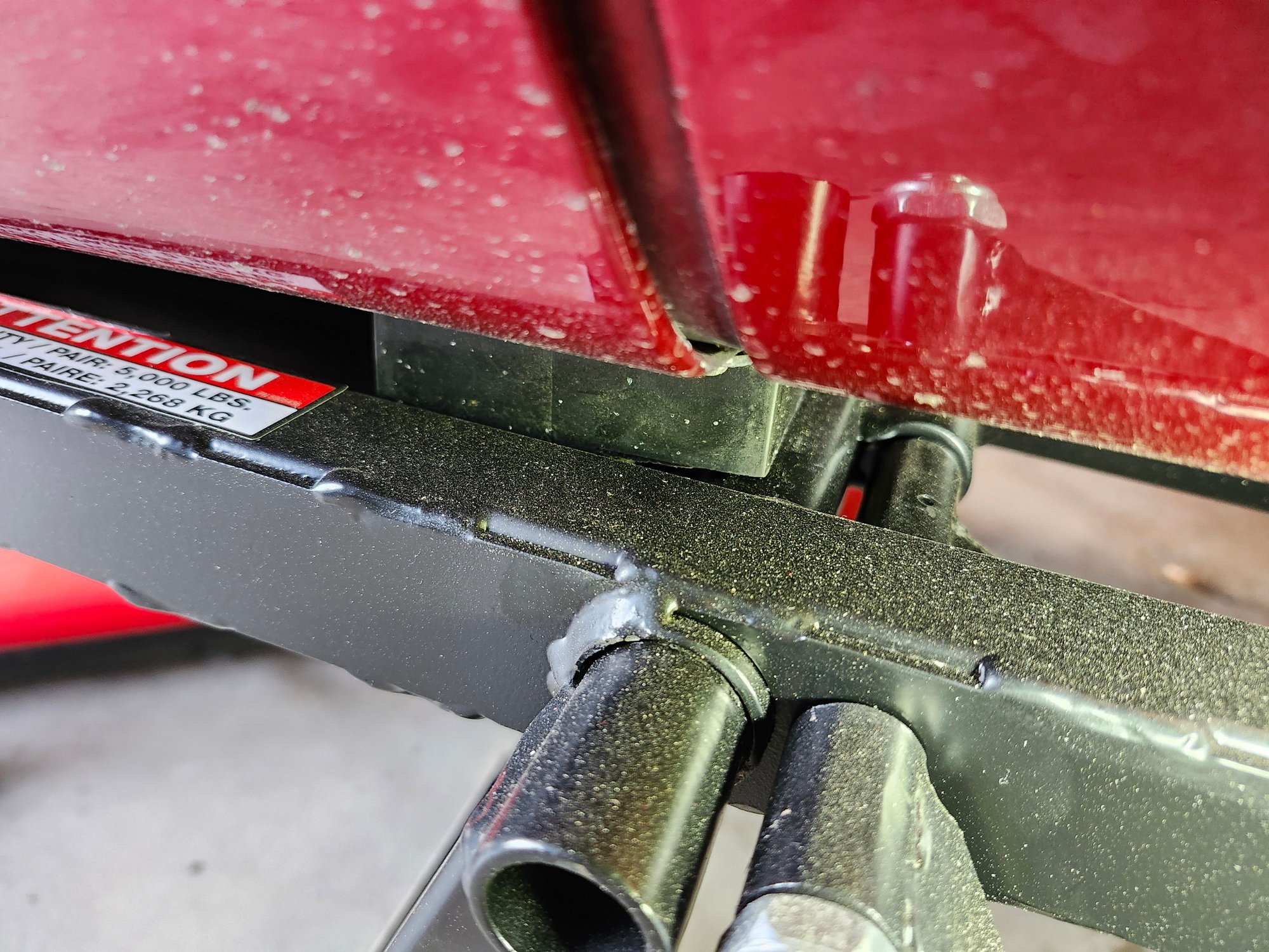

I only get 3/4 of each jacking puck with my 5000 TL (Purchased this year).

I have like 14 inches of usable tray for the pucks at the front and about 10 inches of tray for the puck at the rear.

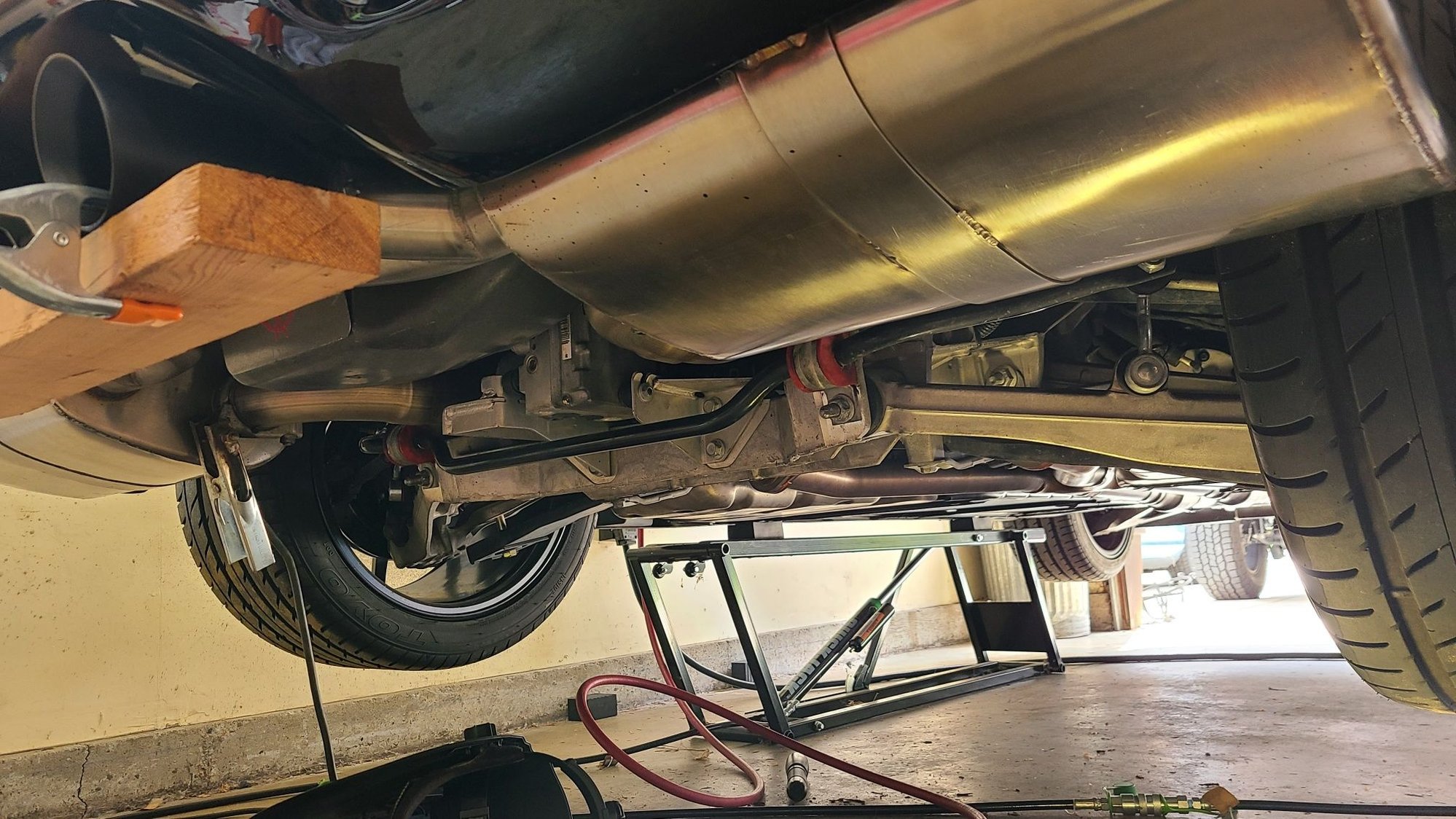

Same with mine I purchased 2 years ago. It was fine but took a lot of finessing to get it as good as possible. I made a set of drop in runners out of 2x6's and used some derlin to make "keepers" that won't let the board move side to side and stay in the pockets. Now I get total puck coverage on the vette and when I use it on the truck, it makes lots of frame contact and is rock solid. Cost about 20 bucks-

That’s a great idea. I used my QJ 5000TL on my C7 for an oil change for the first time last week and noticed I couldn’t quite get the car pucks and QJ lifting blocks perfectly centered. They were off by approximately 1/2”. Still worked fine but took a lot of careful placement. Would be nice to have an extra couple of inches of spread to work with. Think I’ll give your idea a try.

Thanks. I just ordered a set as well to use with my 5000TL. Using it for my C7 which have lifting points just a bit closer than I could adjust the blocks on the QJ for. They were doable, but needed about another 3/4 to 1” of adjustment to get the pucks when attached to the car to fully center up on the QJ lifting blocks.

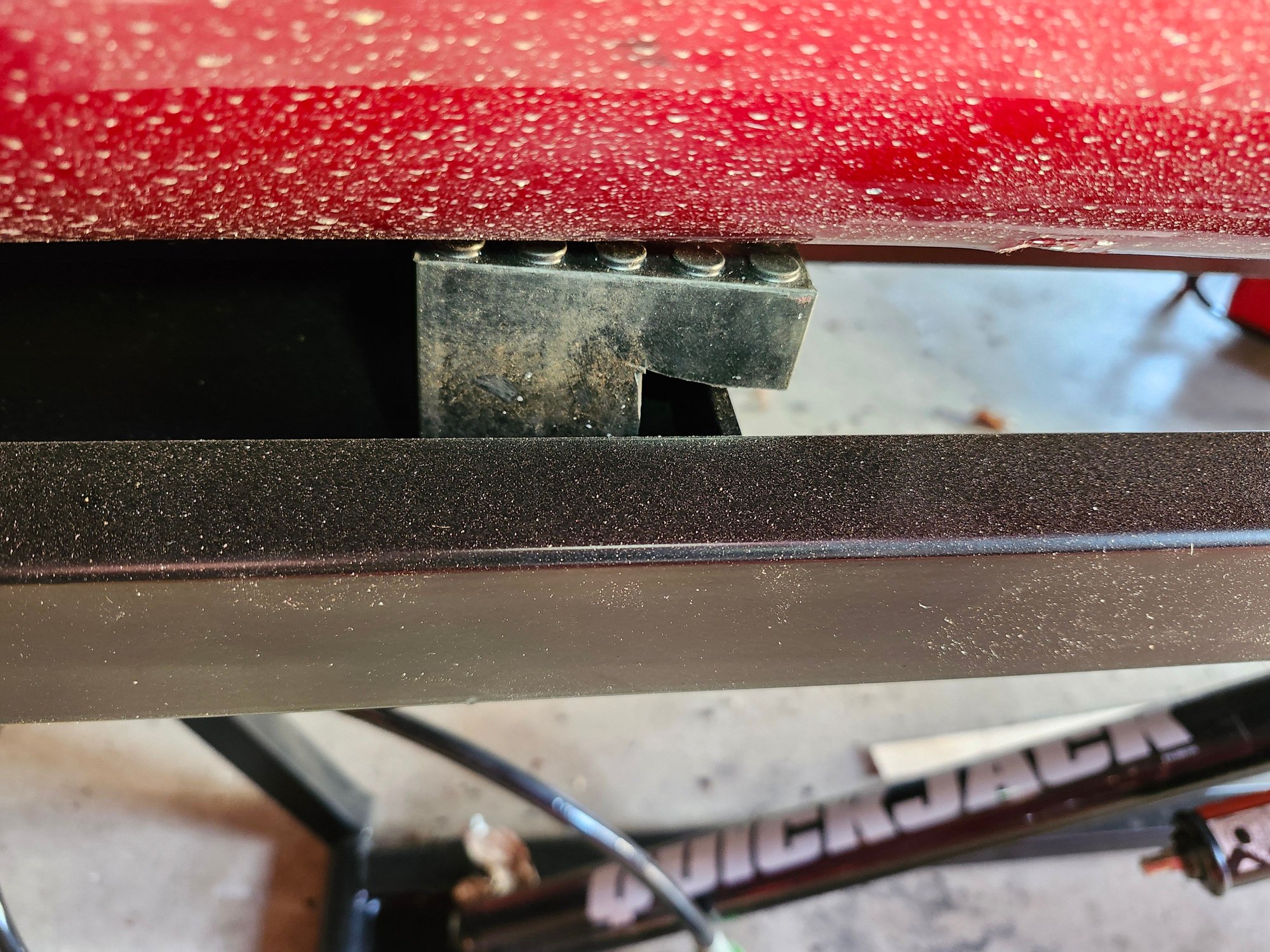

I did this with some rubber lift blocks. Looks janky but works great. Trimmed a corner off to go over the round bar.
