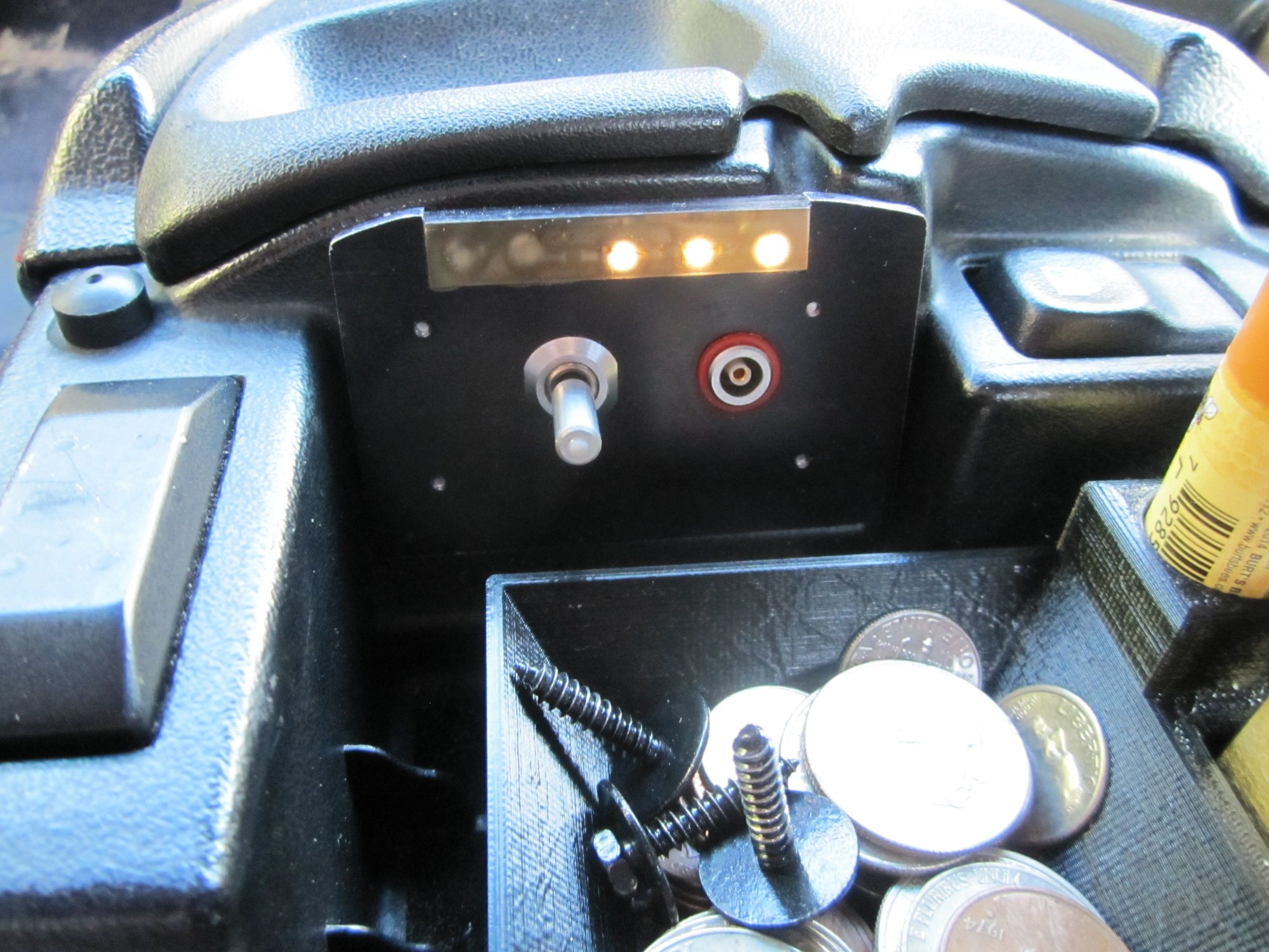

Unless you need to use a cigar lighter or a plug-in that fits, that connector is overkill and uses up valuable real estate. Here's an example of more in the same space:
A Lemo connector provides a 12 volt power source, a lit toggle switch controls an external circuit and an led/ reed switch lights up the console when the lid is open.
