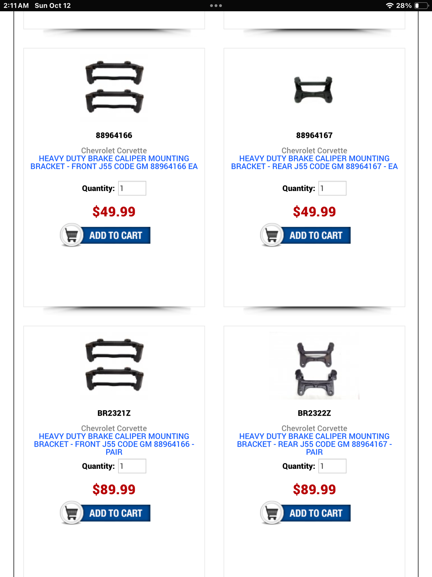

GM does not make the brackets any longer, but they are available aftermarket. You can use stock C5 calipers or C6 calipers. If you want to go all out C6 Z51, the rear calipers are unique, having a 42.5mm piston. I’ve been told that the stock C5 rear calipers are an acceptable substitute.
Info on the calipers…
These guys sell the brackets you would need:
https://www.thepartsplaceinc.com/par...brake-calipers

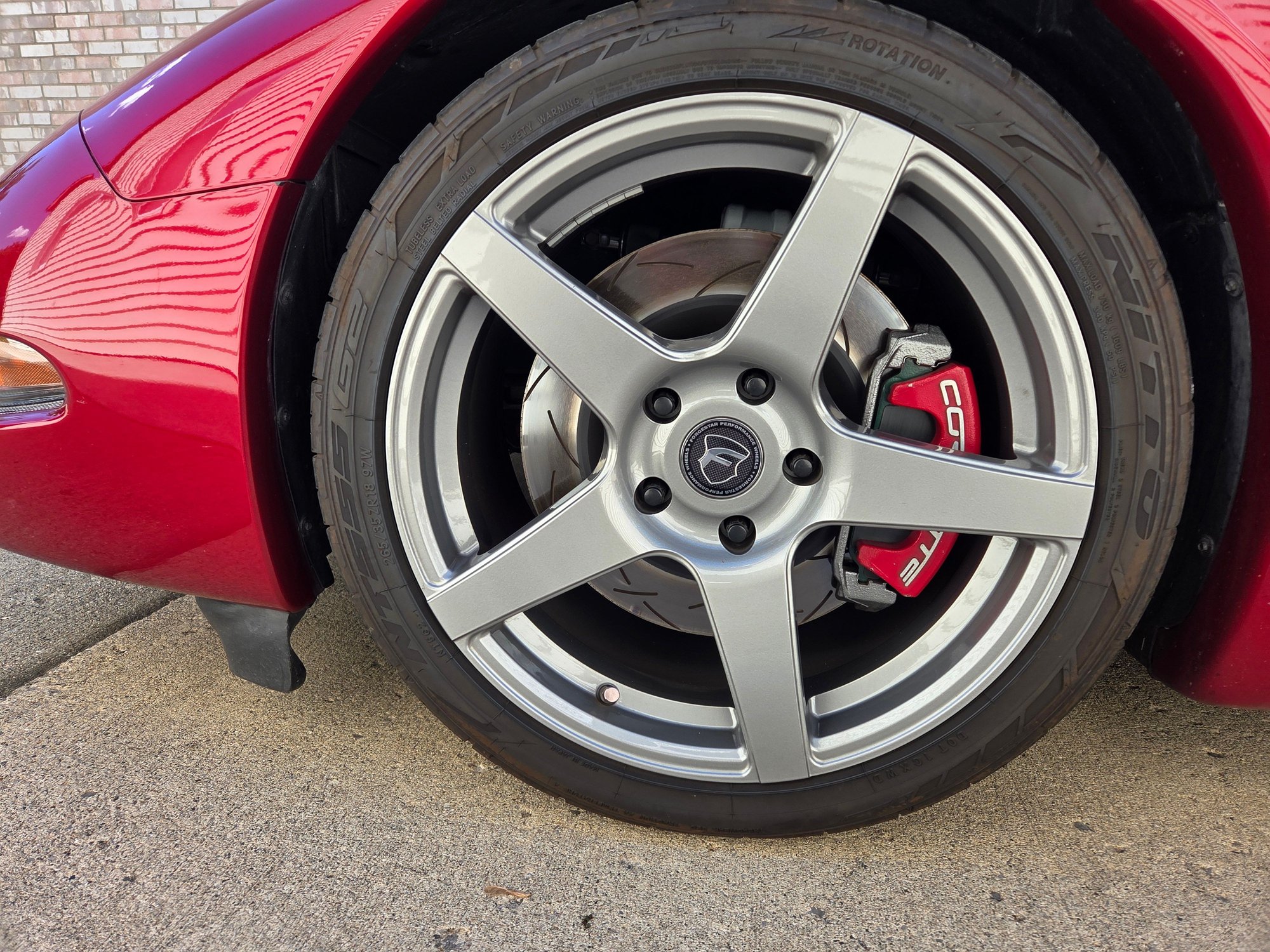

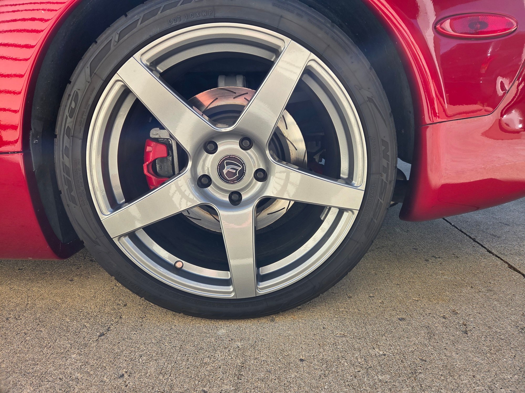

Here are some notes from when I installed the C6 Z51 front brakes on my '99 FRC. I went with the DBA 5000 2-pcs rotors to help offset some of the weight gain that came with a larger diameter rotor along and the beefier / slightly less prone to spreading C6 2-piston calipers with DRM stainless steel pistons.
Centric front #125.62060 C5/C6 base 12.8" [325mm] 1-ps rotor weighs at 19.2 lbs
Centric front #125.62086 C6 Z51 13.4" [340mm] 1-ps rotor weighs at 22.5 lbs
DBA front #52990BLKS C6 Z51 13.4" [340mm] 2-pcs rotor weighs in at 20.5 lbs
C5 front caliper with mounting bracket weigh in at 8.3 lbs
C6 base front caliper with mounting bracket weigh in at 8.8 lbs
C6 base front caliper with Z51 mounting bracket weigh in at 9.0 lbs
