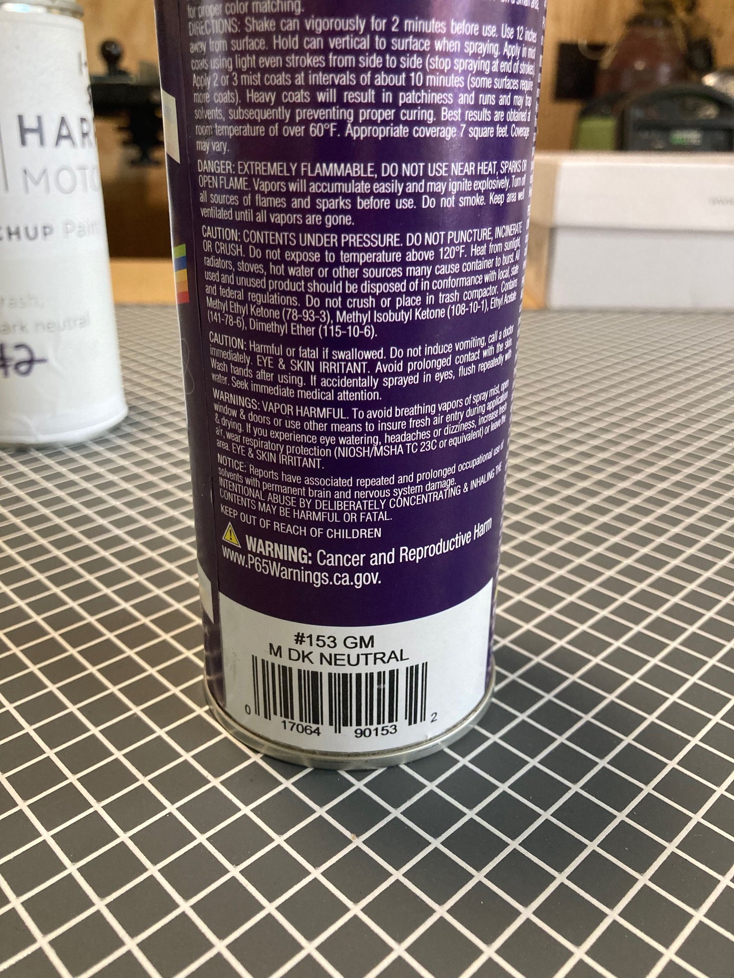

The dark shale has a perfect match with colorbond 153 medium dark neutral

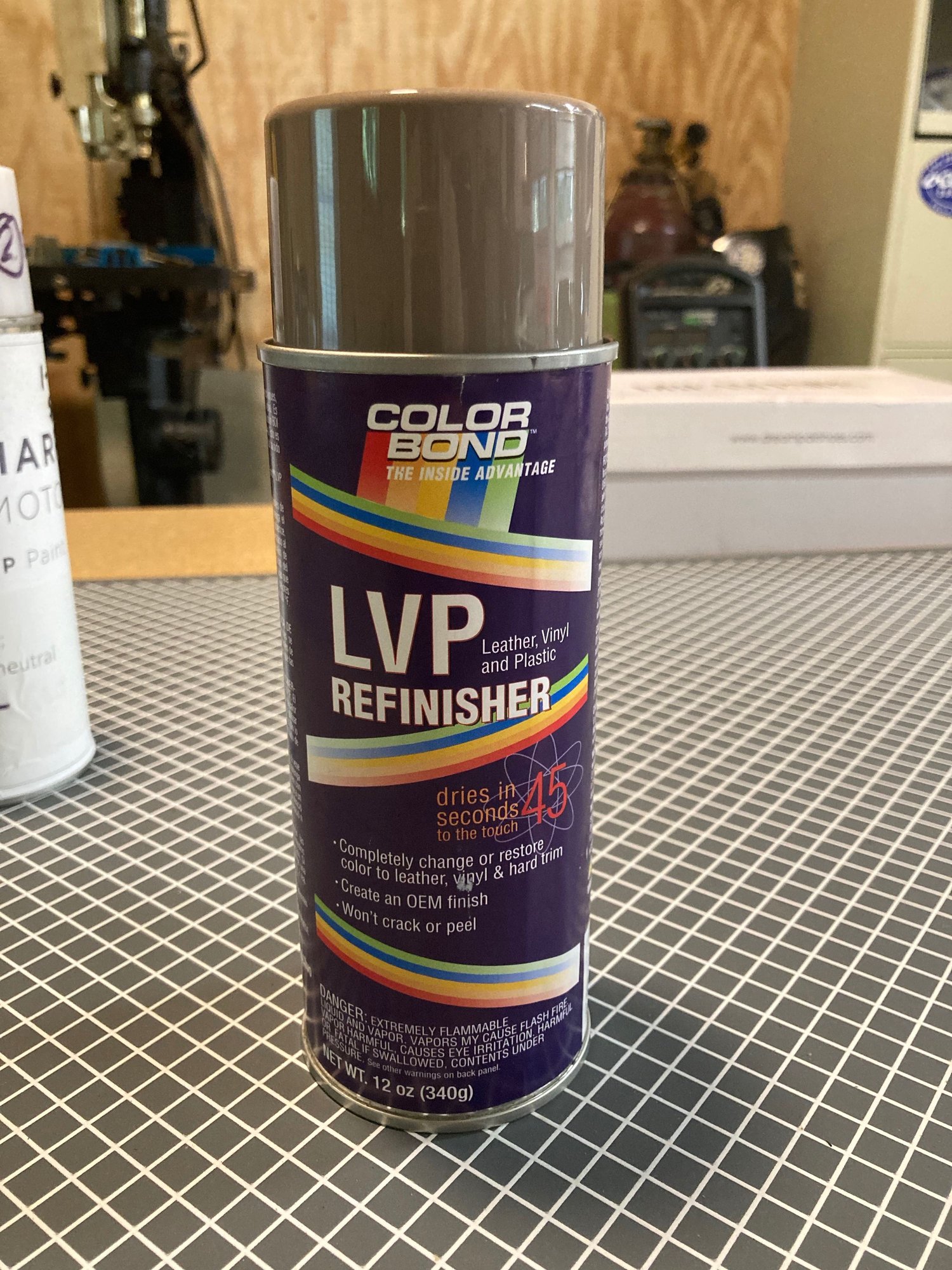

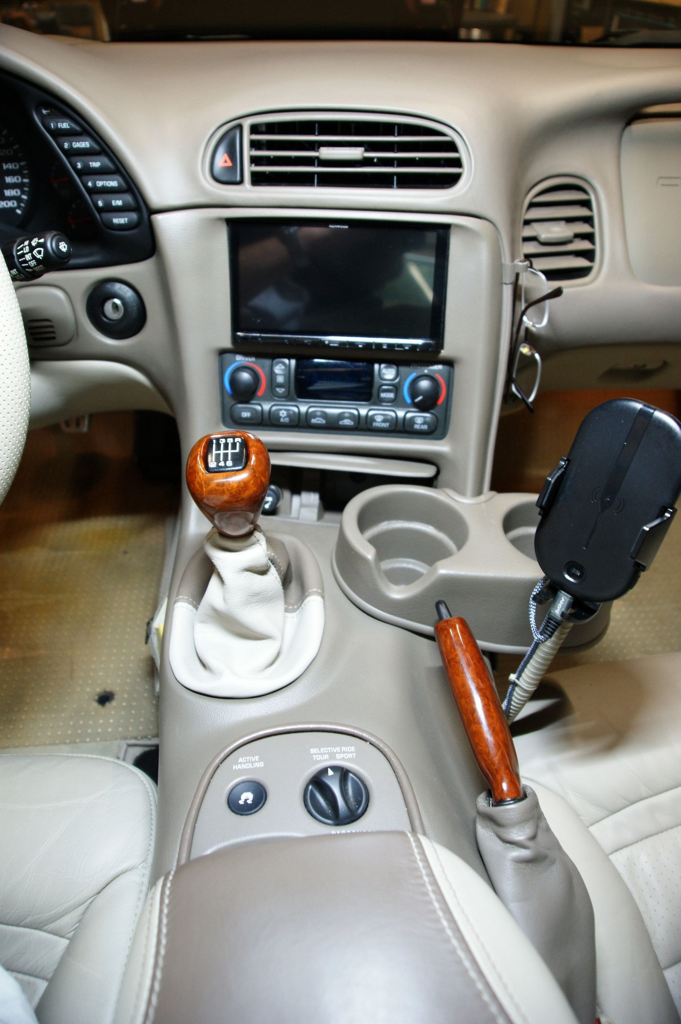

This is a near perfect match for the dark shale of my center console (the VetteNuts was too brown), just scuff and spray, no clear coatings :
LVP: Lightly scuff console with green scotchbrite.
AFTER: Did not use any clear coats.
