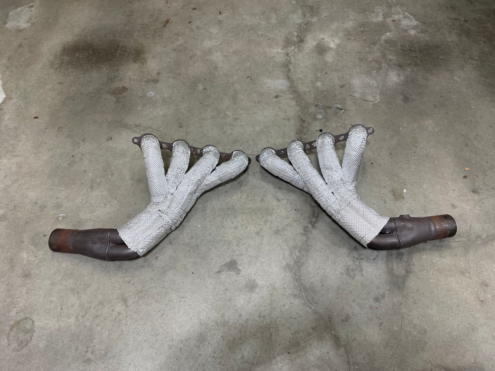

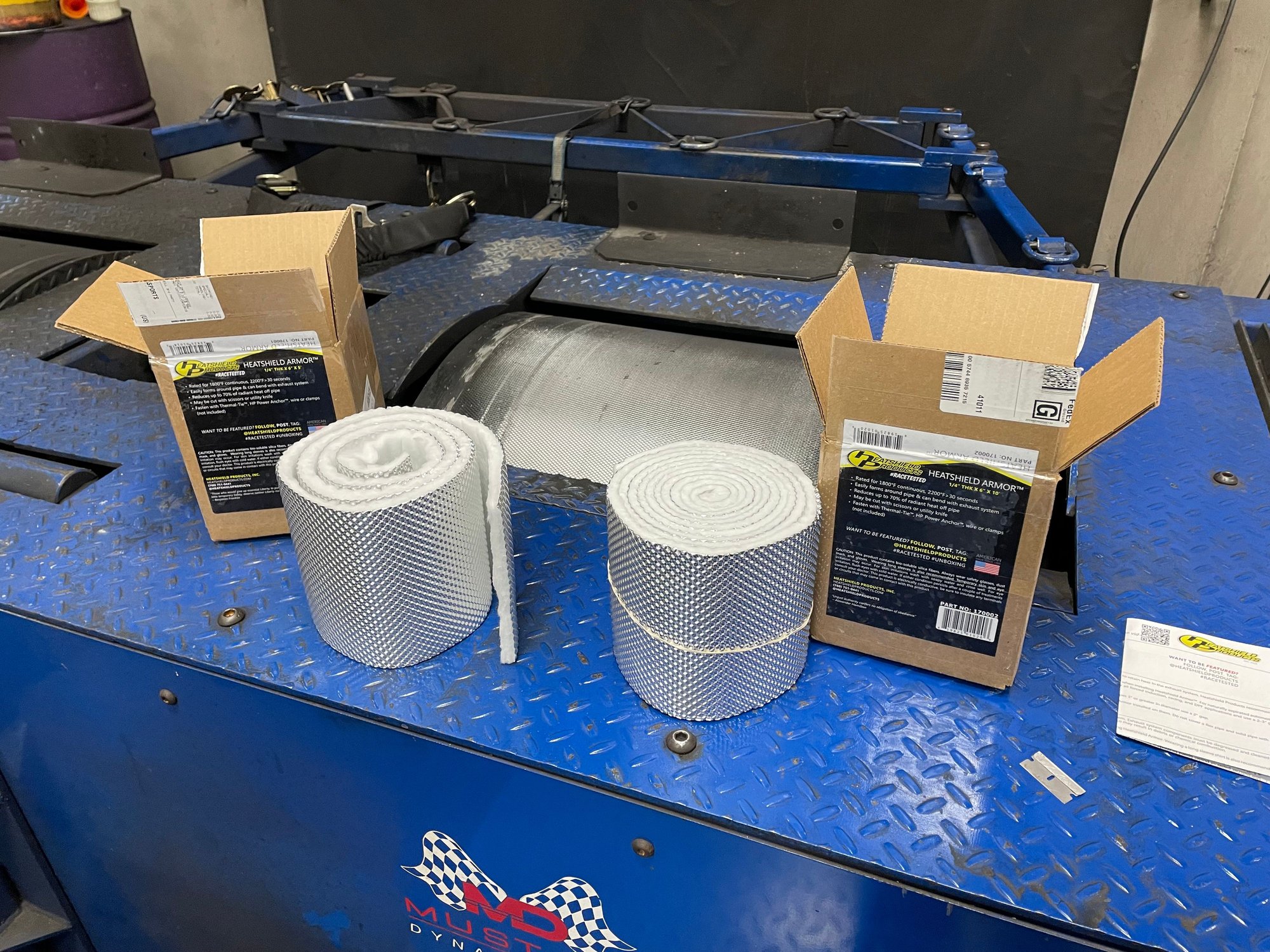

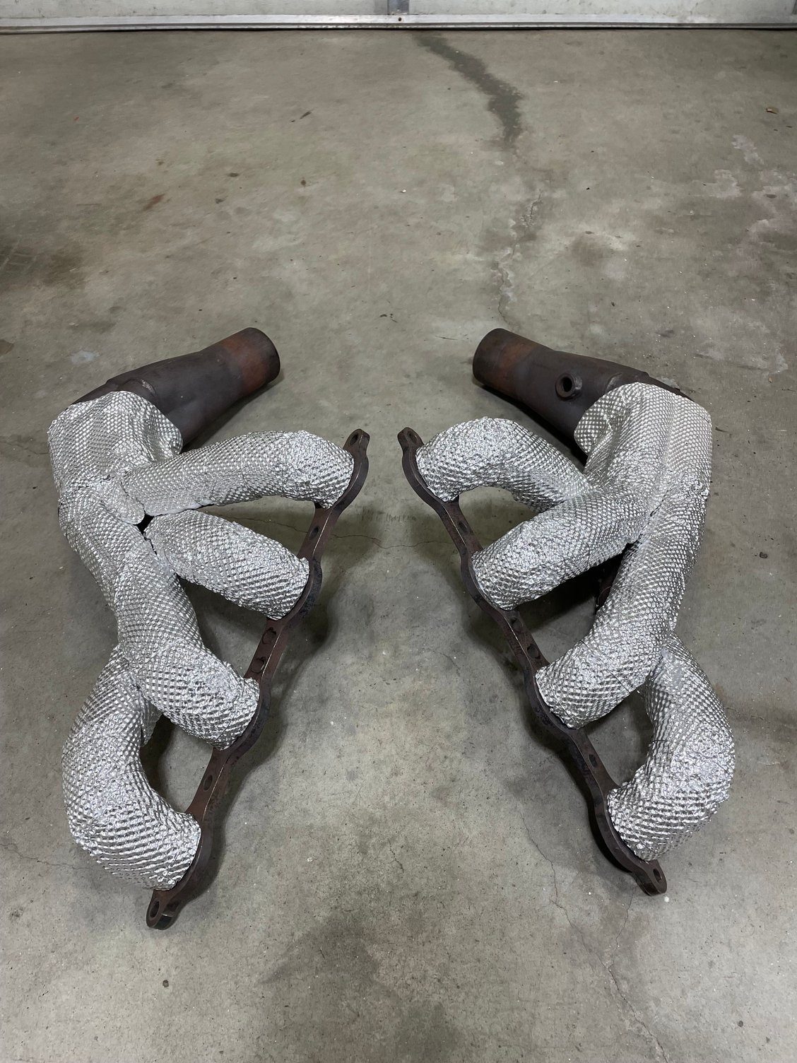

Issue is heat soak. You need to consider 3 forms of heat transfer. Conduction/convection/radiation
Most of what you see in exhaust will be conduction and convection. The more you can stop/contain the transfer happening the better off you will be. The last component will be heat soak over time. Proper coatings aim to contain the heat inside the pipe. Much like wraps or coverings being discussed.
My approach was to use HeatShield Products cover custom cut to fit the pipe to contain the heat and to add a porous barrier in between the pipe and the aluminum backing. Yes the aluminum backing still gets hot, but it cools MUCH faster than the bare pipe which means you are "containing" hear.
https://heatshieldproducts.com/produ...r-heat-shield/
https://heatshieldproducts.com/produ...muffler-armor/
https://heatshieldproducts.com/produ...eld-armor-kit/

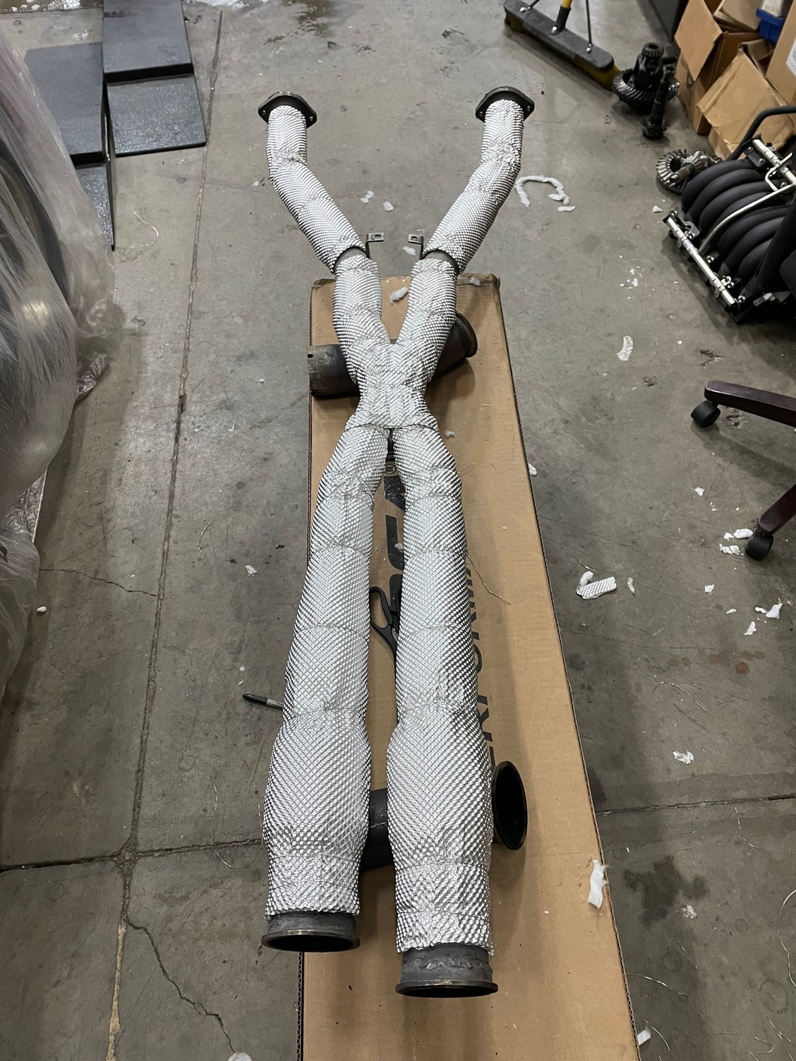

Old Nov 4, 2025 | 12:37 PM
smitty2919's Avatar
smitty2919
Joined: Jun 2016
Posts: 5,406
Likes: 3,945
From: Cincinnati, OH

Originally Posted by smitty2919
Nice job pulling this off on headers. Looks like a kit… 👍

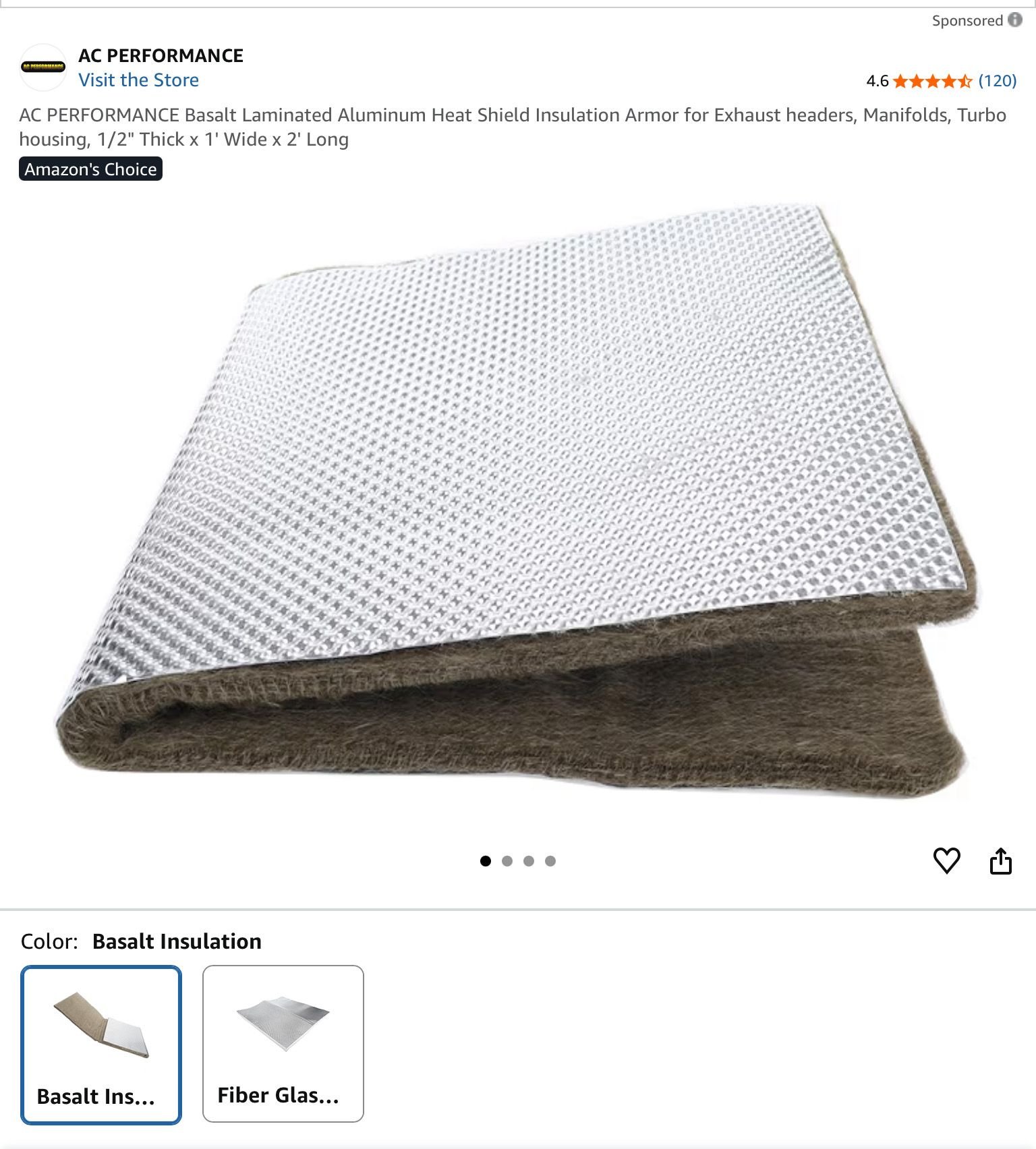

Many good points above to consider; specific goals, cost, climate, and installation difficulty. I’m a big fan of the Heat Armor type sheets, but they can be difficult for mere mortals to install over irregular surfaces (headers) and they get expensive covering a lot of area. Covering the top 2/3’s of straight-ish pipe is doable for this old geezer.
While the DEI wrap may be less desirable in some climates, it’s a good mix of cost and performance here in FL. They do well with radiant heat, and engine compartment temp is a real thing here.
DEI and some others are now making the “Heat Armor” type sheets with basalt fiber instead of fiberglass. So, less itch installing and should survive longer. I plan to use the basalt backed sheets on the smooth part of the collectors, high flow cats, and the resonators. Basically back to the X.

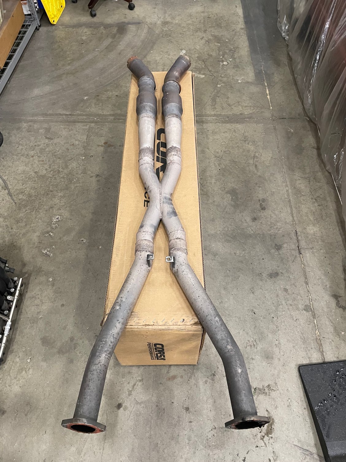

Thank! I was going to do my C7 cats/midpipe but I'm wanting to do LT's which means a whole new midpipe...C7 stuff you have to buy the headers and midpipe combo. Not like C5 where some headers bolt to other manufacturers midpipe.

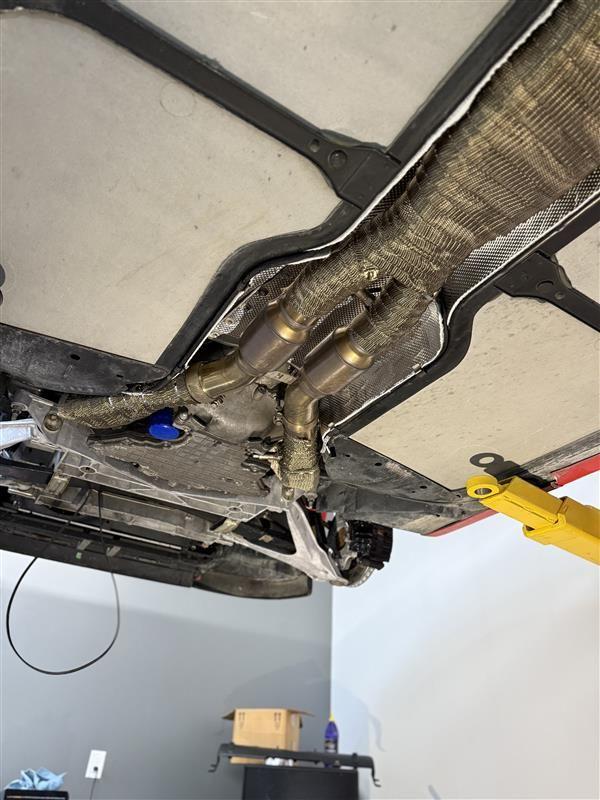

I wrapped from the headers to the axle back with the tunnel insulation, leaving the cats open due to the high temp they create. I feel like this is one of those topics that will forever be debated and is surprisingly polarizing. I was looking for comfort and starter longevity. Here is what I can objectively share:
-The interior is much more comfortable and the tunnel is cooler to the touch
-I have had virtually no starter heat soak issues since wrapping the headers, this was prevalent before with an OEM starter
-if you're lowered you will tear the wrap if you high center
-the car doesn't get driven in the rain and it lives in a heated garage - this was factored into my decision to wrap
-when I need to clean the motor I let it get to temp and lay a rag across the headers to keep them from getting wet.
