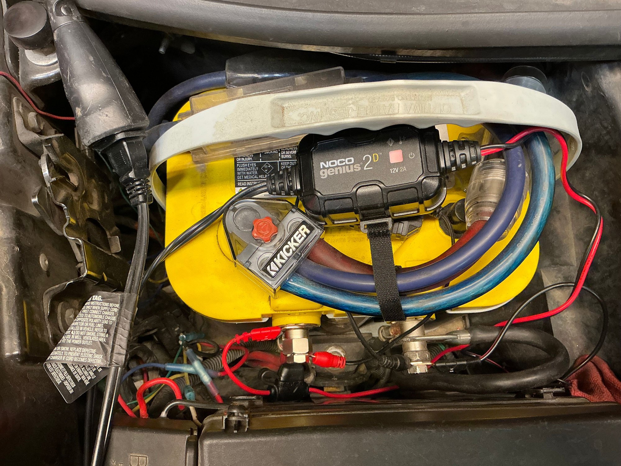

Originally Posted by jdmvette
What in the swiss cheese is all that wiring for? Inquiring minds want to know.
I understand the need for the big lines. Why not run a remote pos / neg node to the interior and connect all your wires off those or a fused power block?

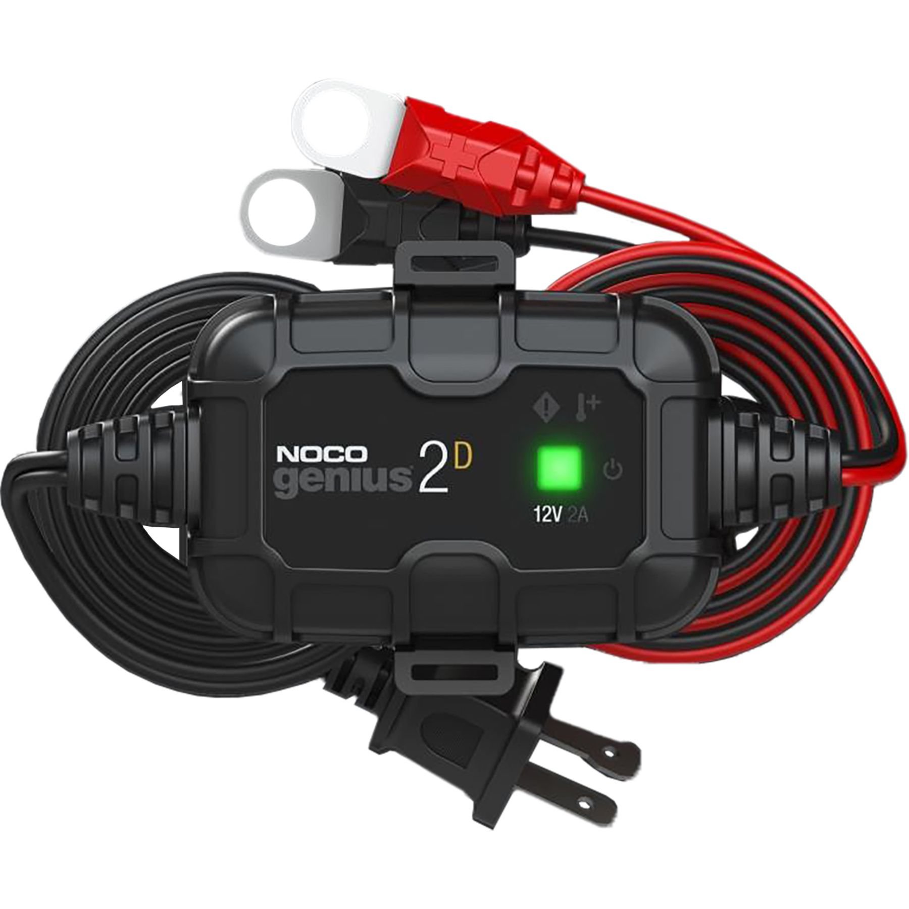

And there's no reason to have the tender attached to the battery. It's better and more logical to leave the tender on the bench and run a NOCO output extension cord to the battery.

Originally Posted by eric22
And there's no reason to have the tender attached to the battery. .
It's literally how it was designed

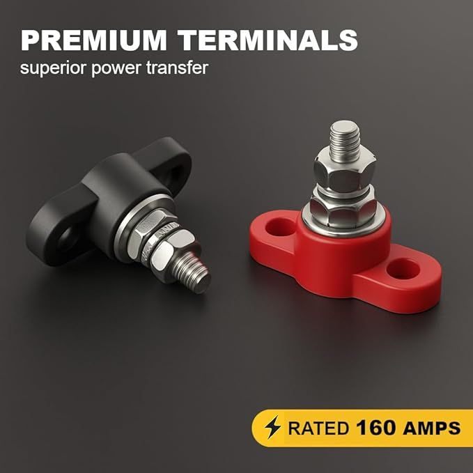

The idea of running dongles off the battery for easy maintenance is a solid one. No question from me. I just like running terminal blocks for organization purposes, but also for ease of diagnosis. These MGI power terminals below are very handy in a C5 as well when you being adding electronics. I have a habit now of applying No-Ox-Id to any exposed connections and grounds as well.
Yes - via an extension cord if the battery is too far from the tender with the standard output wire. Underhood is no place for the tender, and it's kinda hard to use it for something else while it's in there. The better way is to get one ( or even two, like I did) of their extension cords, connect it to the red/black leads we see attached to the battery, and have the tender outside on the bench or under the car, or whatever. Then there is no tender under the hood, no 120v primary power cord under the hood, etc.
