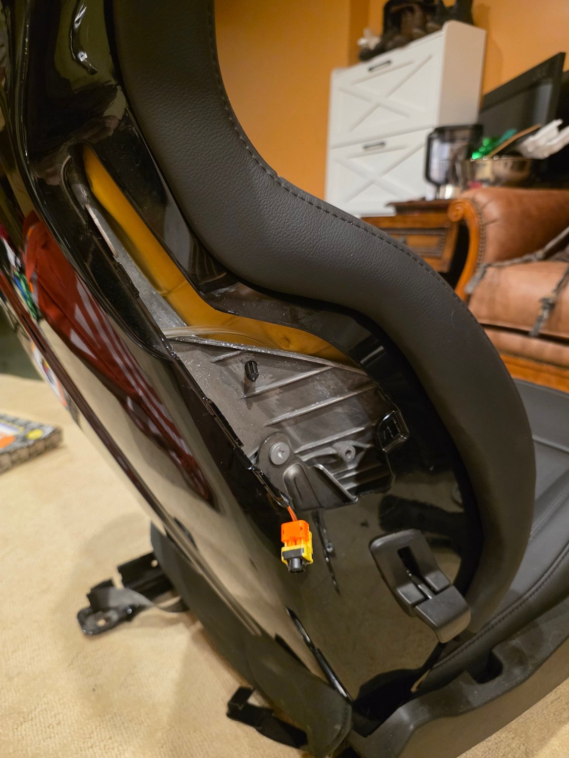

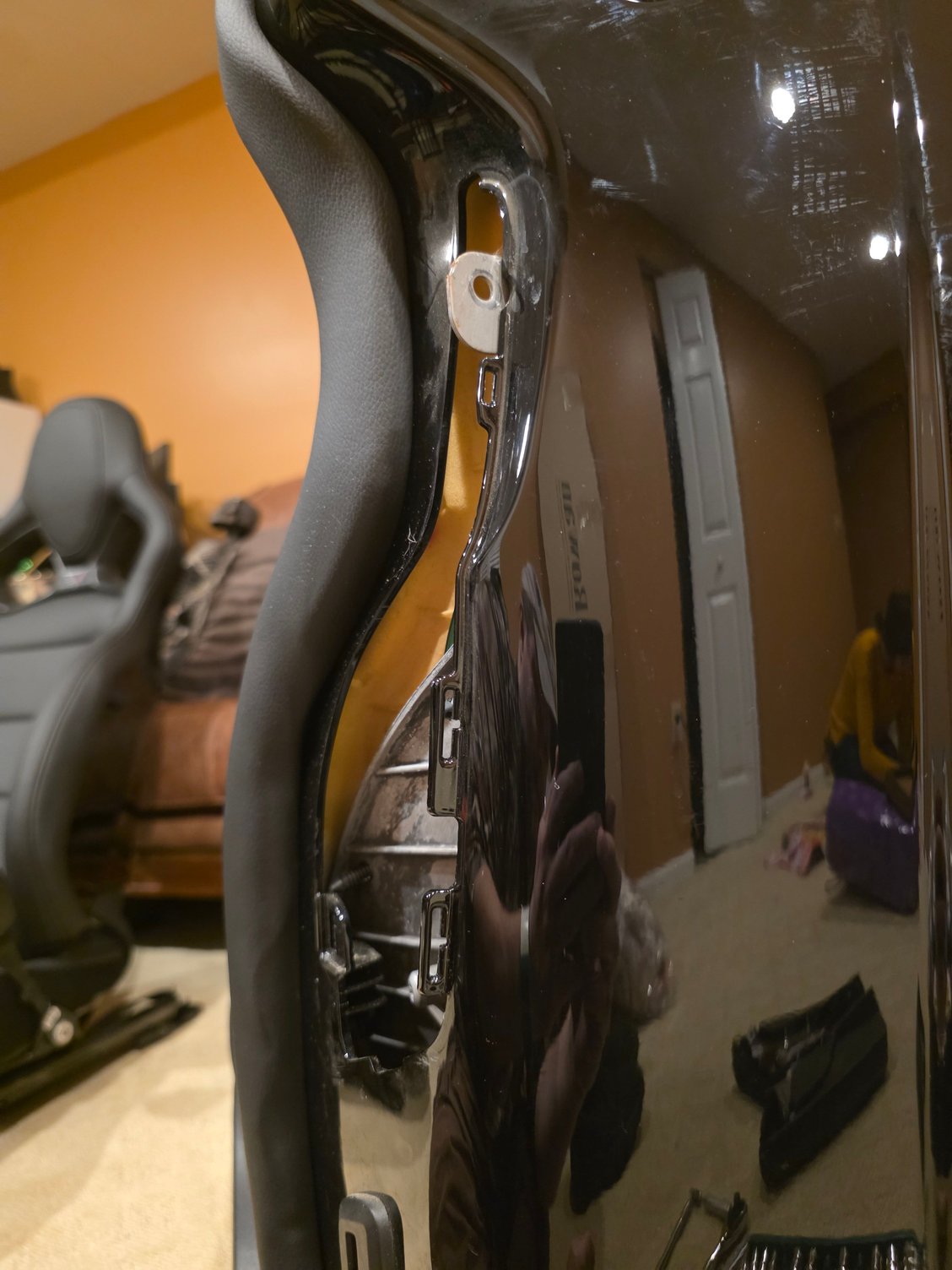

I have some C7 Comp seats I will be using in one or both of my cars over time. I am just removing the side impact airbags today as they are vestigial and take up space. At some point in the future this space may have a roll bar passing through tightly, but that is undecided.
Removing the airbags leaves a large open cavity in the side of the seat. Both seat backs are equal opposites. My thought is to make a mold of the clean side of each one to then use with an appropriate smooth /shiny plastic (or paint one which isn't) and heat it to match the form and then cut it to fit over the cleaned up open areas.
My question is likely twofold then.
How best can I make an appropriate mold?
And what heavy gauge smooth plastics might be recommended for use?
This is a purely cosmetic project.
Open area on the passenger seat

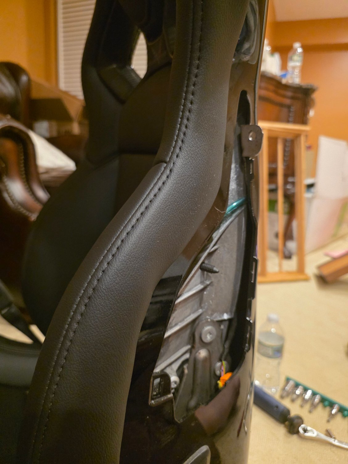

Clips could be done. One exists at the bottom forward point to be used. The rest I would shave off and possibly attach several clipping points from inside. But I would still need a fitted piece to mount.
Some angles. Anything sticking out I would want to remove.

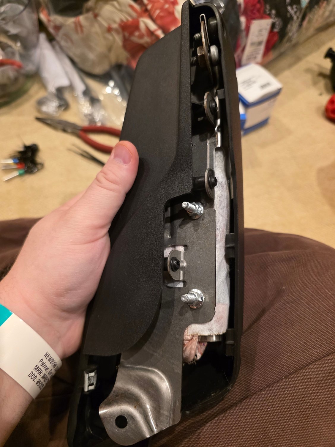

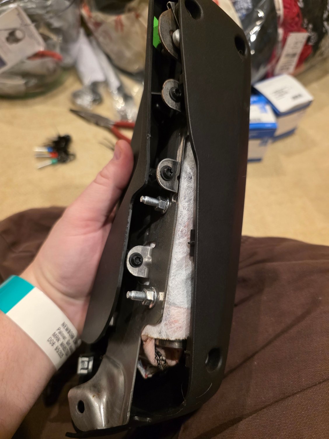

Can you snap a pic of the backside of the airbag housing, Tusc? Im interested to see what the attaching tabs look like.
Maybe this is something a person with CAD skills can model out for 3D printing to add to your list? Design a "flat" cover with the airbag attachment points that could be painted gloss black?

A good idea to look at the frame, except one of the two tabs sticks out beyond the shell. The upper ear sticks out. The lower ear mounts to the seat frame directly.
