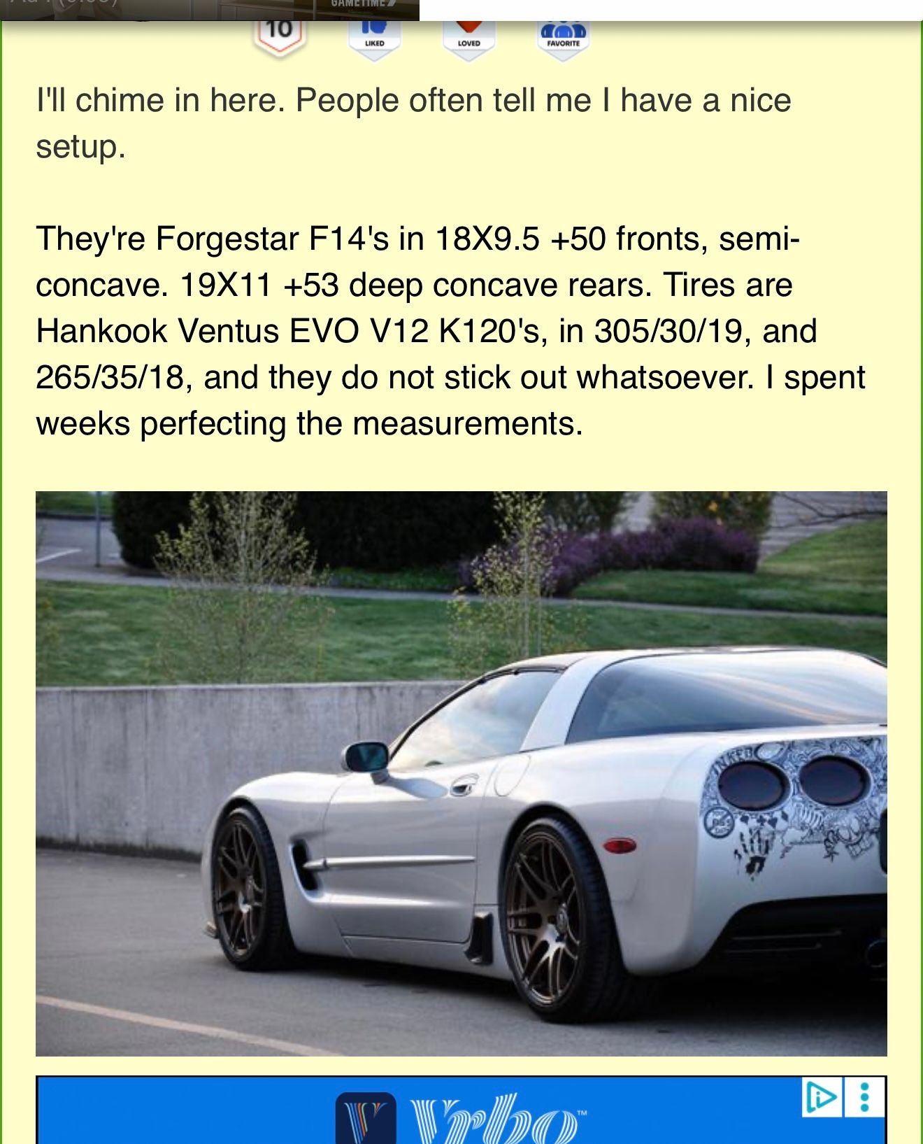

according to this post, and his picture which appears perfectly flush, the math works out that a 1.5” spacer would identically mimic his setup. So I figure 1.25”, if it clears the studs, would pull me in a hair for safe measure. I just don’t have all the parts in place to tinker at the moment so trying to figure it out mathematically…also those C7 wheels have cutouts relief between the lugs that would allow up to 7/16” of stud to protrude past the spacer into the wheel without contact or interference

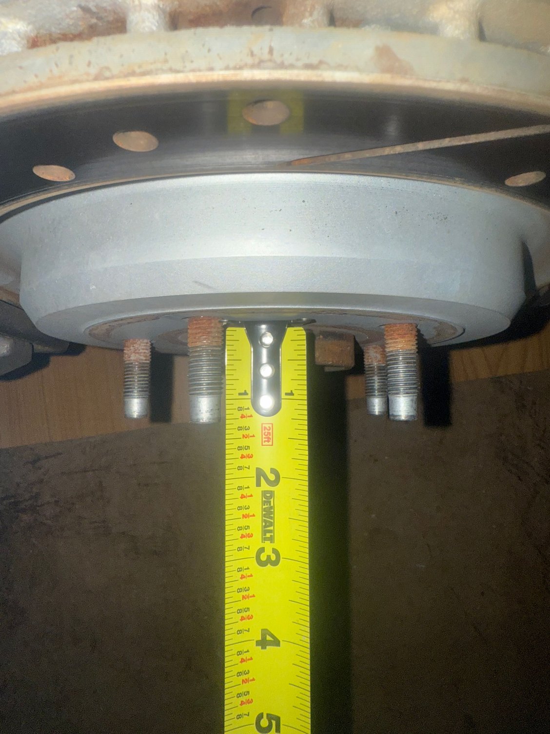

For future reference when somebody needs a real definitive answer…it’s just a hair over 1.25”
