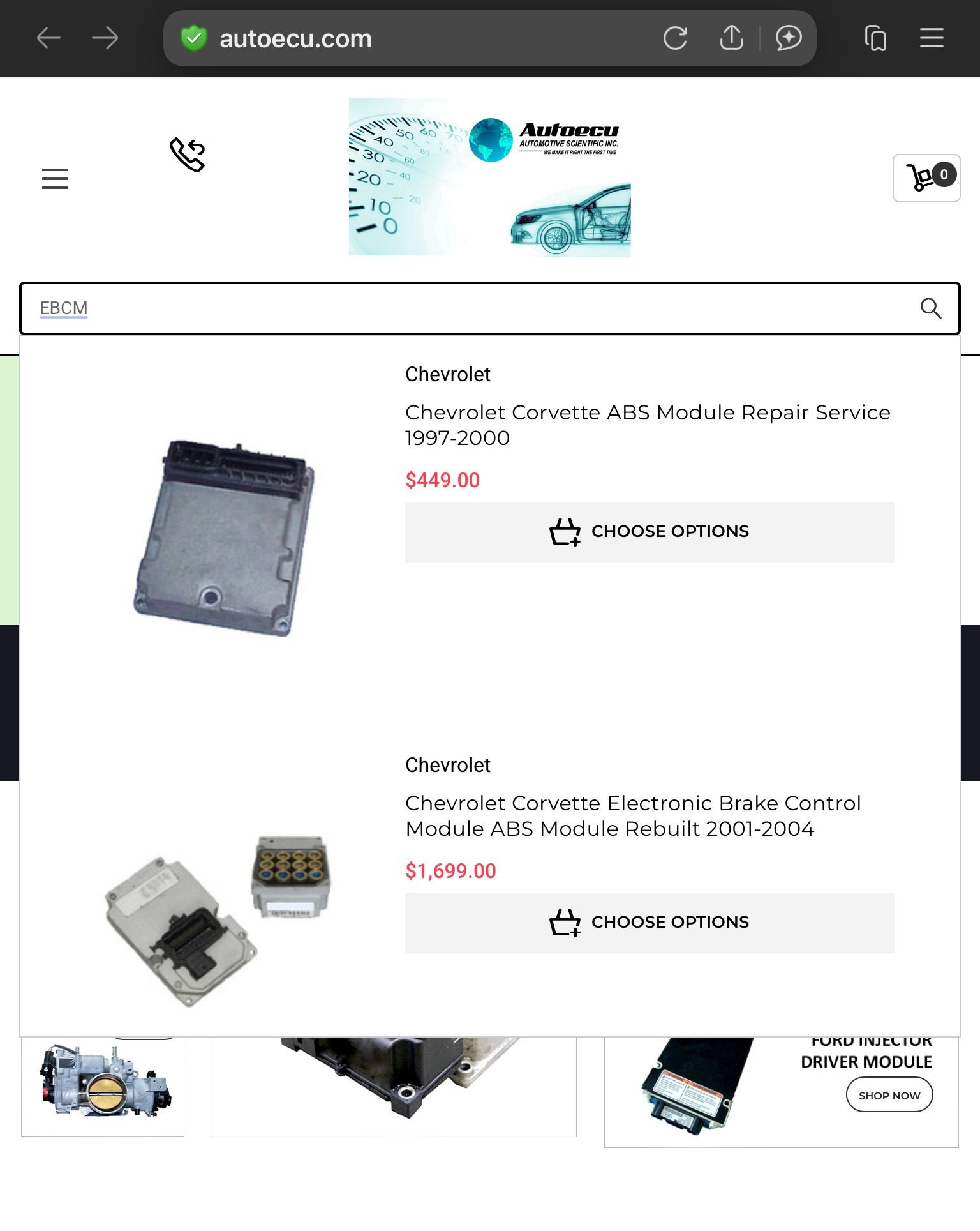

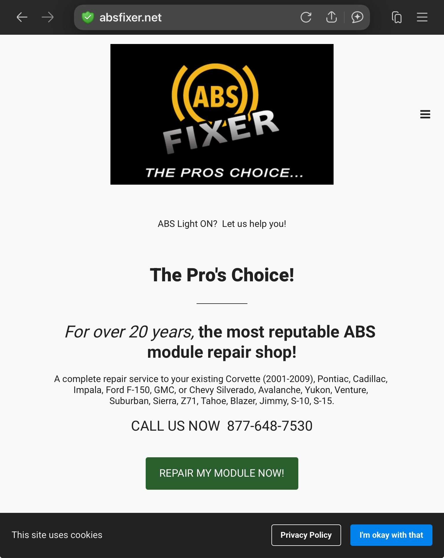

Food for thought…. Not only is ABS a foundational safety feature in modern cars and trucks, the C5 in particular uses the EBCM for active handling, ie., may save your *** in a turn…. I would not buy a car, much less a sports car, without the ABS and traction control fully operative. I know others may feel differently.
Now, if you’re not concerned with traction control initially, but see some value in having it there are some companies that may be able to help you. See below.
