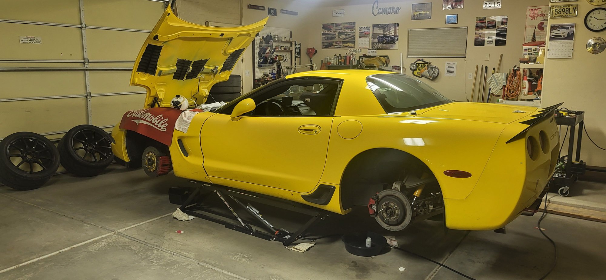

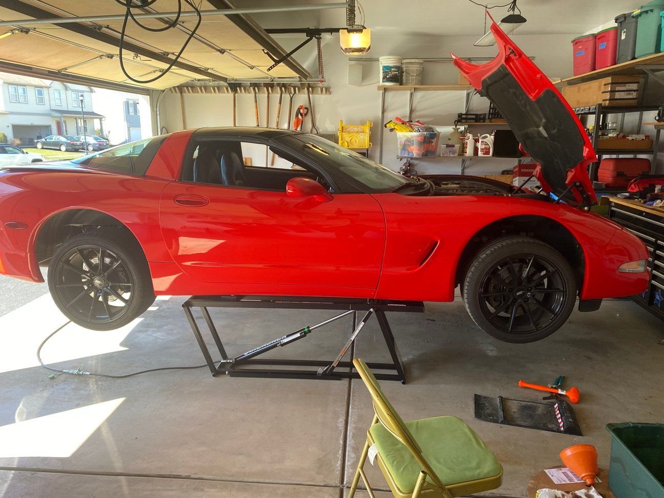

Is there a definite way that quickjacks should be positioned? I appreciate the forum members knowledge and opinions on most subjects that come up. I stole one picture from the tech board and one picture is mine. Maybe it makes no difference at all because as the pictures indicate it will operate either way. What say you?

Works either way. Depends on where you want the pump and which direction you want the car to move as it comes up. Remember it moves about a foot as it comes up.

The way I have been using mine, the bottom picture, it moves up and back. That puts most of my hoses and pump toward the front of the car, which if you are working on the engine and front end makes things a little more cluttered. If indeed it really doesn’t matter I’ll have to consider that when I next position them for the job at hand.

Never gave it much thought. I position mine like the top pic. Since it moves a bit forward it helps as I squeeze another car in behind the Vette. Next time I'm doing trans/rear diff work I'll have to try them the opposite way.

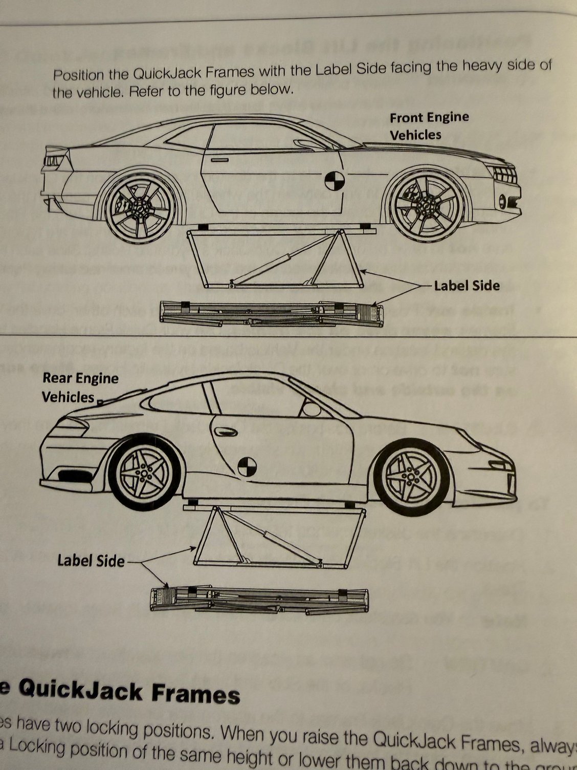

According to the Quick Jack instructions. The Label Side should be facing toward the HEAVY side of the vehicle.

Interesting, well for my Corvette and Durango, both being close to 50/50 front to rear weight balance, then it technically doesn't matter. But for the wife's FWD sedan, there is only one "correct" way.

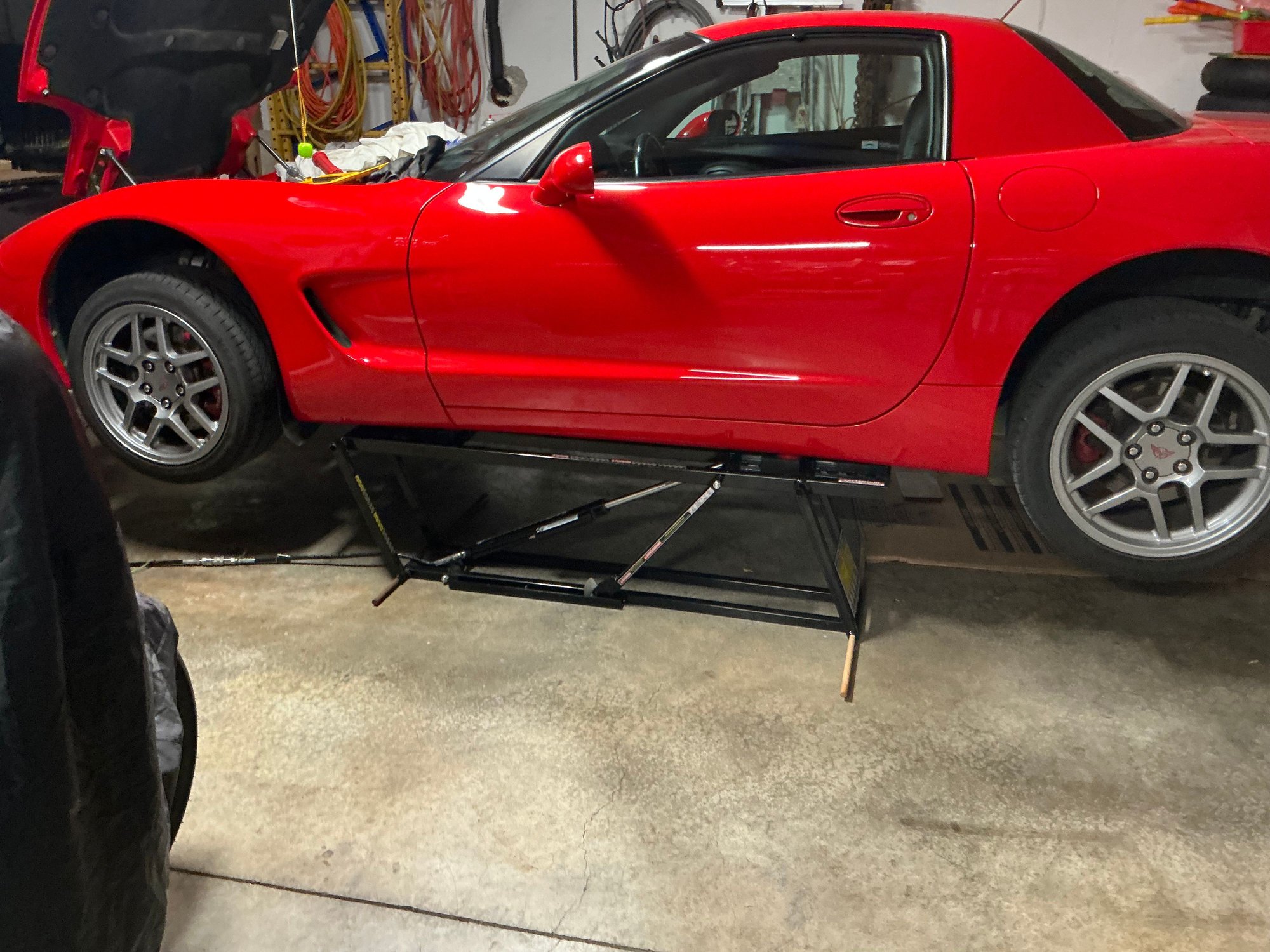

QuickJack also says you can turn the frames 90 degrees to the car. Just remember the car will move sideways when you lift it. Also a C5 is almost 50/50 weight distribution.
I would like to know where you read this? I went through my entire operator's manual. Nowhere does it say that you can turn the lift frames 90 degrees.
This is the only illustration in the operator's manual.

Yes, you can use them transversely as well.
