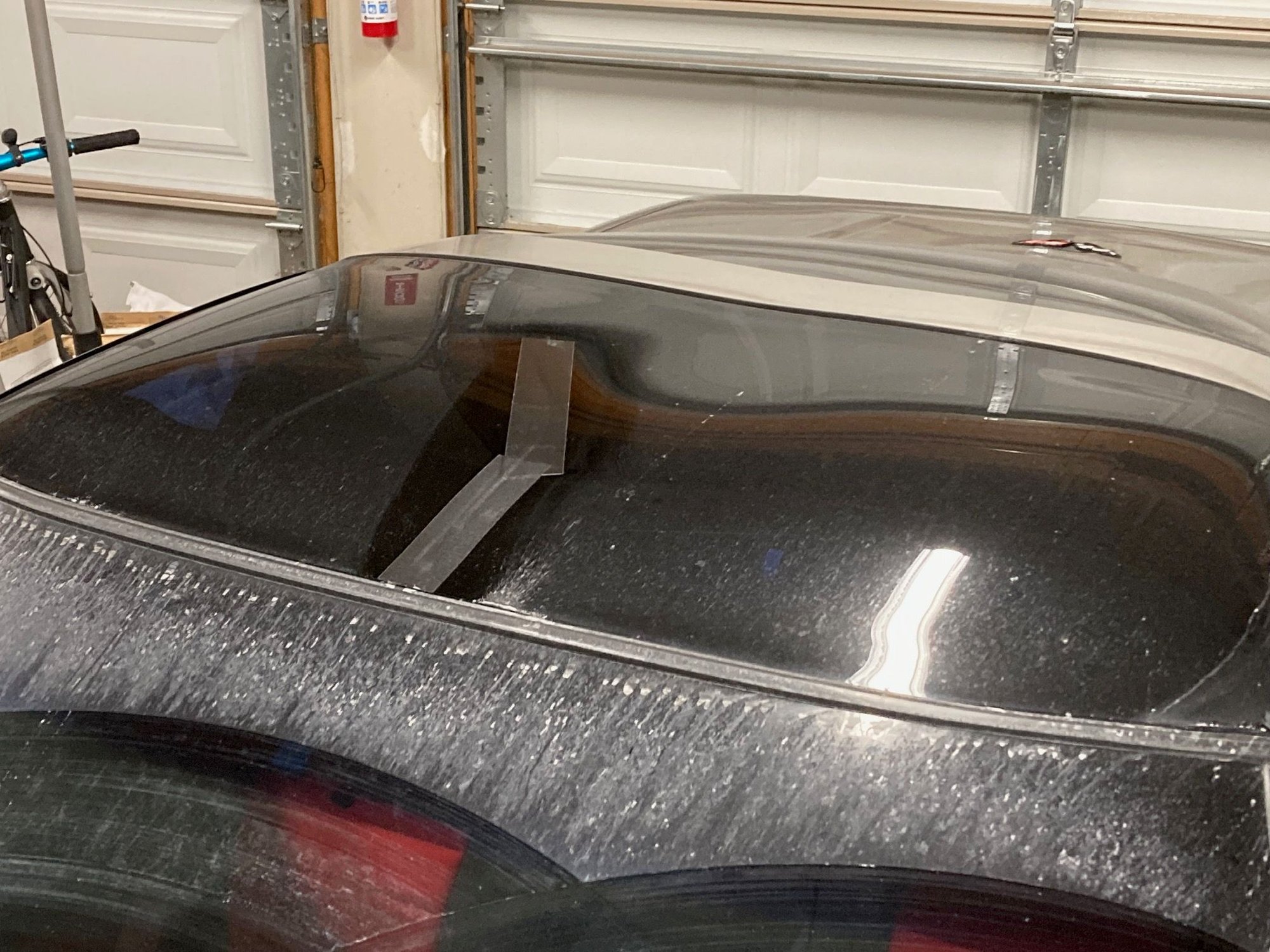

With the arctic cold weather in STL recently, I've managed to crack my targa top. This is my daily driver, so I know it's dirty - overlook that for me. The top kinda has a dip (low portion) in the center. This seems to extend to the top of the hatch glass as well. Much like the one on the hood. Here's my question: Is this normal?
Wanting to buy a non-Lexan top due to cooking while driving in the STL summer months, but I don't see this same "dip" in the painted ones on eBay, so I'm not sure it will fit the same way. Can I only replace with another glass top?
Thoughts?

Solid top fits exactly the same as the transparent top, my car came with both.

As stated above they fit the same. I have both as well and the lexan (clear top) has two more noticeable humps above the driver and passenger seats. Better for fitting a driver with a helmet on compared to the SMC (sheet molded composite) painted top. You get another inch or so of head room with the lexan. The SMC top is the same material the body of the car is made of.
The SMC hood with liner keeps the interior waaay cooler than the lexan top during really sunny hot days. The SMC top also keeps it quite a bit quieter inside the car. Plus the interior looks more refined from inside with the SMC top.
I rarely keep a top on my car when I take it out but when it's really sunny and hot it's the SMC. For cooler cloudy days or chilly nights I use the lexan top.
It's fun to have the option of both.

Really appreciate the additional info Johnny! That explains what I am seeing. Still in search of an SMC top that is at least close my pewter color.
