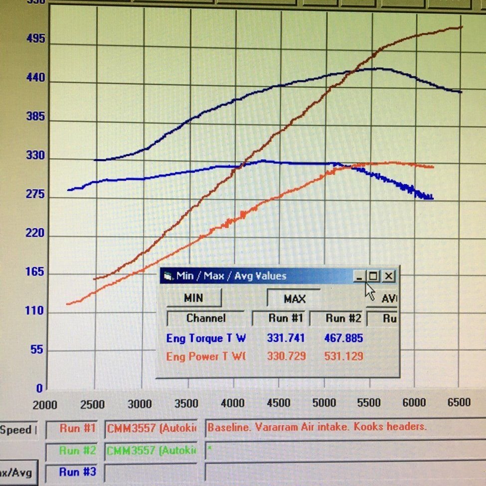

I didn't have the exact same setup, but I have a "before" and "after" dyno when I did my super charger. look at the "run #1" curve -- vararram intake, kook headers, I had an x-pipe at the time, z06 cat back, and a tune. Peak was 331 lb*pound/330 hp

This is actually really helpful. Appreciate the reply!
