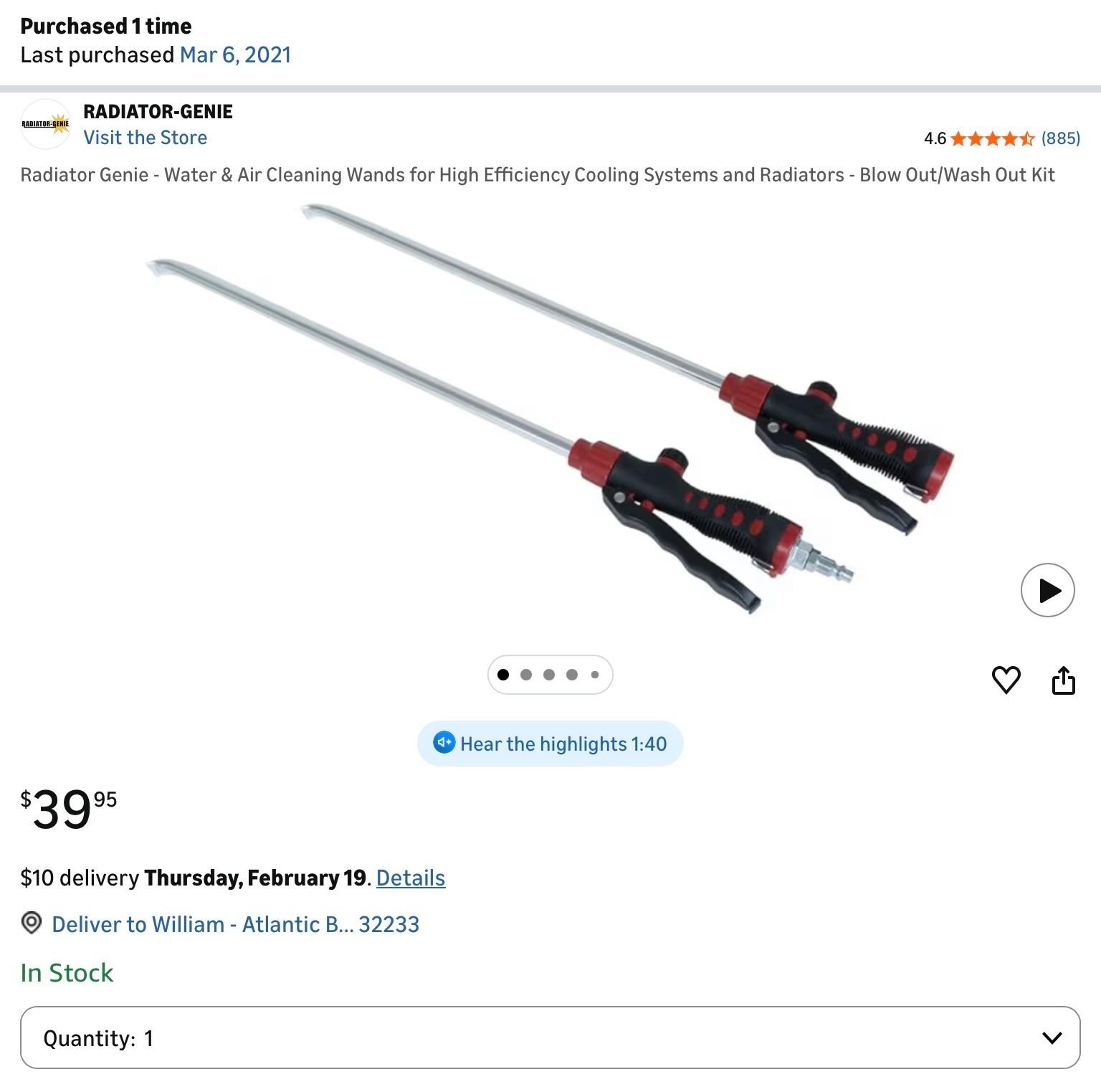

This works pretty well.
https://a.co/d/03GO5il2

Yes, back flushing with something such as the above wand units.

Looks more promising than anything I’m using!

A tool like that should work very well in cleaning out all the debris from the radiator area.

These look good. What's the best air pressure system to use with these? I see a water hose attachment, but would rather try air first.

I have them and the air wand works great. I haven't used the water yet.

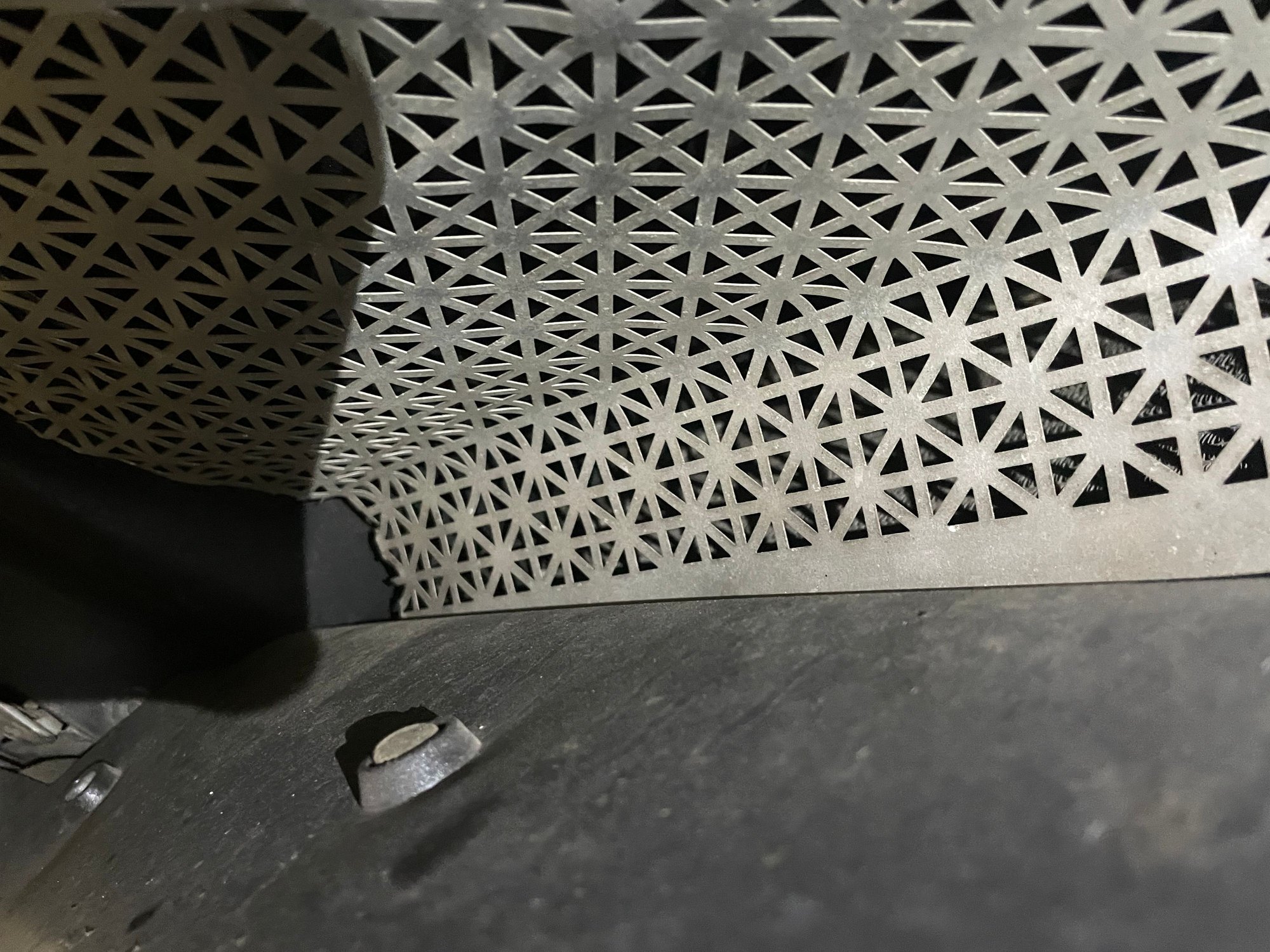

home cheap screen $2.00 bend and mount with screws
no negative affect on cooling air
keep trash out C5 is a bottom feeder
