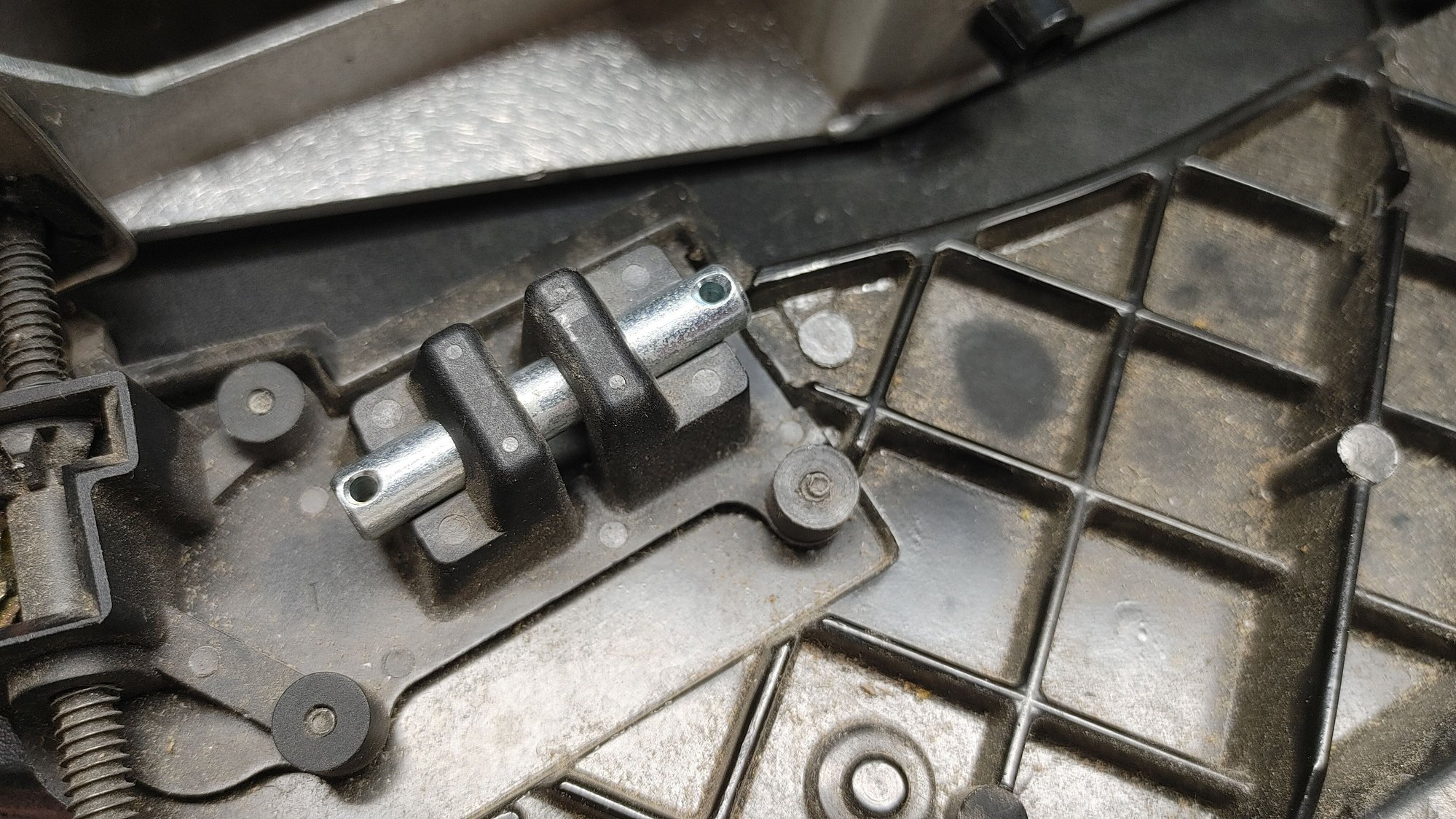

Somehow the actuator pin fell out of the headlight bucket. This is the pin that holds the motor arm onto the bucket.. Thankfully I found the pin laying down below the headlight - but the little push-on retainer washer was gone. Amazingly Home Depot bailed me out and these little 3/8 inch E-clips fit nicely with a bit of friction.. Will have to see if this is a permanent fix…

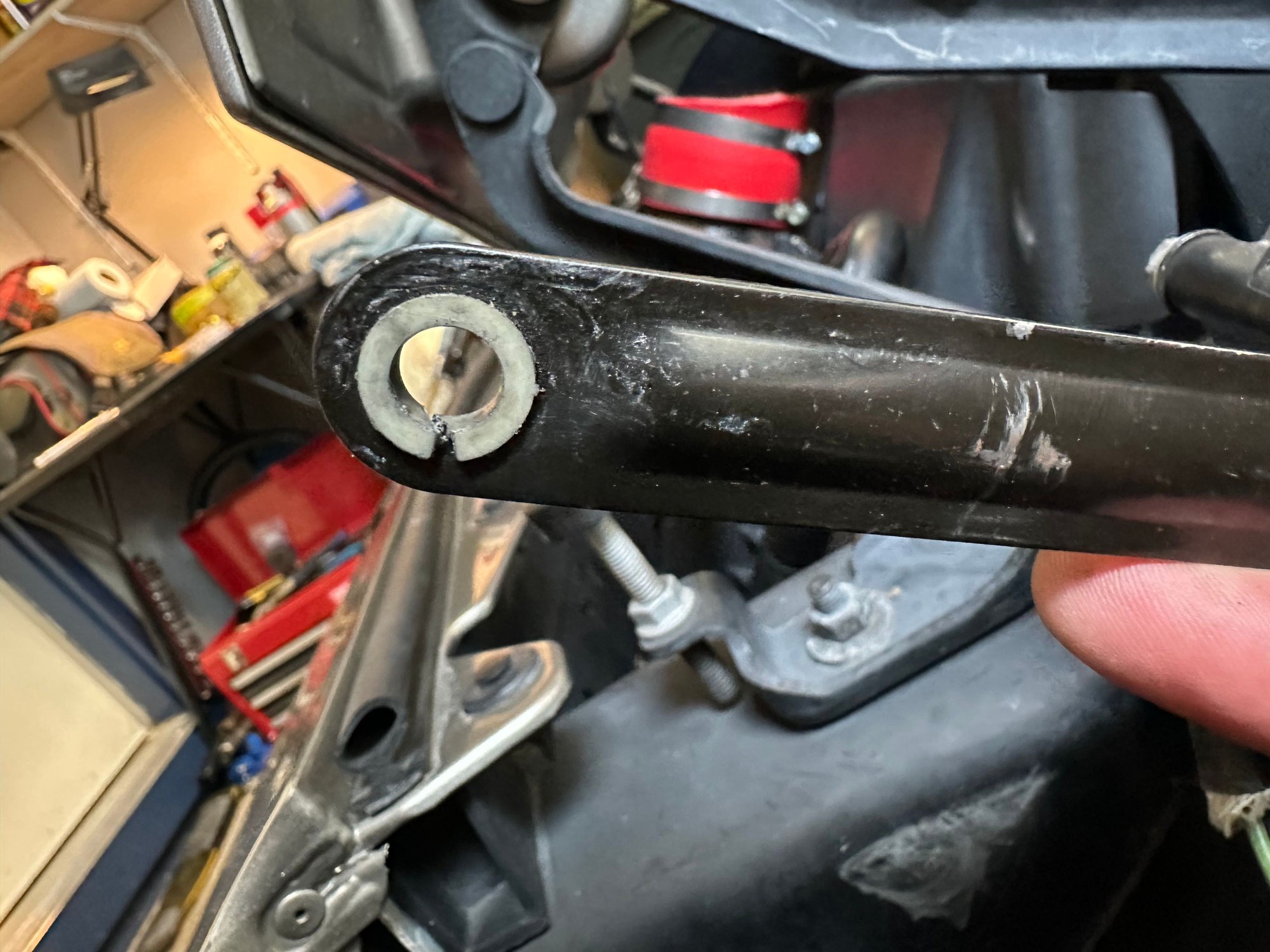

Next problem - after getting it all together the headlight has excessive play - I tracked it down to this bushing that fits into the end of the motor control arm - I don’t think Home Depot will be able to help me with this one. Is it available?

Sets are available on ebay including the bolt.

The little retainer clip was also missing on the other side, but I think the pin stayed in place because the actuator arm had the bushing in it 🙄
Well NOW I see how it was supposed to be put together - it looks like someone was in there before me 😡
https://ebay.us/m/ssfuD6

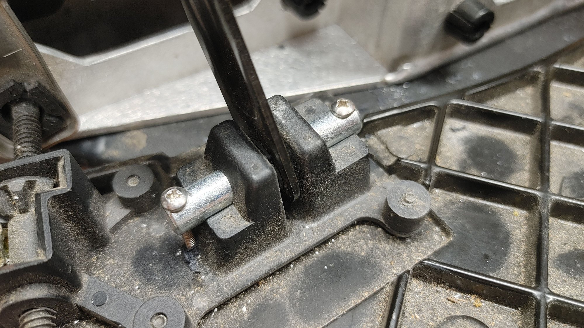

You can get this pin:
https://www.mcmaster.com/catalog/93890A445
#4-40 screws 1.25" long with lock nuts and a fender washer
then bolt it to the frame to minimize movement:
To Headlight actuator pin
