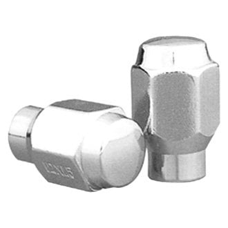

I've seen some guys use 10 or 12mm spacers with ET Mags style lugs, but you might have to drill the lug holes in the wheels bigger for the lug nut shank to fit through.
Doing that allows the lug to grab enough threads on the studs without going to longer studs.
