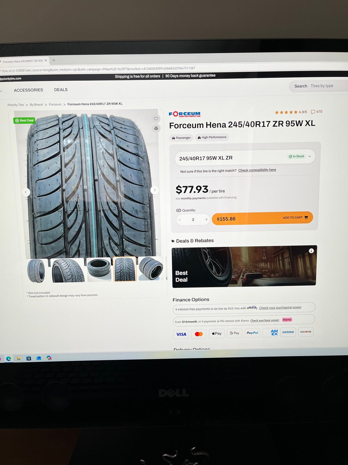

What’s up my brothers. I’m looking to get some new tires for my 2002 VETTE. I’m using the oem thin spokes rims. They are 17x8.5 fronts. And 18x9.5 rears. I’m thinking about getting the tires pictured here. My question is would it be ok and not trip any codes or traction control issues by using a 245/40/17 instead of the stock 245/45/17 in front. The rears will be 285/40/18. A little wider. But still stock sidewall height. Any help is greatly appreciated.

Your spedometer won't read true. Changing the sidewall ratio changes the tread diameter. You'll need to have the computer tuned to calculate speed correctly. As for those cheap tires, I wouldn't.

I'm not sure how to react to the "cheap tires" comment above. Maybe for those Forceum tires but, not the Goodyears. Those Goodyear tires (the 3's) are what is found on an 6th gen SS 1LE and a variant of which is on the ZL1 1LE (3r). I think those are plenty good for a C5 Corvette in the vast majority of situations. However, I think a Michelin Pilot Sport 4S would be even better in OEM sizes (if available).

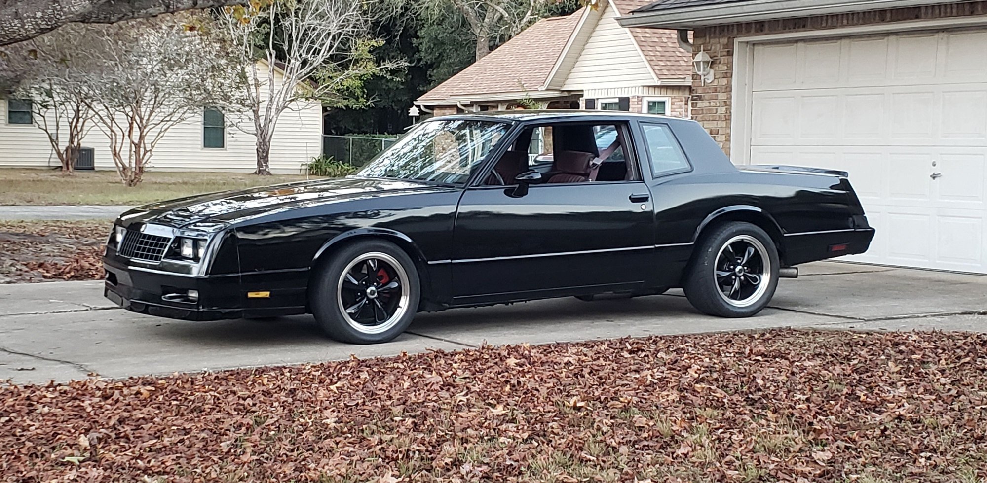

I think the G2 stands for Gen 2, I have the first Gen Nitto NT555 Tires on my Monte SS. 1st and 2nd I can blow them off the car, I'll get them to bark going into 3rd and I can break them loose in the higher RPM's. Then again this car makes about 520hp, 6spd Manual with 3.89 Gears in the back so that's a factor.
They are 17's, 245/45 front, 285/40 rear.

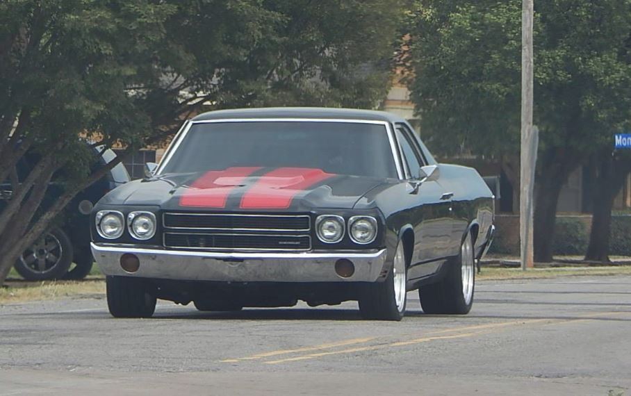

I ran the 555 G2's on my 70 El Camino restomod, with 420rwhp 385" Dart motor, TH350 w/2800 converter, and 3.42 gears. They were decent tires but definitely not top line.
255/35/18 fronts and 305/30/20's on 18x9 & 19x10 wheels.
