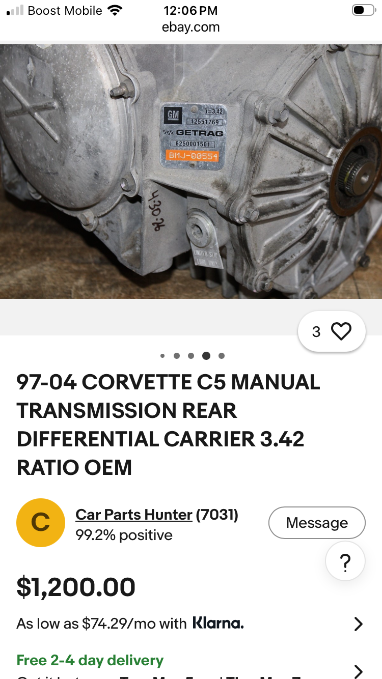

Here is a 3.42 diff for $1200.00 with free shipping, says it has 72,000 miles and was pulled from a 2002 that was wrecked.
Have seen others for $1500 plus shipping, was looking for a friend who has 2004 C5 with 2.73 gears, I had pulled his drivetrain out to put in another torque tube he bought from local Corvette salvage place.
Tried talking him into swapping a used 3.42 diff while it was all tore apart, but he didn’t want to, oh well.
https://www.ebay.com/itm/28730457528...ASJ849PQ9XJV95
