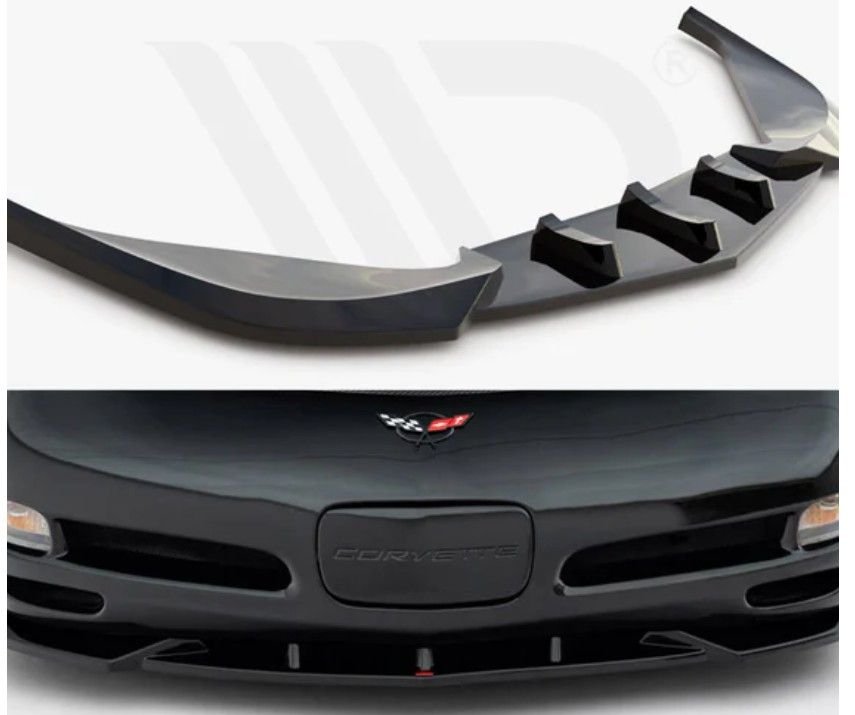

Sorry, I misspoke, not a hole, but open flow, with a floor for downforce, I downloaded a picture of what mine looks like.

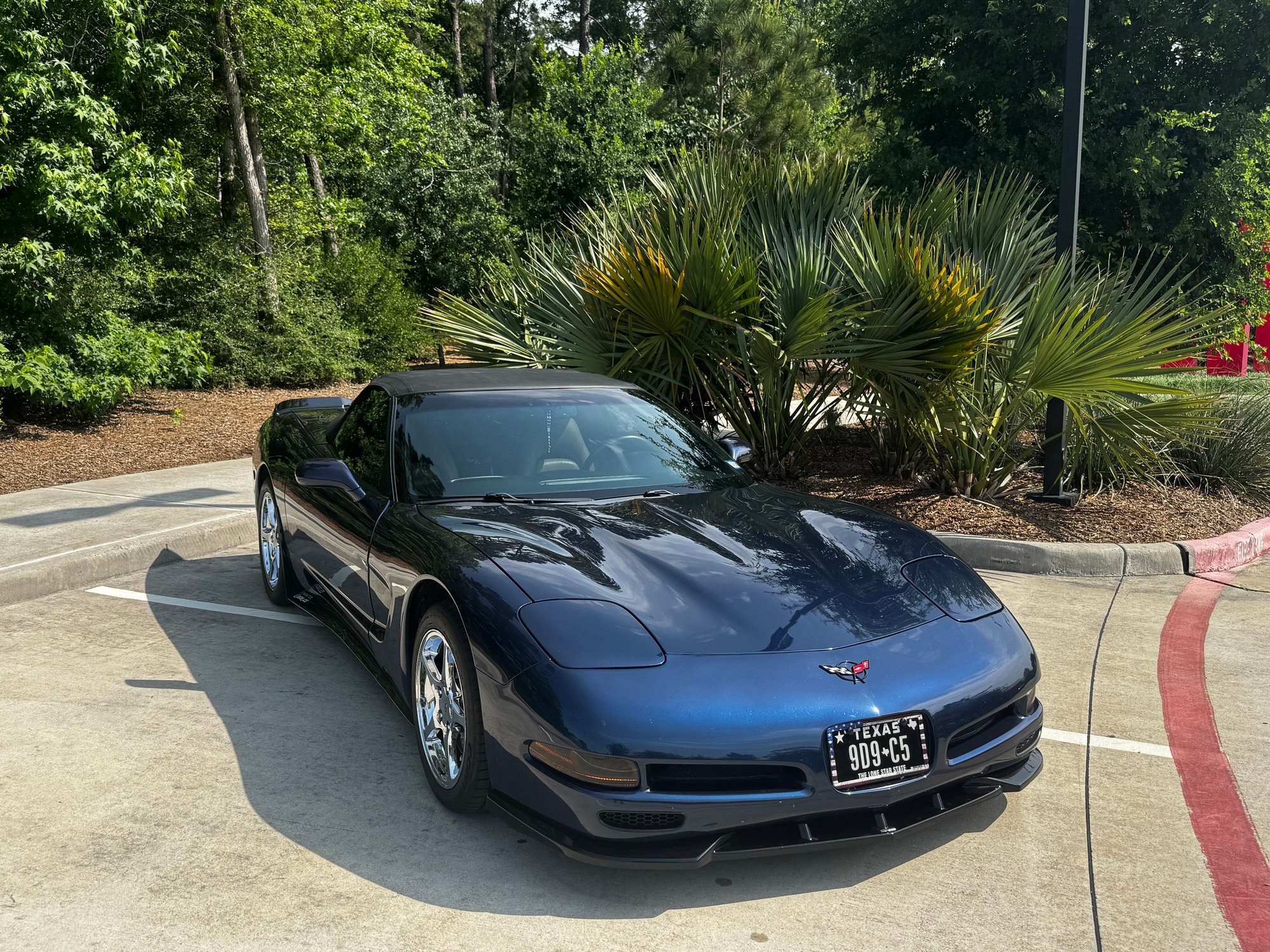

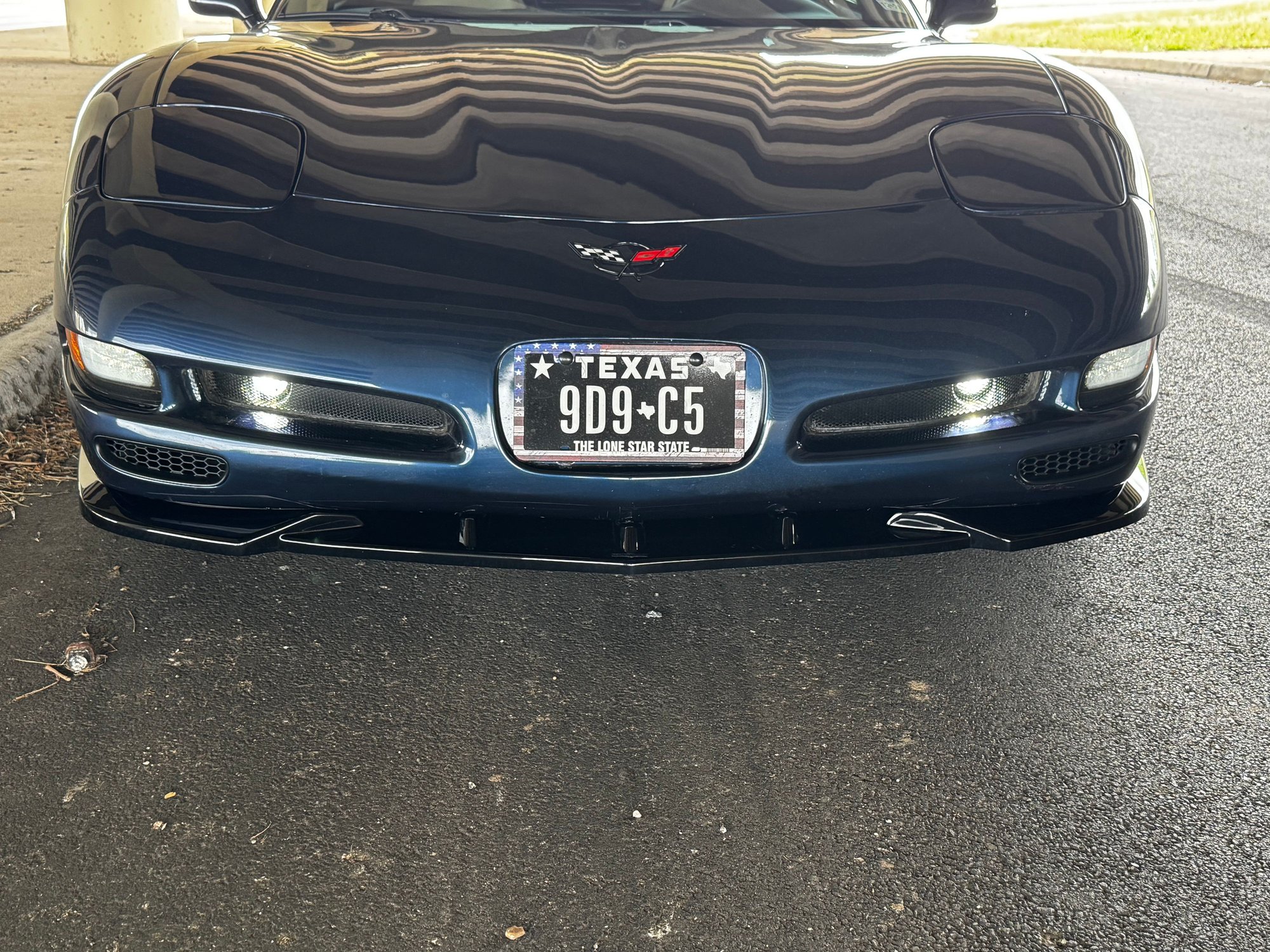

This is how it looks on mine

That looks really cool! But its not making any downforce. Great cosmetic piece though, and it seems to have solved issues others have.

Agreed, not much in the way of true downforce, but it sure looks cool...lol
I do feel like it helps create more flow into the center tunnel tho.

I like the Maxton and Carbon 7 splitters but I'm afraid neither would live very long, at my car's ride height.
That's a nice car you have, 9D9*C5. Is that a vert?

Thanks, yes convertible
