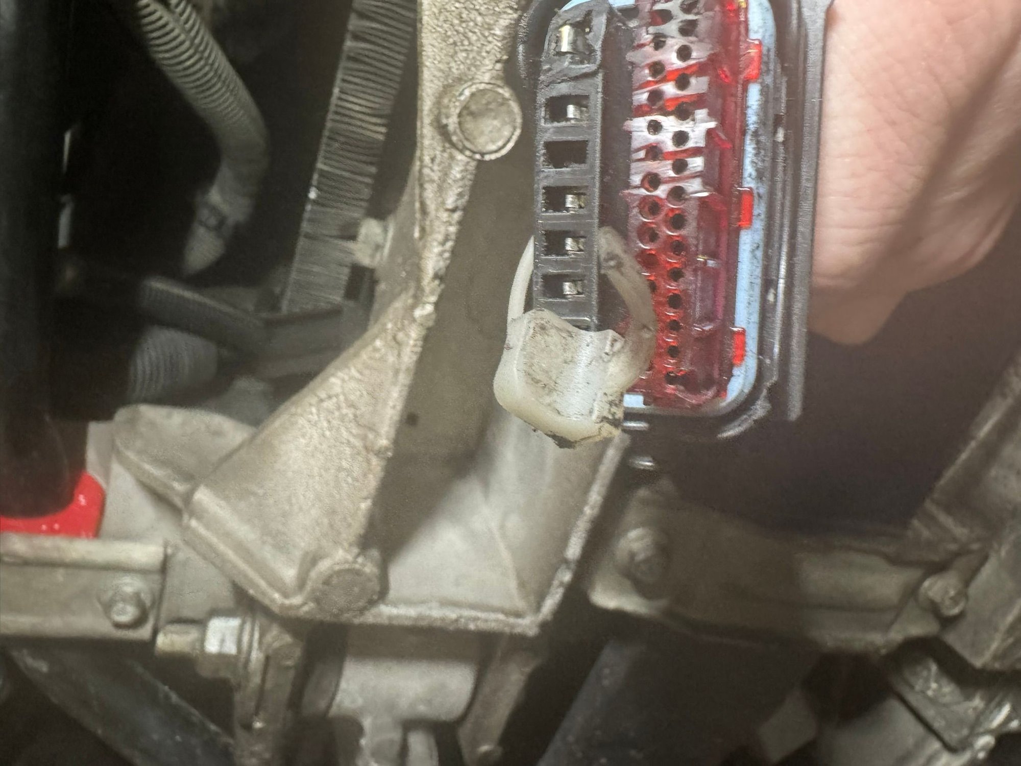

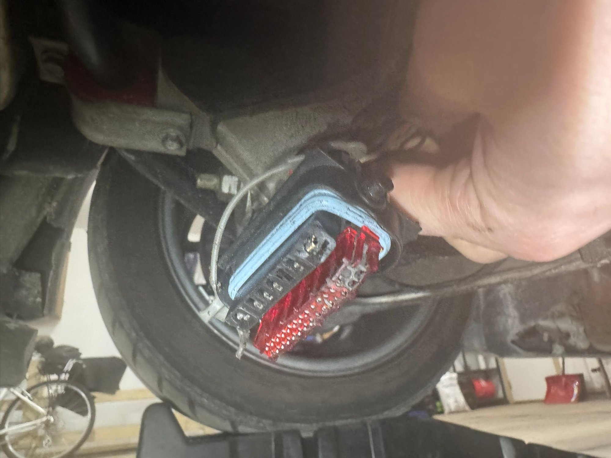

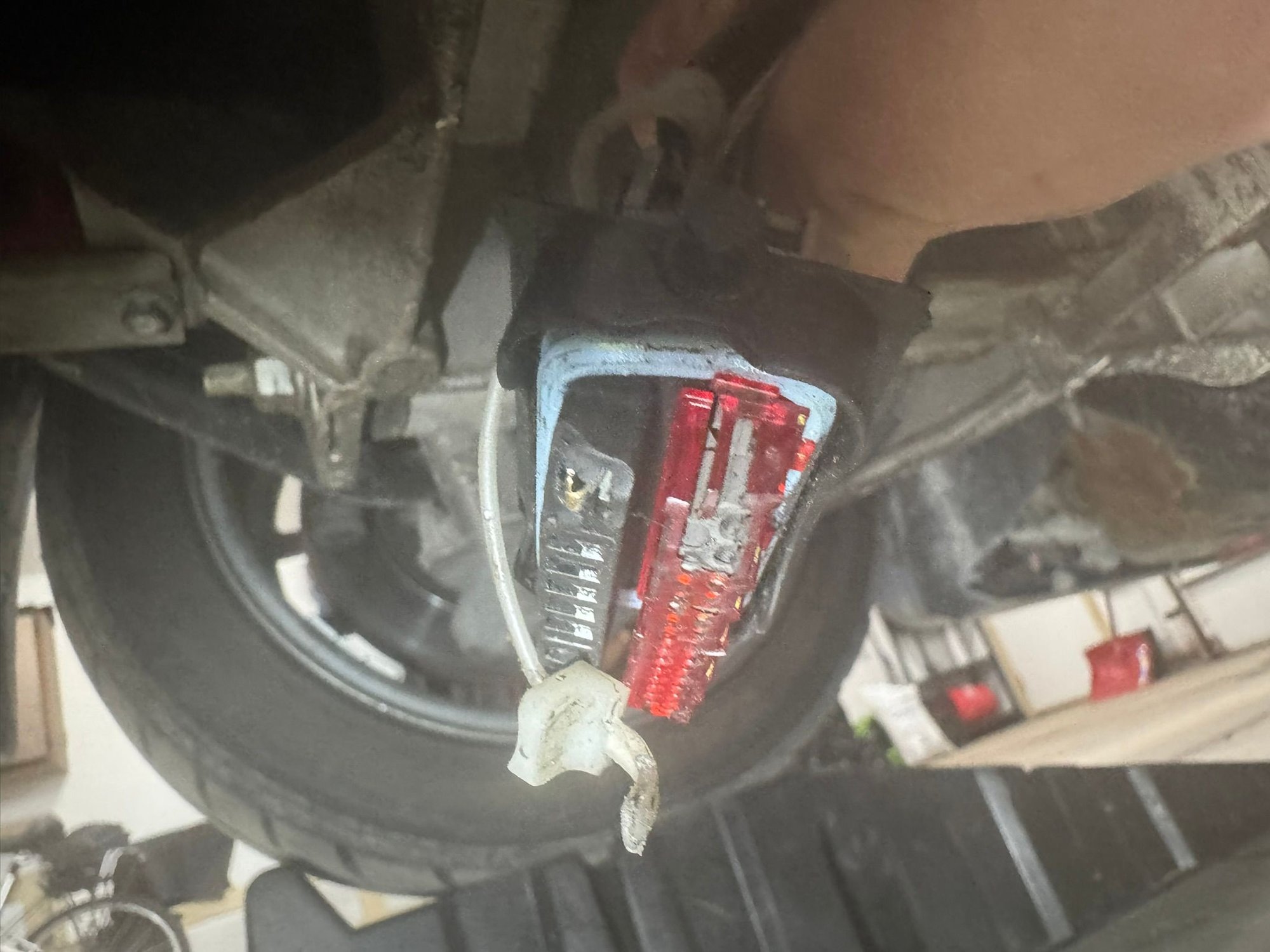

Some other details that may be pertinent. I have had at different times codes C1218, C1277, C1236. All of these have only showed up once and been cleared without issue. I also did at one point drive the car with the ABS plug disconnected and believe I may have damaged the end of the plug. Picture below. Feel free to call me an idiot for this, I am not convinced this is the root of my issues as it happened after I got the module back from Brandon, but I am open to feedback on what that could cause and how I could fix it. I also have not flushed the brake fluid recently, but again, my gut is telling me that won't make a difference.

I'm not certain it will fix your issue, but I would replace that plug either way. The C5 is very sensitive to electrical issues, and who knows what might happen if you have pins with intermittent connection issues. Even if it doesn't fix the current issue, it would still be worth doing.

Will do, just ordered a pigtail off Fleabay. I am going to try to repin the donor plug with the original harness and pins, rather than splicing 33 wires (or however many it is).
