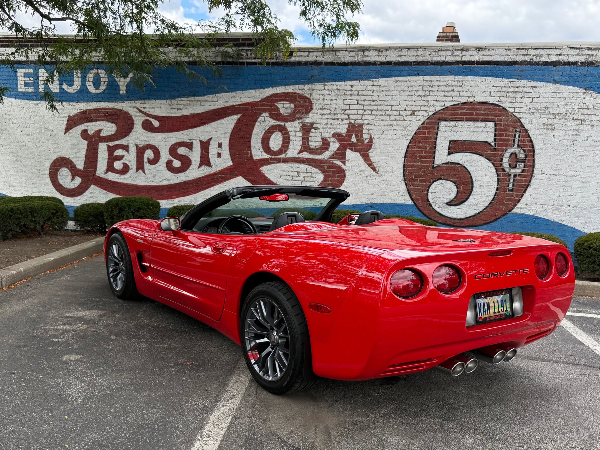

Old May 14, 2026 | 08:04 AM
hyperv6's Avatar
hyperv6
Joined: Mar 2023
Posts: 2,973
Likes: 1,711
From: North Coast

Originally Posted by hyperv6
Looks Great whats the size,offset and brand of your wheels? Thanks
Old May 14, 2026 | 11:53 AM
hyperv6's Avatar
hyperv6
Joined: Mar 2023
Posts: 2,973
Likes: 1,711
From: North Coast
They are OE wheels. They are a later Z06 style. Did Gunmetal as everyone does black and I hate Chrome.
I think this was the offset. I would have to look them up again.
18" 10.5 rear 56 offset 17" 9.5 54 offset front. Note this is from a poor memory.
I tried to keep with some side wall as the roads here would break wheels. I went wider to fill up the wells. I do not lower as the front scrapes enough and I carry NFL Hall of Fame players in the Pro Foot Ball parade in Canton and they lower the car even more.
https://www.summitracing.com/parts/o...ody/2-dr-coupe
Got the wheel from Summit Racing and also got the GM Jake caps from Summit.
Not many wheels out there I like anymore. I would love to have a set of the old BBS 3 piece wheels. They were some of the best and strongest wheels made. They are just in limited sizes now. Also $900 a wheel.
I just ordered a new set of Forged Fuchs for my 911 and they were just over a grand a wheel. Good wheels are not cheap anymore.
One more question,what tire size are you running? Thanks again for the reply.
Old May 15, 2026 | 09:13 AM
hyperv6's Avatar
hyperv6
Joined: Mar 2023
Posts: 2,973
Likes: 1,711
From: North Coast
I have 275-40-17 and 285-40-18 on my convertible and they work just fine.
I worked with some retired Goodyear engineer on the size I went with. One is the one who did the C5 Z06 testing.
Bigger is not always better. He warned the larger front tires would lead to less on center feel. It did. But nothing I can't live with. The Z06 size is just not easy to find anymore. Even the Goodyear guys have had to go to other tires as the sized they need are not available at Goodyear.
