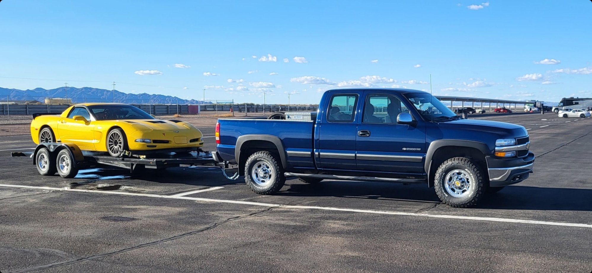

Any feedback is helpful! This is my first "forum" post too so I'll try and get a picture of the car here too lol

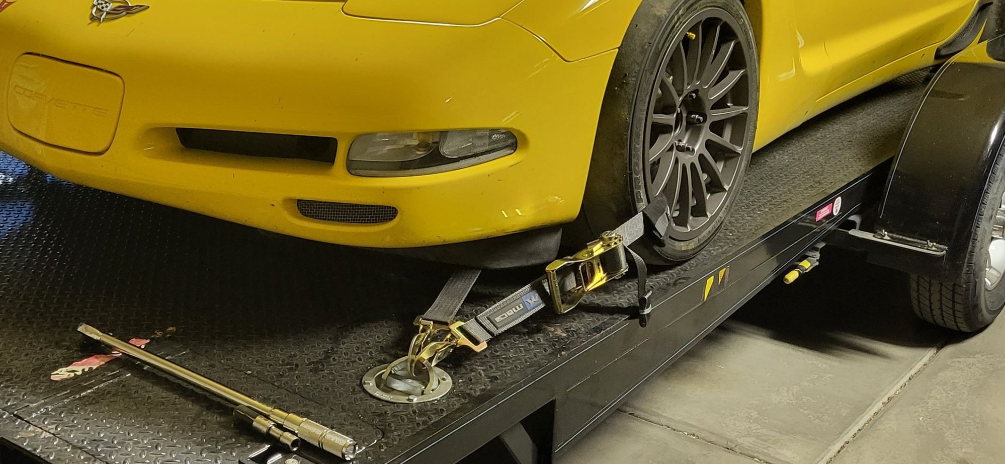

I use Mac's straps. Pricey but well worth it. If you're tracking the car you should have bolt-in pucks (ZL1 Addons) at your jacking points so using that location for strapping isn't an option. Hopefully your truck is robust enough for towing duties also. https://www.macscustomtiedowns.com/s...oaAnzXEALw_wcB
