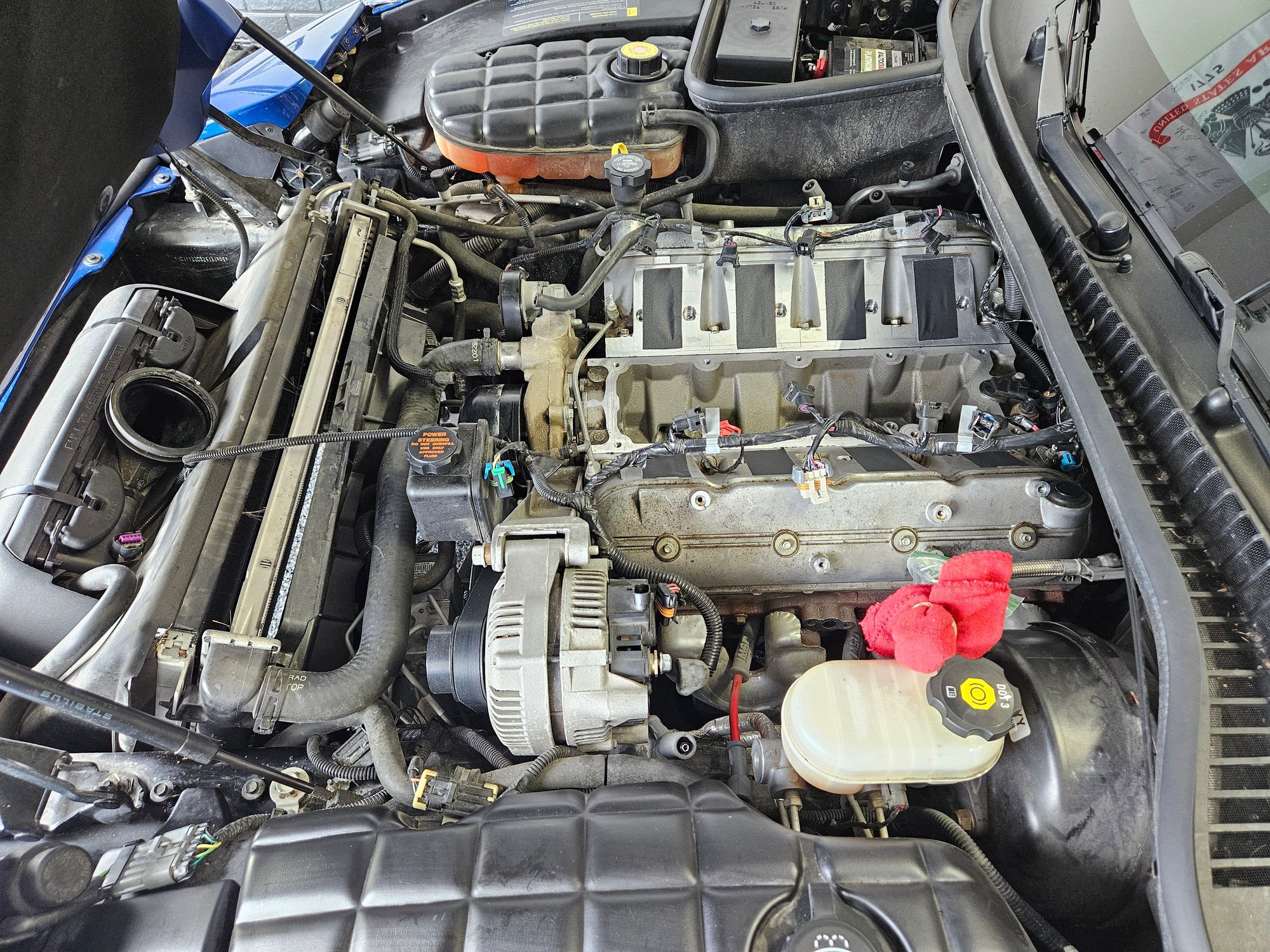

I noticed my LS1 PCV hoses on the intake were getting pretty dryrotted and cracked. So I did the only logical thing, and decided to throw a host of things at the car. LS6 valley cover, removed the AIR system, new knocks sensor and harness, relocating a new oil pressure sensor, four port steam vents, plugs, wires, Holley valve covers w/ LS3 coils, Blackwing, and probably something else or two I'm forgetting
Anyways, I'm waiting on some parts, so here's a tore open top end. I'll post some more as I go. Besides re-taping some loose wire loom and general cleaning, anything I should aim to tackle while I'm this far in?

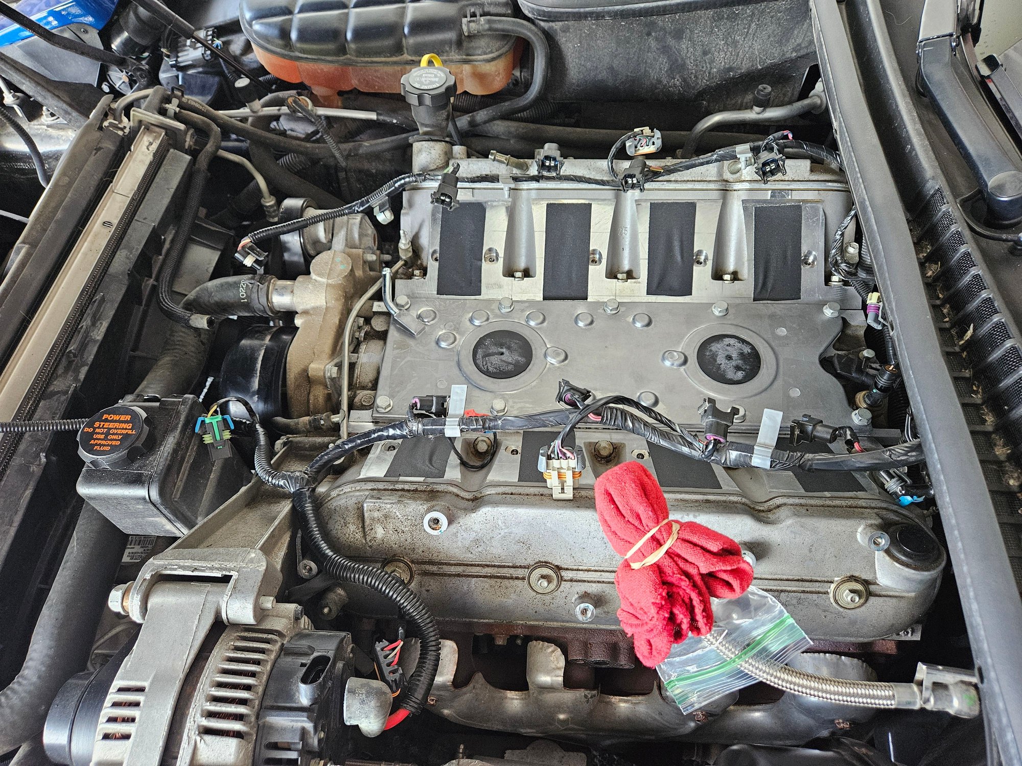

Valley cover installed and new knock sensors torqued to spec. Need to pop off the bottom driver side fender line to remove the AIR pump but that's tomorrow's problem. Rest of the parts arrive next week.

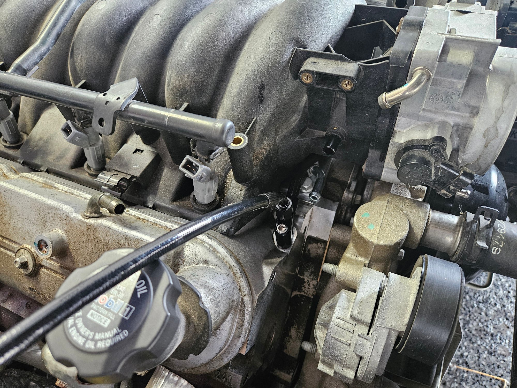

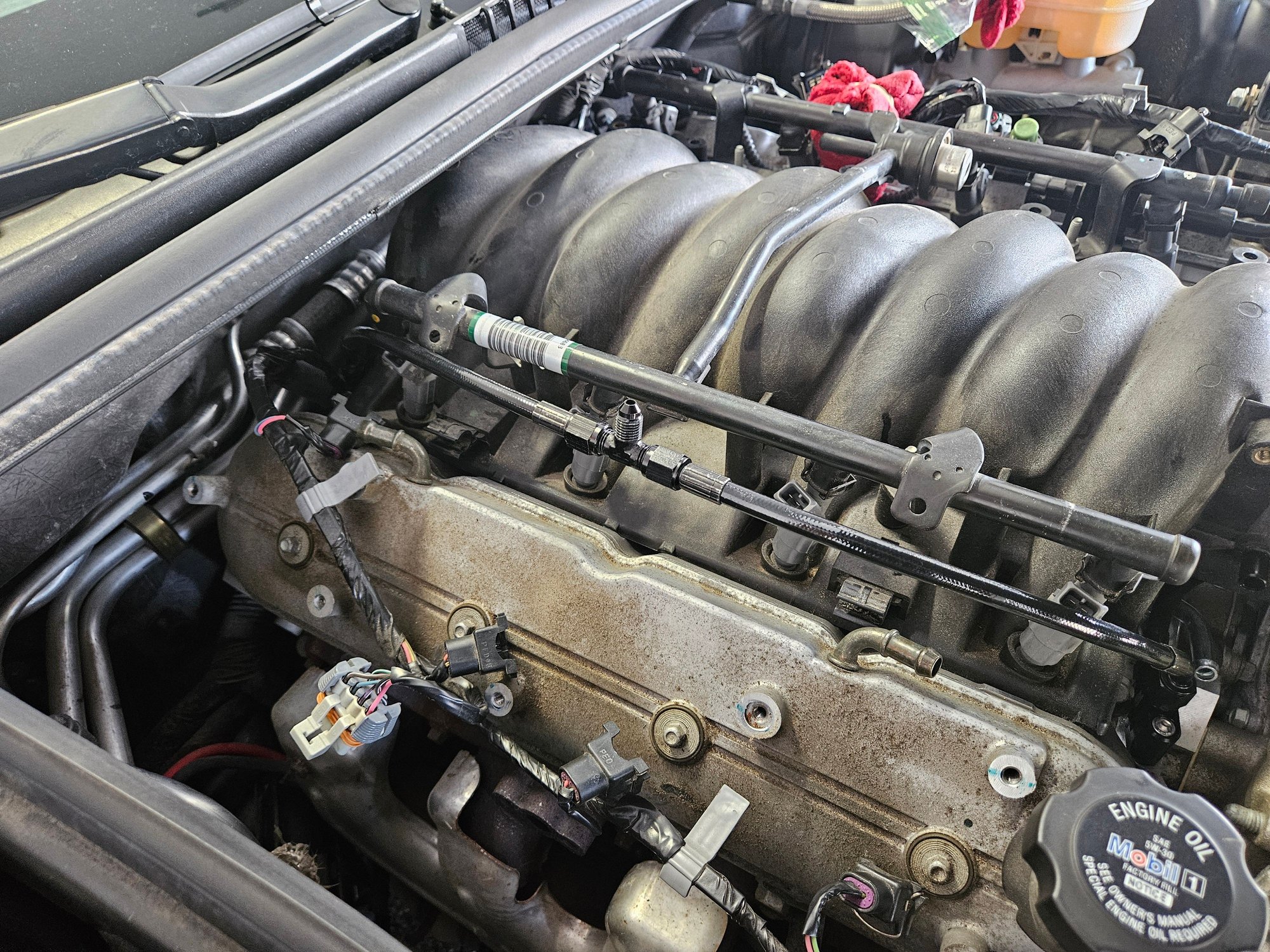

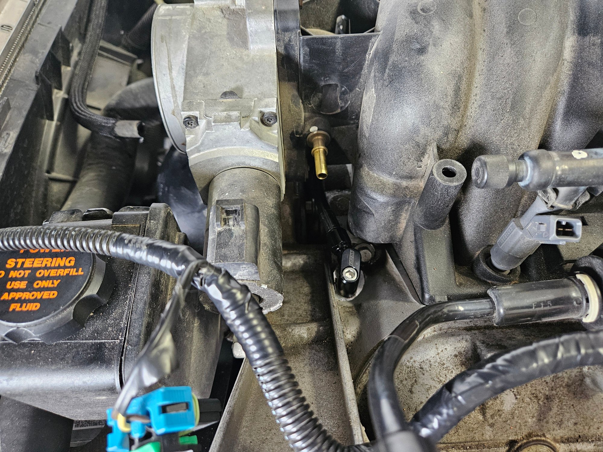

Started mocking up the four port kit. Looks like it'll just clear the LS6 valley cover! Its an ICT billet kit for those interested.

The steam vent kit is cleared. Either under or over the fuel injector connectors once its all buttoned up.

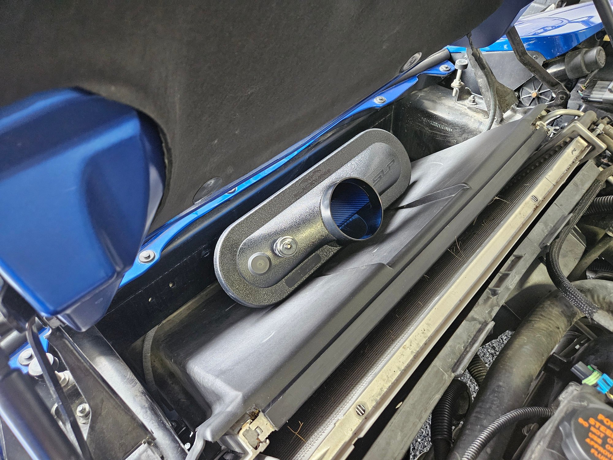

Scrap pile grows. AIR pump removed and stock airbox pulled off. I'll have an Z06 intake assembly for sale soon.

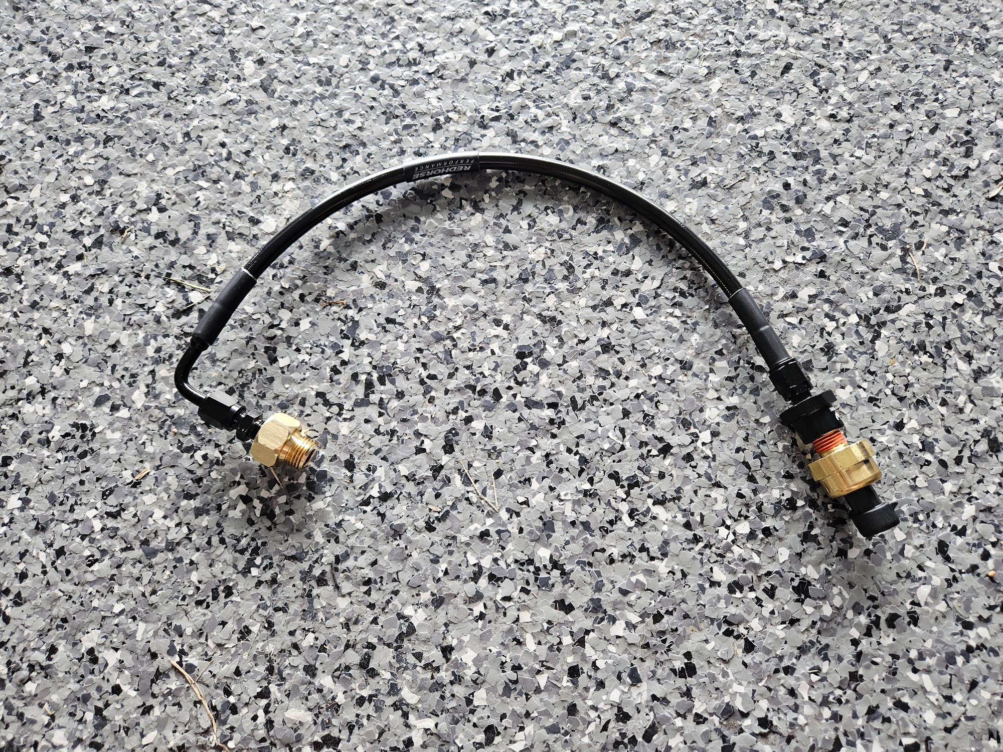

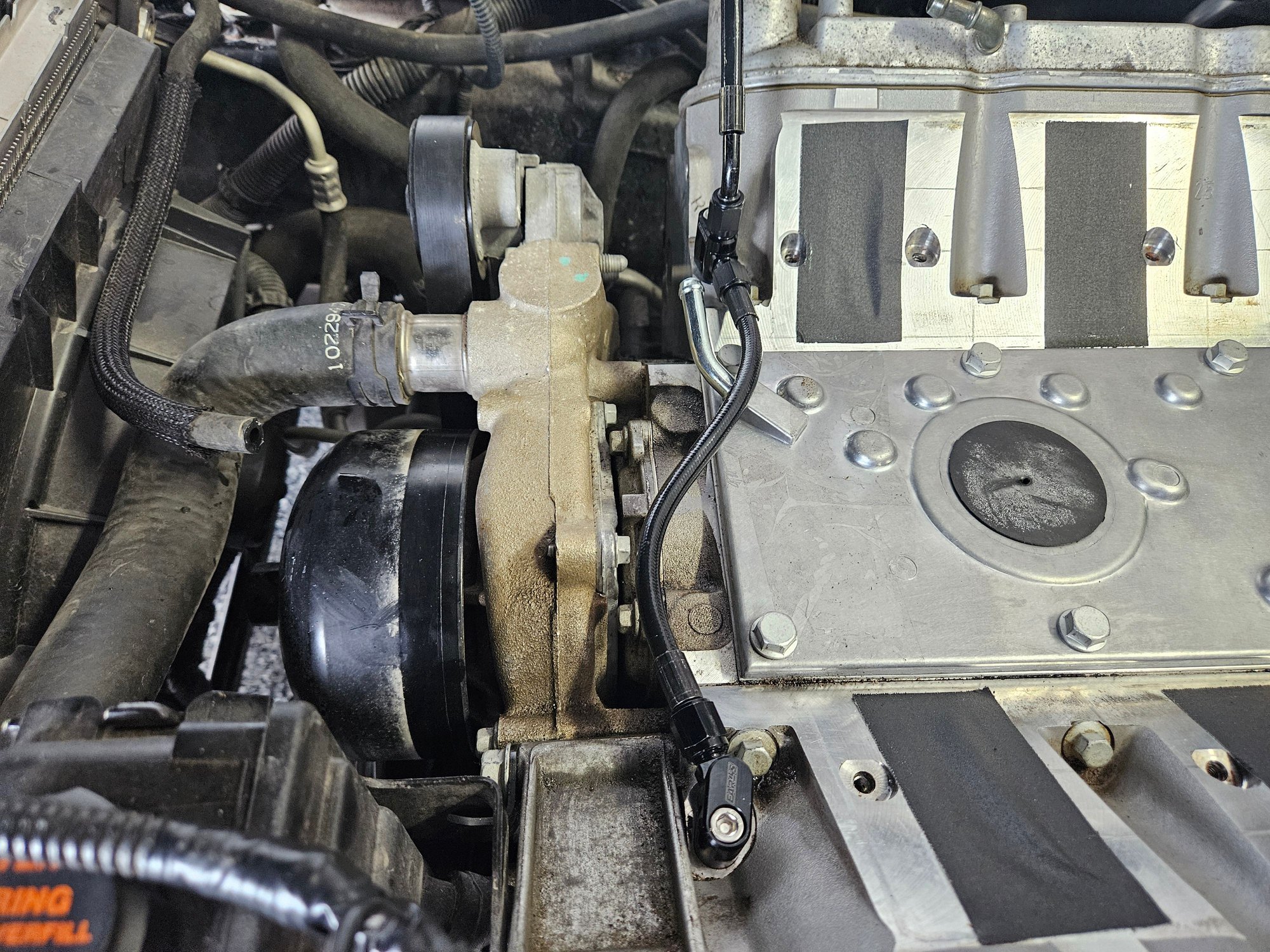

Here is the oil pressure sensor relocation mocked up. Hopefully no leaks lol

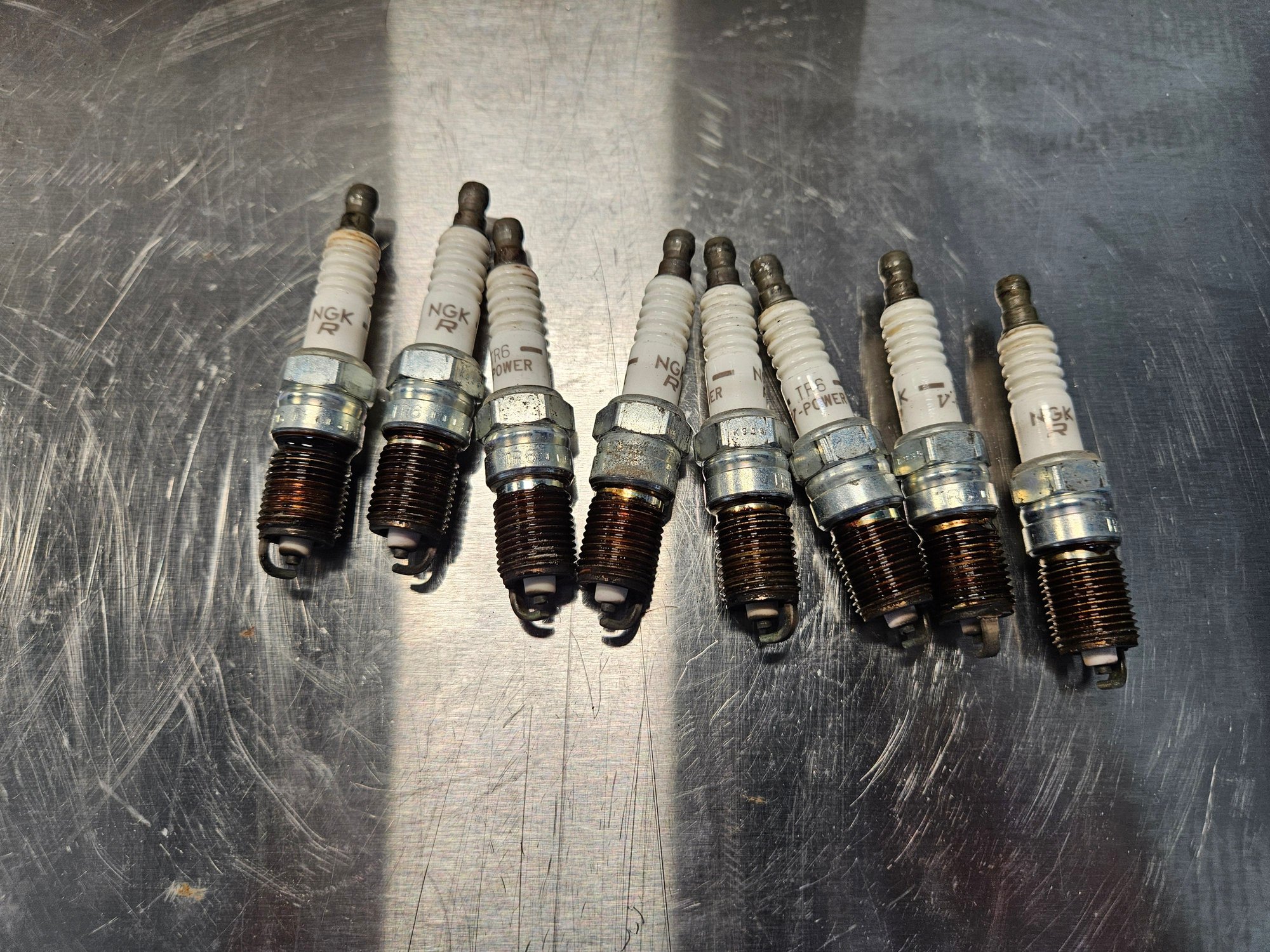

Old spark plugs pulled, new TR55s installed and torqued to spec. Little bit of oil on every plug, with cylinder #8 having the "most." I may add a catch can to the project.

Nice work so far. I had a Blackwing on my last two C5s as well as a catch can - everything worked fine.
