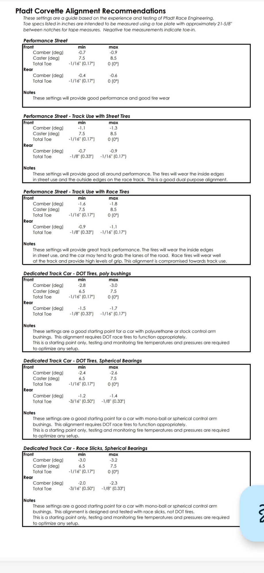

Can't go wrong using the Pfadt chart as a guide.
https://www.billswebspace.com/CorvetteAlignmentGuideRev20110912.pdf

Pfadt specs are a great place to start!
One note: Make sure the alignment shop sets the toe to 'IN', especially on the rear.
Their numbers might show a minus sign in front of the toe settings; every alignment machine I've ever seen shows toe in as a plus value.
Rear toe out will make the car very 'lively'.
Possibly pee-your-pants lively...
I recommend using a performance shop to do the work, rather than the $69.95 tire shop.
Find someone willing to take enough time to get the settings you ask for, and not just 'approximately'.
They should be pretty darned even side to side, and if they can't reach the numbers you want, they should be able to explain exactly why not.
In plain English...
Also have them do a thorough inspection of the suspension and steering beforehand.
"You can't align looseness!"
--Bob Leigh.
