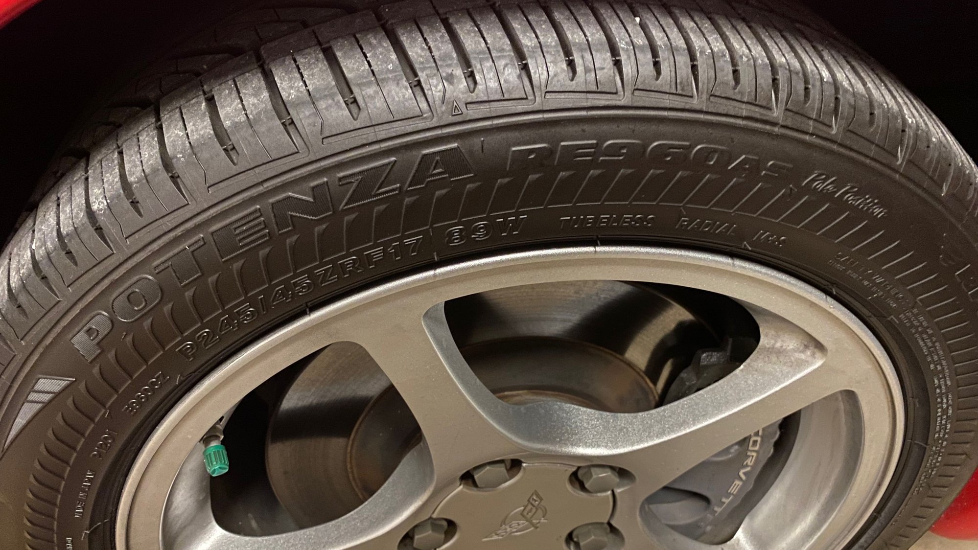

Trying to find out how old my tires are. I always thought it was supposed to be after the DOT code but no date seems to be at the end.

Looks like Made in Japan 12/01.

Some tire manufacturers put it only on one side. And if you don’t see it on the outside, it’ll be on the inside. Crack a beer, get the jack out and take the tire off. It will be 4 digits in an oval.
Forgot to add, it will be 2 digit week followed by 2 digit year. (3808) would be 38th week of 2008.

Not seeing it in that pic, maybe on the part not shown.
As stated, 4 digits week and year.
