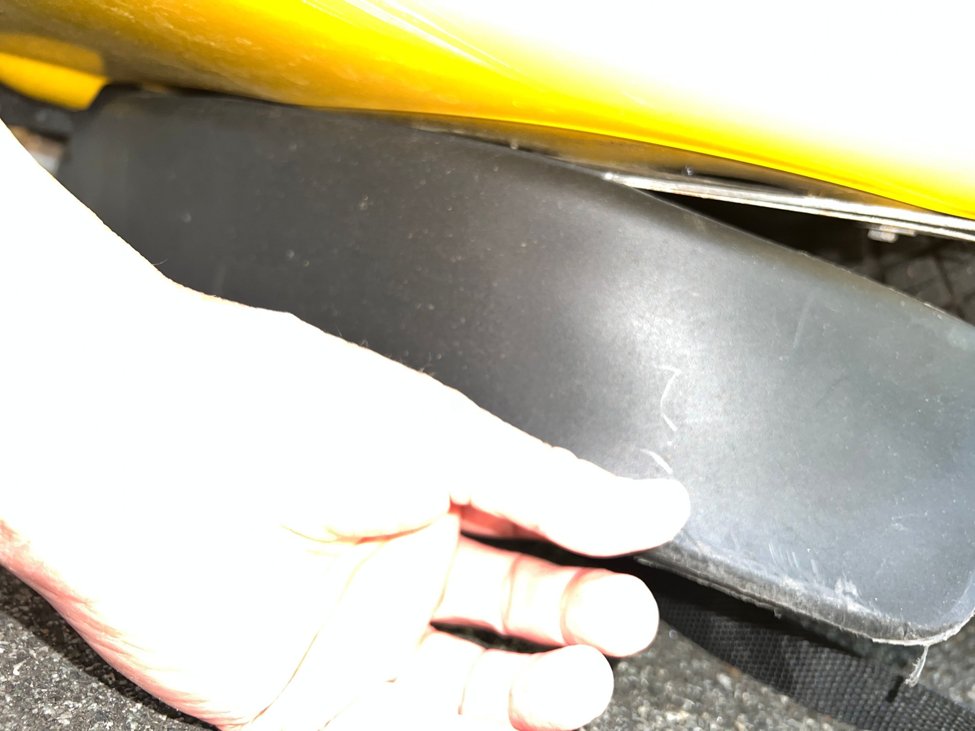

hi folks, when I got my latest C5 in October, the existing air dam was in bad shape and parts were missing. I replaced it with a brand new one and everything seemed fine until I noticed the driver side one was sort of hanging down partially. Turns out that the outer 6 inches tour away from the mounting part. I’m fairly sure this is not gonna be fixable. however I was wondering if anyone has run with just the center dam?

I've never tried that, but the center section is definitely the most important since that's what directs air up to the intake.
I'm not sure I'd totally give up on fixing it though. Did the screws rip out of the air dam, or did they rip out of the front fascia? I have ideas for fixing both. (Pics would help though, just to see exactly what you're dealing with)

Thanks guys. Unfortunately, the problem has nothing to do with the mounting screws. The actual plastic is torn as you can see in the photos. I need to remove it in order to see if there’s a way that I can fix it. I’m not sure what kind of plastic repair magic I can do with this thing that will stop it from tearing loose. The next time I hit a High spot. I greatly prefer to have these things mounted since I know that these cars are strong bottom feeders.

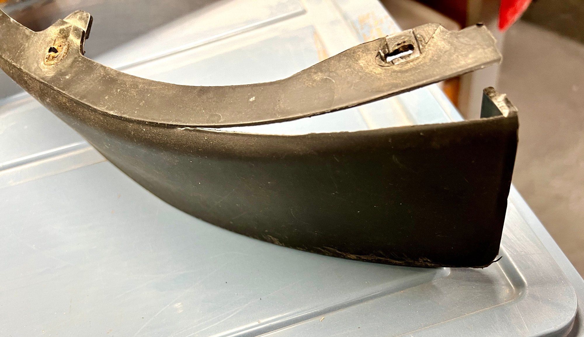

Here’s the culprit. I can think of a few ways to fix it but will it remain fixed when I hit the next speed bump

You can "melt Stitch" it together with a soldering iron and melt/add plastic to the inside corner to reinforce it if you're really handy and want to attempt it. Lots of Youtube vids showing plastic repair with a soldering iron.
