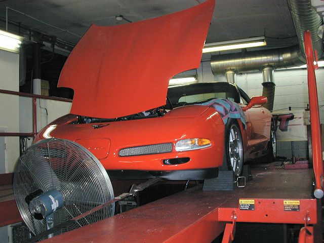

Mine's been strapped at least a few times and I do my own tuning. Proper tuning requires both dyno data and street/strip data. Things change on the road in the real world.
