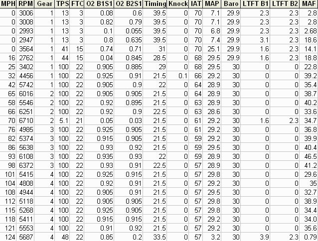

Your MPH is low and the ETs are a little disappointing for those 60' times. That could be due to the weather or your driving. What was the DA?
Make sure you wind out as close to redline as possible. You should be able to get a better 60' time if you put enough heat into the tires. You might want to remove that Predator program and run with the stock program. If you want to run with the Predator programmer get yourself a real data logging scanner and log the following to a file while making a pass -> MPH, RPM, TPS, Fuel trim cell, OSB1S1, O2B2S1, Timing, Knock, LTFT1, LTFT2, MAF, IAT (optional), MAP (optional), BARO (optional). You should end up with something like this:

Don't short shift. I am well into fourth when I cross the line at about 117-118 MPH. See my data chart above.

Don't short shift.
Do not short shift, Small Block Chevrolet engines make their horsepower at higher R.P.M.'s, use all that you can.
