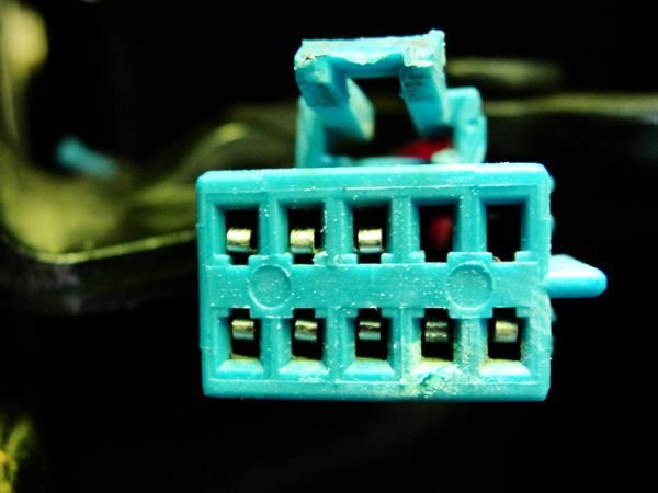

I noticed a few days ago that my window stopped working... then noticed when someone got out and slammed the door it started working again... figured it was a loose connection and didn't worry about it at the moment... today I put the window down to back out of the garage and now it wont go back up. I noticed neither window control on lock control are working on the pass side. also not lighting up when I turn on the lights.. all connections are tight... anyone have any suggestions or idea what could be causing this? Thanks!

i had the same problem with the passenger door not long ago until i reconnected the connector in the door. I cleaned it as good as i could with a Q-tip and some alcohol. It was very difficult to disconnect, i used 2 screw drivers, one to jam into the lock and the other to pry it apart.
