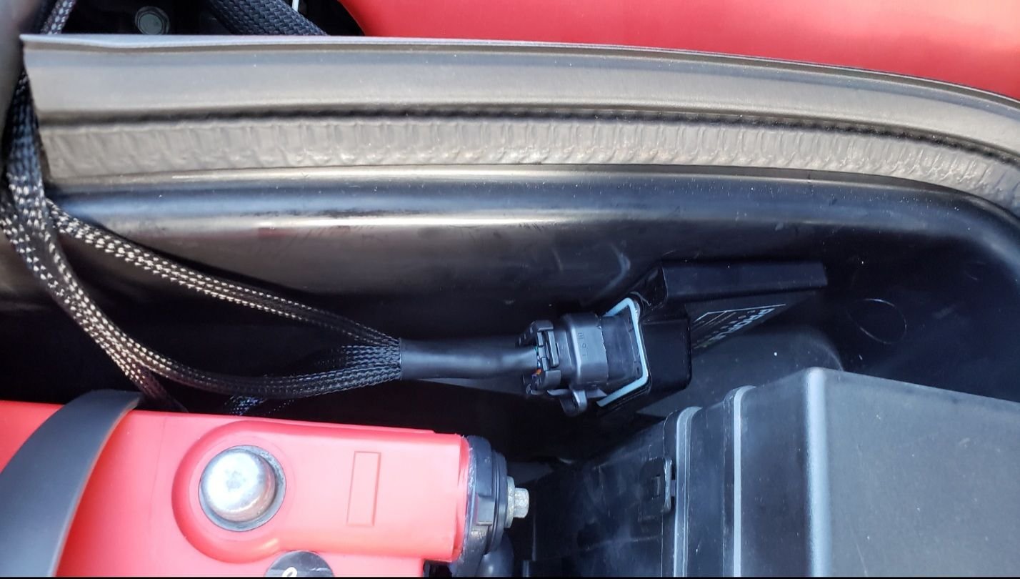

Default ProFlex Commander Performance E85 Flex Fuel System
Installed my ProFlex E85 System Today
Fuel lines installed
ProFlex Computer installed
Looking Good Runs Great

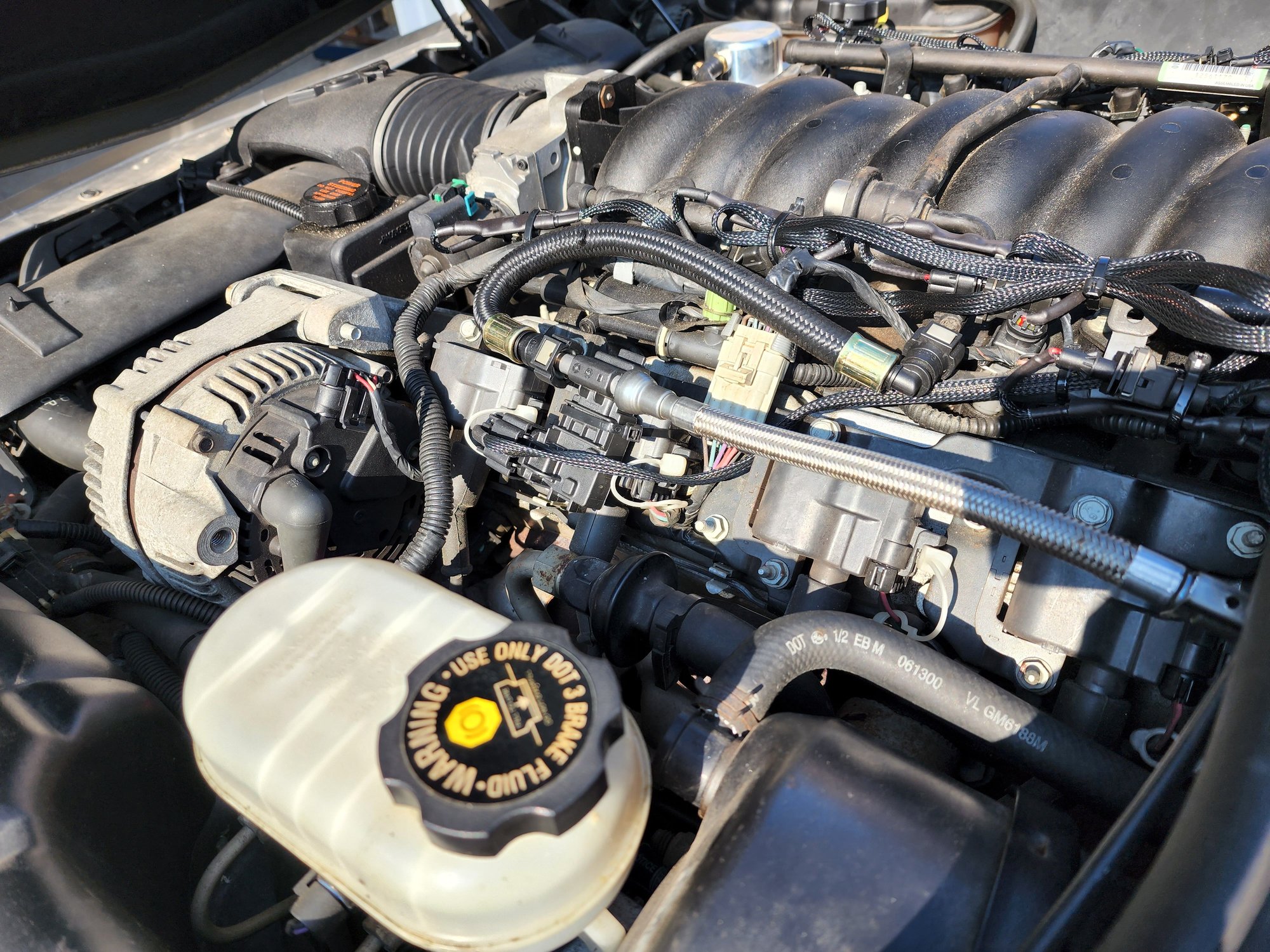

Yes how do u like 4 feet of hose on your fuel line ? Apparently they didn’t get the hint yet to include a double female 1 inch to adapt from yet...And I still haven’t got mine as promised ...
Overall how do you like it ? I got the pro option and I love it ....I run full e85
Are those zip ties the power adding kind

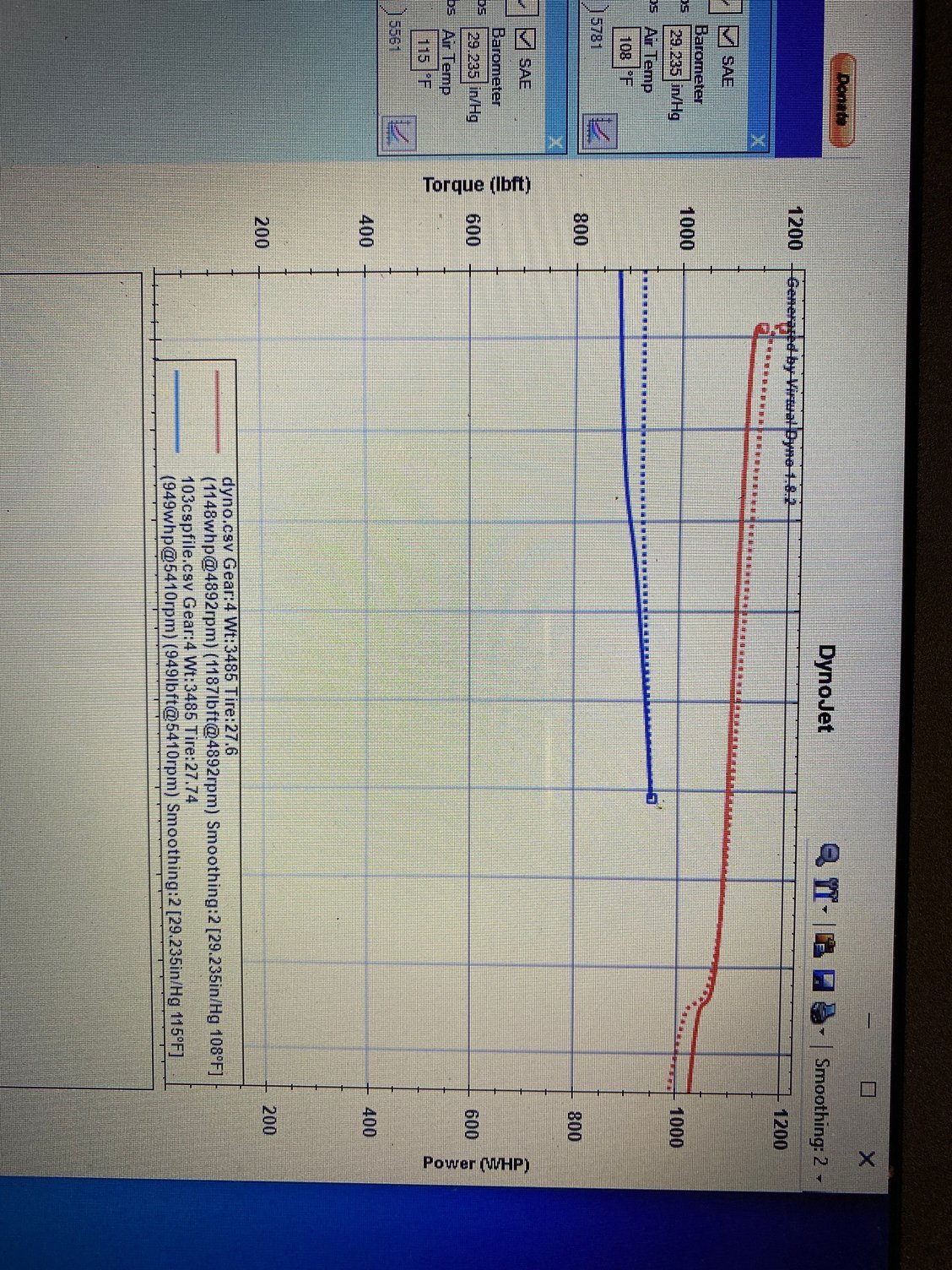

I have dyno support to 1349 before the dyno is unable to log power estimate total 1489 to 1535
So everything from 1349 at 5300 ish to 7100 wasn’t captured all we could see was the spike was still climbing....through the tuneing side of the log power didn’t show its drop or dip or some say as flattening power point where the cam had no more to offer ...we never saw this flat dipping point
Tapping out those size injectors based off my duty cycle is only bxt 16& 19 % I’m only using a 255 58psi jet pump hot wired with a #700 wire kit ...haven’t come close to maximum fuel flow just ran out of engine and boost to make anything more ....Just a side note I had bought a boost a pump as well figuring al the war stories about e85 ...it was best to be prepared...2 years later it has remains in the box and package not opened....so just I dont see where someone is properly using 127 lbs to really 133lbs of fuel per/h given its running at 58psi ...I used all imperial work not metric or the other one in there maybe the break down helps can’t speak for how others have tuned just myself

You're claiming 1349 whp with 60lb injectors? Are you using 16 of them? I'm assuming that is a typo.
Twin Walbro 255 pumps hardwired tap out around 1000whp on E85 at the quoted fuel pressures you are stating (and that is pushing it), even less if you have a bottleneck in the supply line, voltage drop, need additional fueling due to poor cooling, or are running higher than the 58psi baseline (assuming you are boosted).
What's the motor and induction setup?
Maybe you're just trolling. Keep that crap to Facebook then.

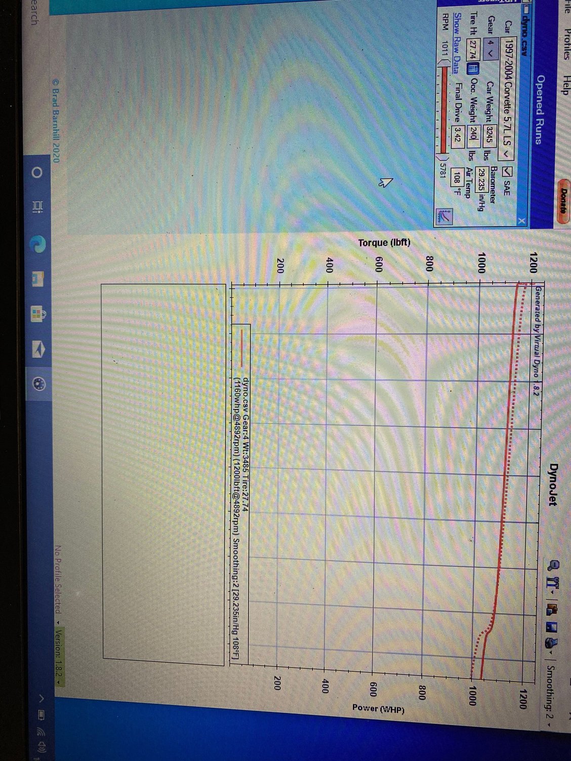

Nah I just run a stock N/A 346 at that power
Round 1
R-2 I wasn’t getting down really
& let me just say say & it never busted into speed density until u climb down low on it real hard so ....for me it’s as easy as hitting a reset to back it out of blow off your doors density....kinda like a on the spot reflash/ turbo mode lol Terminal X mode :vader:
Lol could be twin 255’’s hot wired in hahah u know my boys at the shop take care of me we’ve prob hit 58psi and above hahah that’s why my tuner just gave up couldn’t get past proflex....and I had to actually solve most of the idle stuffs I’m sure they did their part and Like I said were only tapping 16& 19 % duty cycle .....prob I am assuming 3 bar maybe 3.5 bar FuelRewards hahah ...Prob need to get a 5 bar map something able to scale 2bar to 5bar
Finally the night Ryder actually points out why the car is able to fuel it something that a newbie has brought to the attention of those who were alongside the build from the get years ago this guy pointed out right off the wack lol two thumbs up ...

Default ProFlex review
Been running E85 since installing the ProFlex kit on my mostly stock Z. I run a 93 Octane Diablo Diablew tune and full E85. I haven't had any problems at all with this kit took me 30 min to install. I think they did a great job designing this for the c5. This is my fun nice weather car so it took about 2 weeks to get to the full 85% ( $1.58 per gal ) My Z is only street driven no drags no racetrack just fun driving on nice days. One word would be AWESOME Night and Day difference to me. instant power and traction reducer add on kit.
E85 Fuel lines
