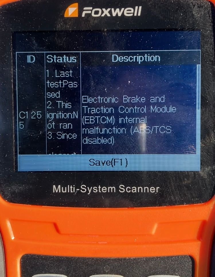

So I’ve been searching for repairs for my C1255 code and it seems that options are to wait for a 20 year old used unit to come up for $1500 or live with it.
Can abs and TC be permanently coded out?
I’ve looked around and googled it but no one really mentions it as an option. Is it even possible?

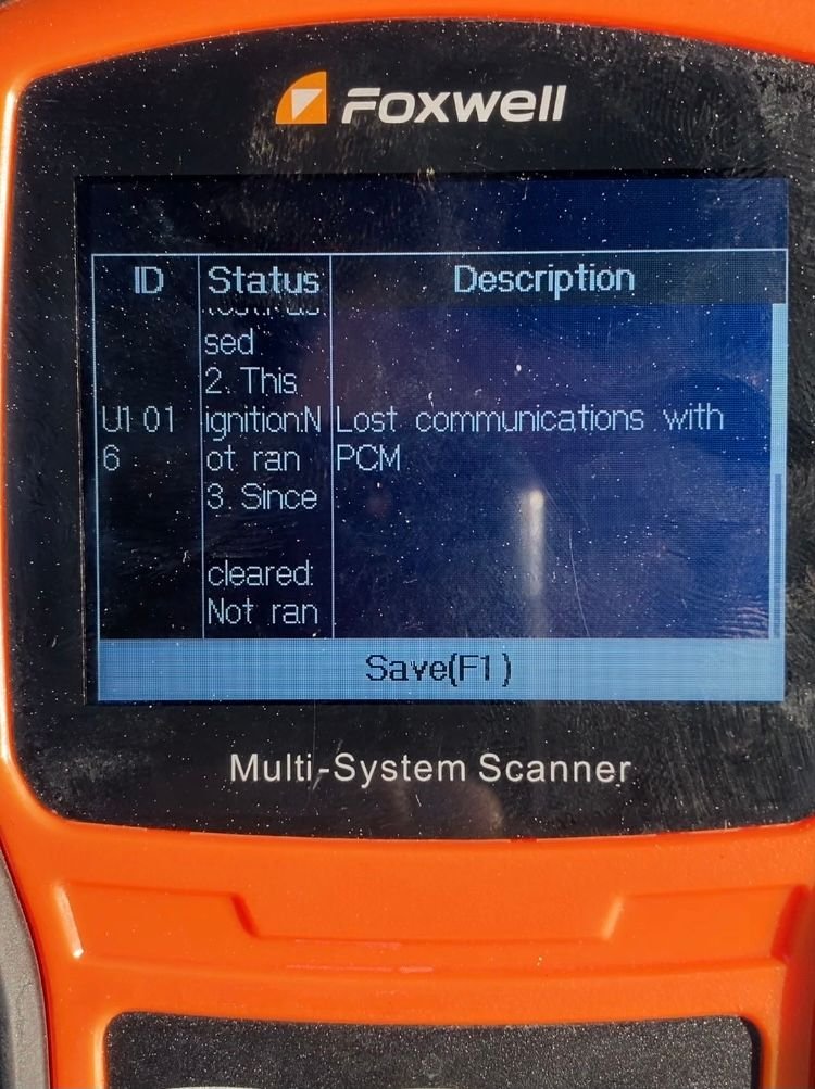

I have a foxwell 530 that ha GM software, code C1255 is what comes up. Service abs and traction control on messages screen. Looking to get rid of messages and lights in cluster.

Old Jan 17, 2021 | 05:08 PM
knockingdiesel's Avatar
knockingdiesel
Joined: Jan 2021
Posts: 89
Likes: 68
From: Albuquerque, NM
these were the codes, abs and T/C light are on the dash as well.
