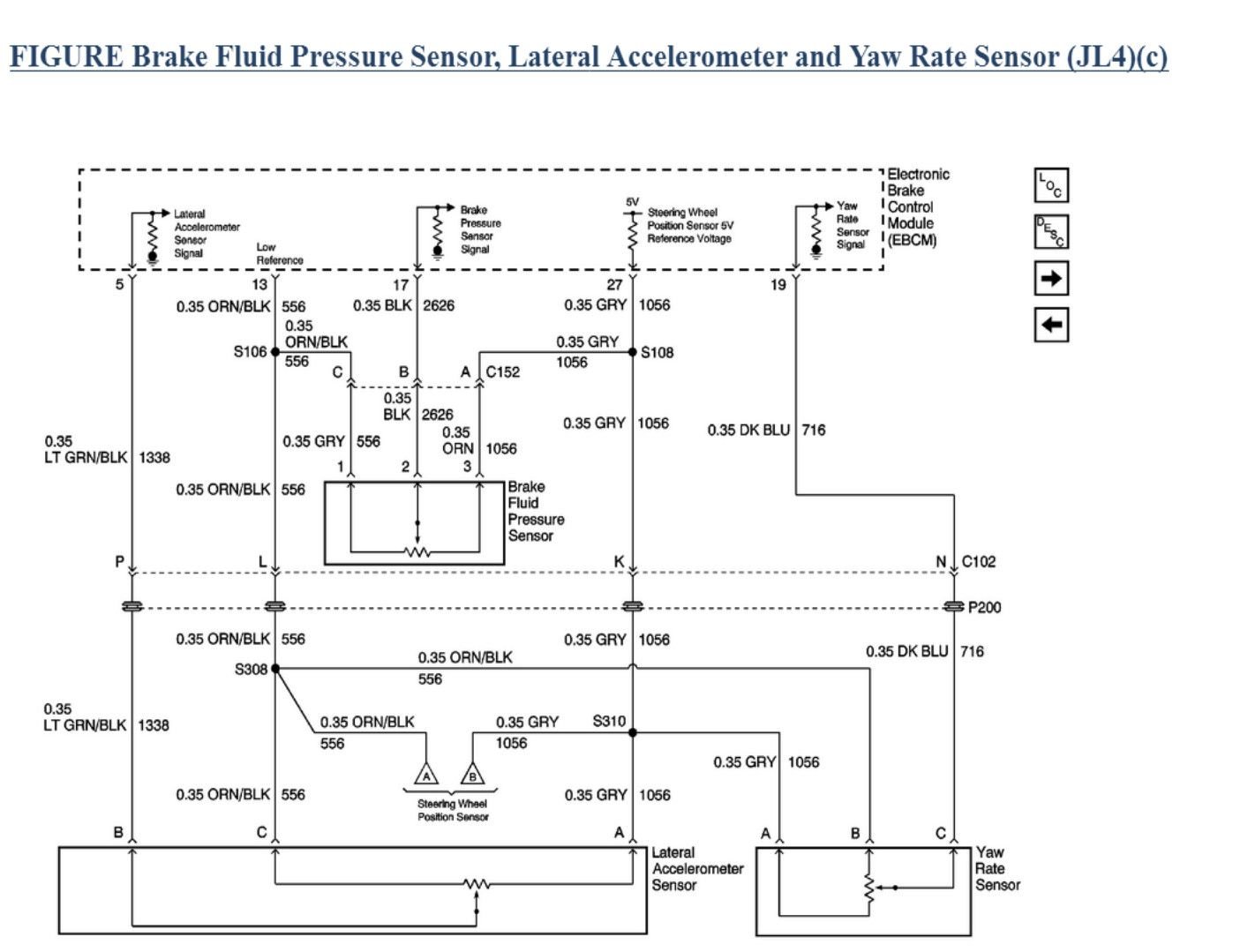

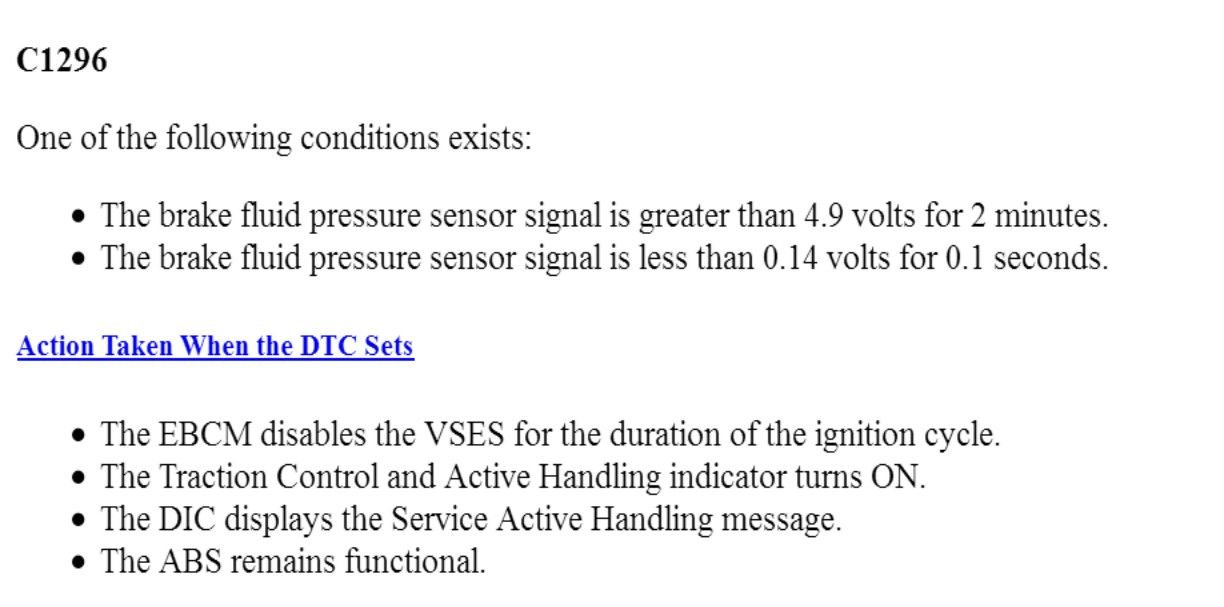

It seems like your brake pressure sensor signal is to high or to low .
If you have a scantool you can check signal value on the scanner .
If not you can use a multimeter and measure the voltage between terminal 13 and 17 on the EBCTM like the schematic shows
