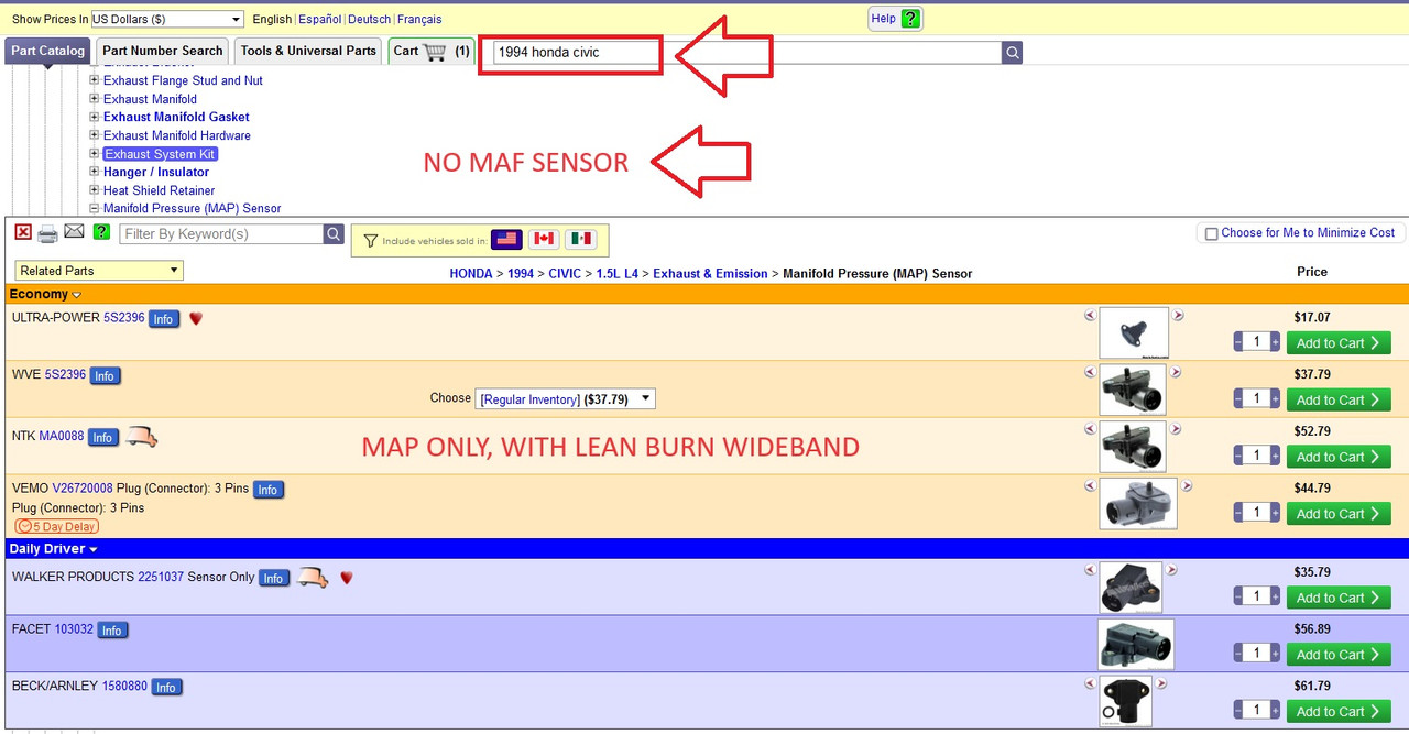

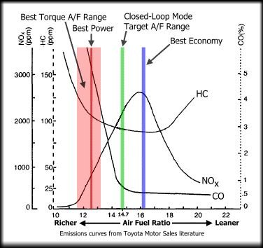

Sorry you have no idea what you are talking about. The graph I shared is from my wideband obviously. And it is common tuning practice to tune 16:1 air fuel ratio we've done it to all vehicels 1,000+ since the 90's in 4 6 8 10 cylinder applications for 25 years of service 350,000 miles.
https://forums.holley.com/forum/holl...424#post384424
Holley Admin
AFR: I idle @ 14.2 AFR, cruise @ 16.0 AFR, WOT @ 12.6/12.8 AFR.
https://forums.holley.com/forum/holl...4654#post84654
Even the OEM Manufacturers are doing it since the 80's in lean burn engines
Actual science
It isn't *my* method lol. It is how the entire aftermarket ECU world tunes their engines for max efficiency.
I've been tuning since the 90s Its always been done this way. Every car. Every application. Only fools use narrowband air fuel ratios in performance applications.
Time to grow up. Everything you know is wrong.

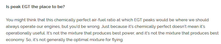

Educate yourselves please I am tired of pretend wana be knowit alls copy and pasting each other bad information. You don't know !@#$ and cant be bothered to search and read shame on you.
Is peak EGT the place to be?
You might think that this chemically perfect air-fuel ratio at which EGT peaks would be where we should always operate our engines, but you’d be wrong. Just because it’s chemically perfect doesn’t mean it’s operationally useful. It’s not the mixture that produces best power, and it’s not the mixture that produces best economy. So, it’s not generally the optimal mixture for flying.
For best power, you need an air-fuel ratio of about 12.5-to-1, quite a bit richer than stoichiometric, which occurs at about 100 to 125 degrees F rich of peak. This rich mixture burns somewhat dirty (due to unburned hydrocarbons), but it also burns faster which yields a bit more power. For full-power takeoffs, we use an even richer mixture for increased detonation margin.
For best economy, you need an air-fuel ratio of about 16-to-1 , quite a bit leaner than stoichiometric and so significantly lean of peak. Such a lean mixture burns very clean and reduces combustion pressure and temperature, which is great for engine longevity but at the sacrifice of some power and airspeed.
https://www.aopa.org/news-and-media/...aintenance-egt
READ
