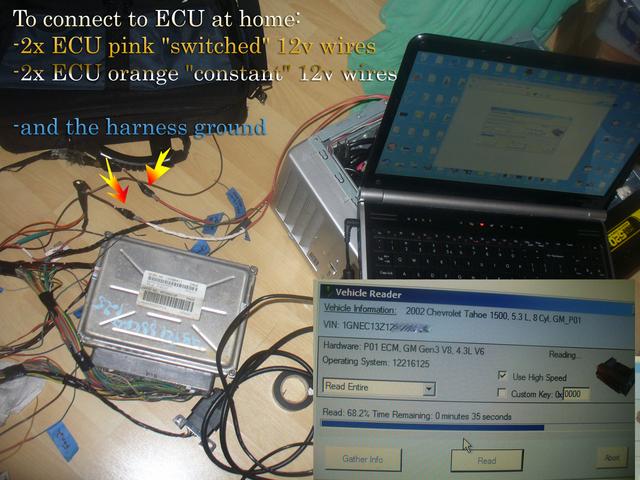

As long as the car's wiring harness is still intact, I'd expect reading to work just fine. As noted earlier, you don't need to crank, you just need to turn the key to the run position.
The power supply on that bench harness might not be sufficient for writing, but it will work just fine for reading. Some of the 99-03 PCMs (the ones with Intel flash chips) will pull about 0.7 amps when erasing a section of the flash chip, and a weak power supply will let voltage dip low enough to cause the PCM to reboot... after which it won't boot, because a section of the flash just got erased. You can recover from that, but it's tedious and you'll need a stronger power supply.

The ECU only needs power to switched, constant, plus ground to boot and connect to a laptop
Switched and constant and ground for this purpose are each just 'one wire' making the total a 3 wires needed for power,
plus the couple wires for communication which is the plug for HPtuners device

FWIW, I don't even use a switch, I just tied both power inputs directly to the power supply.

Thanks all for the advise. I ended up getting that harness on amazon. Which port do I plug it into there are two identical looking connections. Or does it not matter?
Old Jun 21, 2025 | 12:42 AM
NSFW's Avatar
NSFW
Joined: Nov 2017
Posts: 1,392
Likes: 303
It matters, but I think you'll find that it only fits one of them.
On the car's wiring harness, the connectors have colored plastic clips that have ridges in different places to ensure that they can only be installed correctly.
99-03 cars have red and blue clips.
04 cars have green and blue.
The programming harness will probably come with blue clips.
The top of the PCM has the word "BLUE" embossed on it to indicate which connector fits the blue clips.
