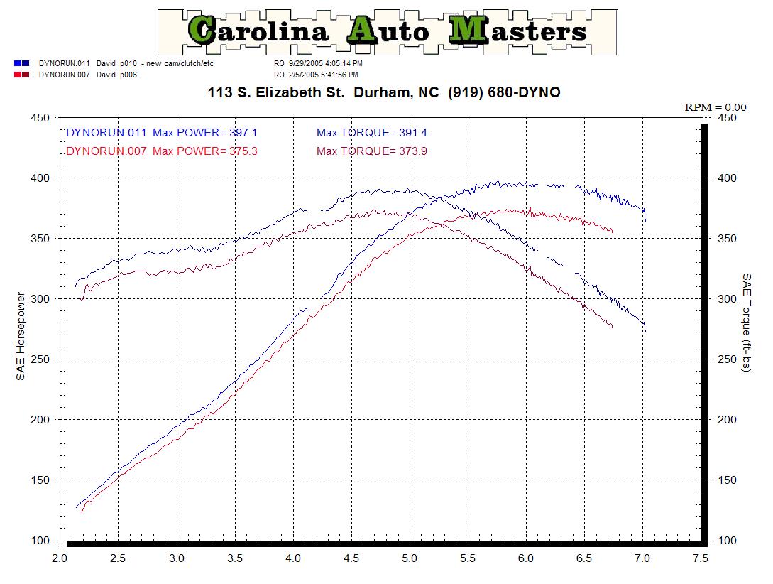

New mods are a OZZ700 clutch, with DTE brace, and hardened output shafts, both sides. Love the clutch!!! I didn't realize how bad my OEM was untill tonight at the track and I cut my 1st 1.5 60' but more later on that...
Jeff also installed a 224 227 114 (see sig for cam specs) cam and we went with big dual comp springs, retainers ect... He also installed an ASP underive pulley, and a Shaner TB while we where at it, and an electric water pump (and yes it does idle 10 degrees cooler and it looks great). I wanted more sound too so we swapped out stingers for quad bullets and they sound
Jeff worked his LS1 magic and we settled on 398 RWHP and 391 RWT. The car gained 23 hp and 24 ft lbs through the range. There are a few things that kept us a few HP low IMO, like my 6 month old gas, and the muggy NC conditions yesterday, plus this blower cam is not peakey NA. Here is the graph:
