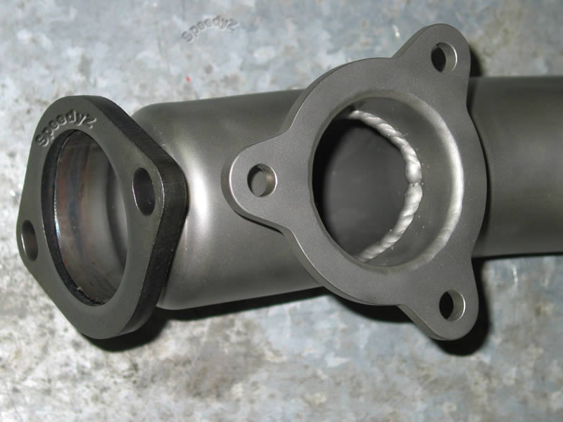

I installed mine like Patches (but I think my welding looks better ). These are 2.5" McCord cutouts on a 3" LG X-pipe just before the cat back (with DTE brace). I used all stainless pipe and even had to make my own stainless flanges. My theory on this is when you dump through two 2.5" holes and out through the factory cat back, its going to be pretty close to open exhaust. I have no idea how much gain these will give (someday I will find out when on a dyno) but I can tell you a LOT of noisy comes out those two 2.5" holes! A big cam, 11:1 and open exhaust sure does make some awesome rice intimidating racket!
BTW: If you don't have a diff. brace and think you will ever get one, install it before you do your cutout if you put then under the trans or you will be redoing them!

I Like the embossed "SpeedyZ". Must have cost mucho mula
Hey Speedy, you're my inspiration for this project! I saw your post a while back and have been working on getting the parts together. I'm getting the DTE brace installed at the same time. I'm going with QTP though because I could not get McCord to answer the phone or call me back.
I should have contracted with you to make the pipes!
Thanks for the inspiration. Imitation is the sincerest form of flattery!

Looks great speedy! I'm gonna have to find a shop to do all the welding work and hope that it's gonna look just as nice Or I could pay you to make me exact same setup when I decide to get it?
I think even if it doesn't give a full potential of an aftermarket exhaust, it couldn't be rubbing more than 5hp, and I could deal with it knowing that my head will not be be hurting on a long trips and neighbors won't be complaning

Thanks for the complements guys! That was actually my first time TIG welding. I had done lots of welding before just never on a TIG. The guy showed me how and said "lock the door when you leave" and took off. I have since got my own TIG and have done a lot of TIG welding and due to little help from a old pro I'm getting fairly good at it! This project was time consuming, grinding and machining everything to fit perfectly, then welding everything on the inside. Everything you see is bare stainless steel, no paint or any finish. When done I simply blasted the pipes with glass beads so everything would be the same color.

very neat work. and I like your own trademarks
