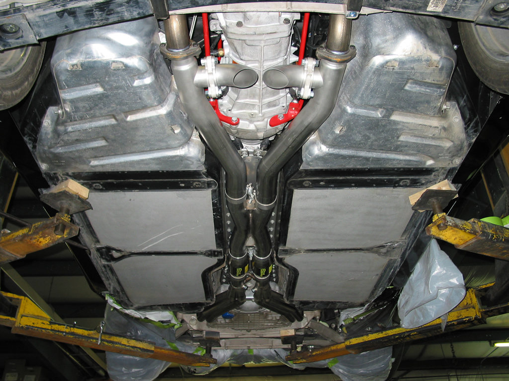

As wide as these cars are you won't have any problem at all reaching the jacking pads with an asymmetric lift. I'm looking at the asymmetric design myself. I have not lifted my car on a asymmetric lift yet but every standard twin post I have use the arms a almost too long. I normally have to put all the arms all the way in and roll the car forward and stick the front arms under, then roll the car backwards and stick the rear arm under, the center the car (front to rear) and then position the arms for lifting. I have run into the problem if your not exactly centered left to right your short side arms are too long. The best way I have found to lift mine is position the car a little back on the lift and put the front arm under the front cross member and the rear arms at the jacking pads. I normally just use short wood 2x4 blocks between the car and lift.
