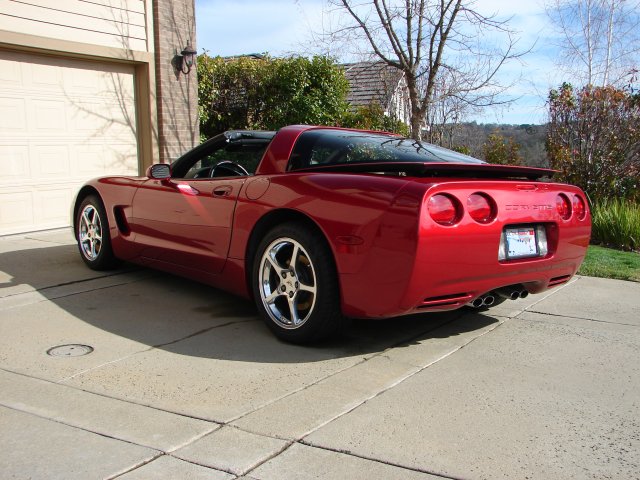

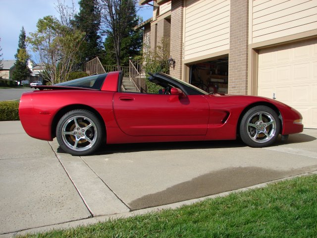

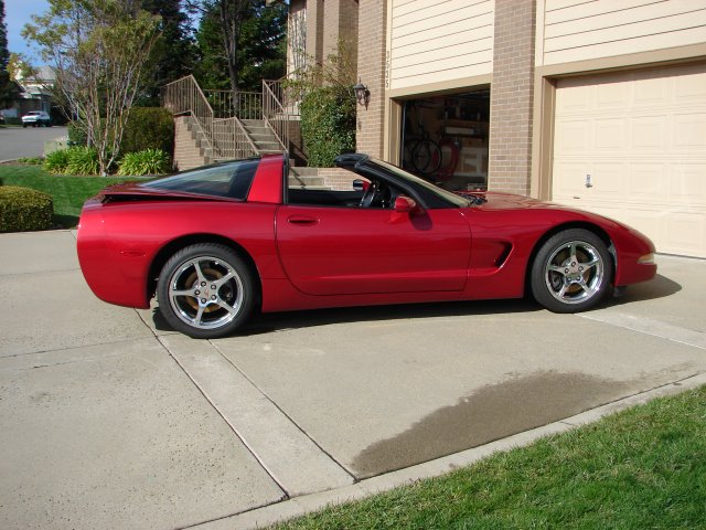

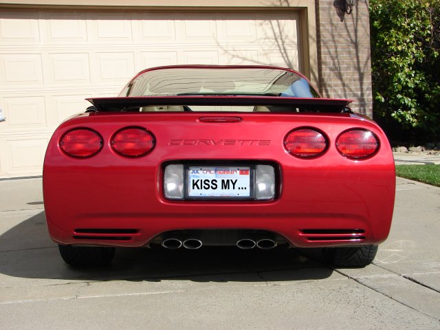

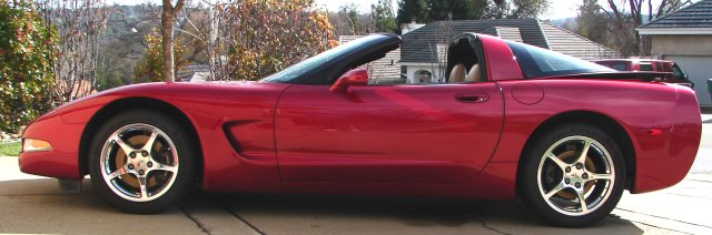

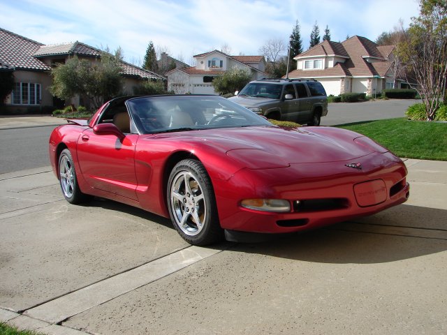

The whole purpose of having a targa top is so you can ride with the top off, right? Well, look at the design of the car. It's all wrong for a targa top. The windshield is LOWER than the roof. It's no wonder why it buffets. And, we all know that it's not practical to stop and put the top back on when you hit 40 mph.
I thought the same way you are thinking now. So, I went with the Windjammer. That thing sucked AND looked ugly. Made it worse in some respects. So, I called and spoke to the designer of the Ventmasters. He was so cool. He told me I could return them ANY time if I was not satisfied. That kind of confidence in a product is appreciated, even if it is your own product, you know what I mean?
And, it actually looks cool to have the hatch popped slightly. No one has told me my trunk's open, but people have asked if that's an option, like on 911s where the whale tail goes up and down.
Pics: (Link to Ventmaster below pics)
