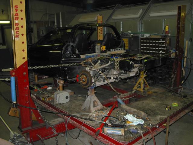

As you can see below I have done quite a bit of welding on a C5. I have had no problems welding on a C5. I have never unhooked the battery or any electronics. The main thing when welding is BE SURE your ground is attached to what your welding. Don't ground to the frame and weld on the exhaust. If your welding the exhaust be sure your grounded to the exhaust. A lot of times people will clamp on the ground and start welding all over the car on different parts which can cause problems. Also, the closer your ground is to where your welding the better.
But another word of caution that I learned the hard way! Be sure you only have 1 thing AC powered attached to the car at a time! Example, if your welding don't have something like a battery charger hooked up. If your soldering don't have a battery charger hooked up. You can create loops through your home electrical system and the car's electrical system. Trust me on this one, I know!
