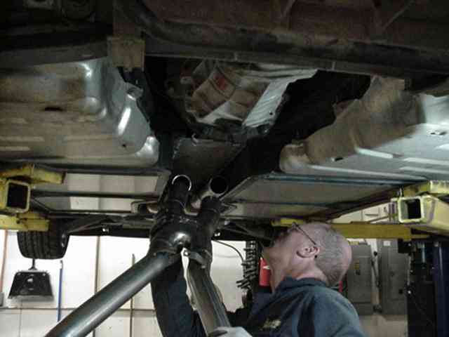

An x-pipe is not a direct bolt-on. You will need to mark the existing h-pipe and cut them off to correspond with the x-pipe you buy. The cuts are made behind the cats, so that is not an issue. (I had photos taken during the installation of my x-pipe, but I didn't think they were very good, so I deleted them - sorry)
