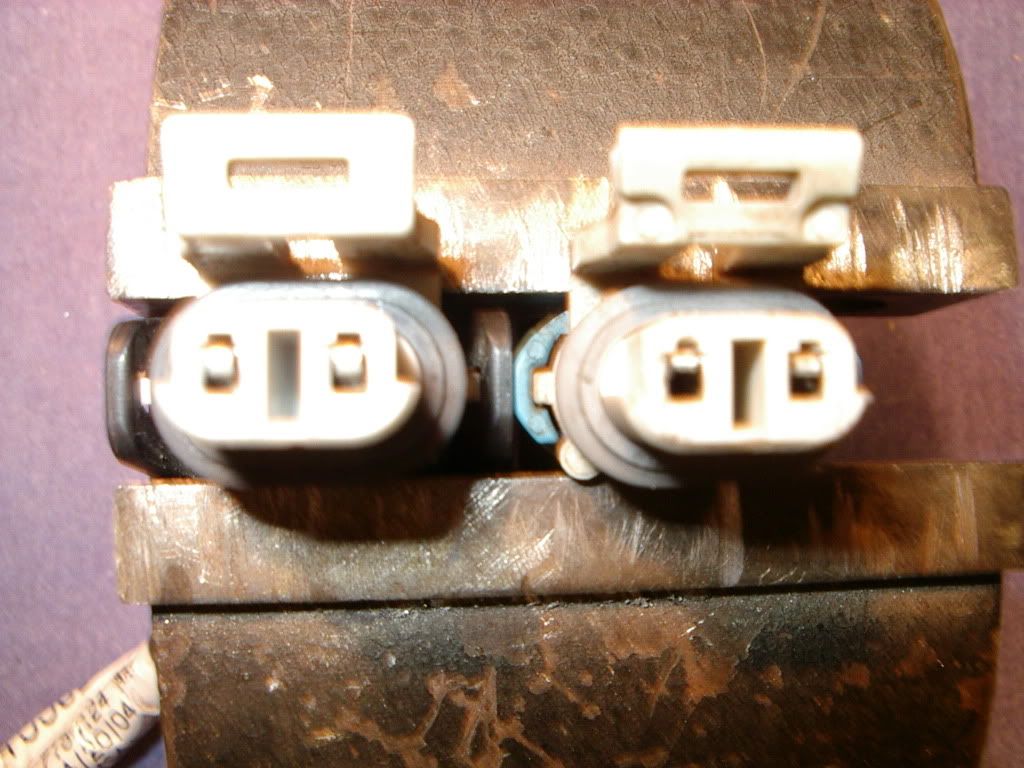

Check the female connectors at each end of the RF harness.
In the photo the left connector is new

Just had the same messages for the last 6 months. Usually when I hit a bump or spun the tires.
Pulled the codes, and got C1226.
Checked resistance and rotating AC output from the RF speed sensor. Checked o.k. per service manual.
I rebent the female contacts in the jumper harness at both ends, as others have done previously. Used a stiff sewing needle in a pair of Vice Grips as a tool to pick them out from the side, to ensure better contact when reassembled. Worked like a charm. Sprayed all connections with contact cleaner (even though they looked clean), and put it all back together. Car hasn't had a message for a week now.
I love free fixes...... dealer probably would have changed the hub.
Jay
