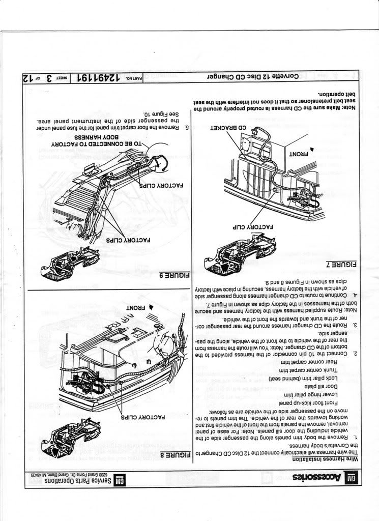

I have a couple of questions regarding this installation. Does the bracket in the trunk that mounts the changer go under the carpet or on top of the carpeting? The harness from the radio to the changer- does it run along the console or alongside the door sill? When it gets into the trunk area does it run along the floor or up high over the wheelwell? The installation kit I purchased has no pics or instructions. Thanks in advance to anyone that can answer my questions. I couldn't find any info in my shop manuals.

You need the kit from GM to mount the changer It has a bracket that is glued and pop riveted to the body under the carpet. The studs go thru the carpet and the changer is mounted to the ears and then to the studs.
The kit also has the cable that goes to the changer from under the pass floor carpet and cover. In the lower right there are a plug and a receptacle that the changer harness goes in to. The cable then runs along the pass side of the car under the carpet and side trim to the rear of the middle compartment where the changer is mounted.
Then just plug and play. You should see a little CD logo in the radio display if all is well.
These directions are in the kit from GM that has the cable and the brackets also.
Ask any of the parts suppliers on this site and they will be able to get the kit.

HI MATEY
THIS MAY BE THE PAPERWORK YOU NEED
SORRY MATE THERE UPSIDE DOWN, SAVE, FLIP, AND PRINT EM

Thanks for the info, I have the kit but it came with no instructions.
